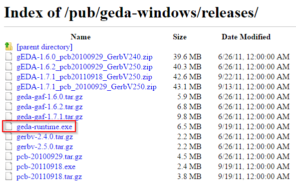

I downloaded the zip file, extract it and tried to follow the instructions per **broken link removed**
It says to un geda-runtime.exe but no such file to be seen.
...pff too late here to bother, tomorrow another try. But the file to be ran is not there.
That's a separate download on the main page:
ftp://ftp.delorie.com/pub/geda-windows/releases/
