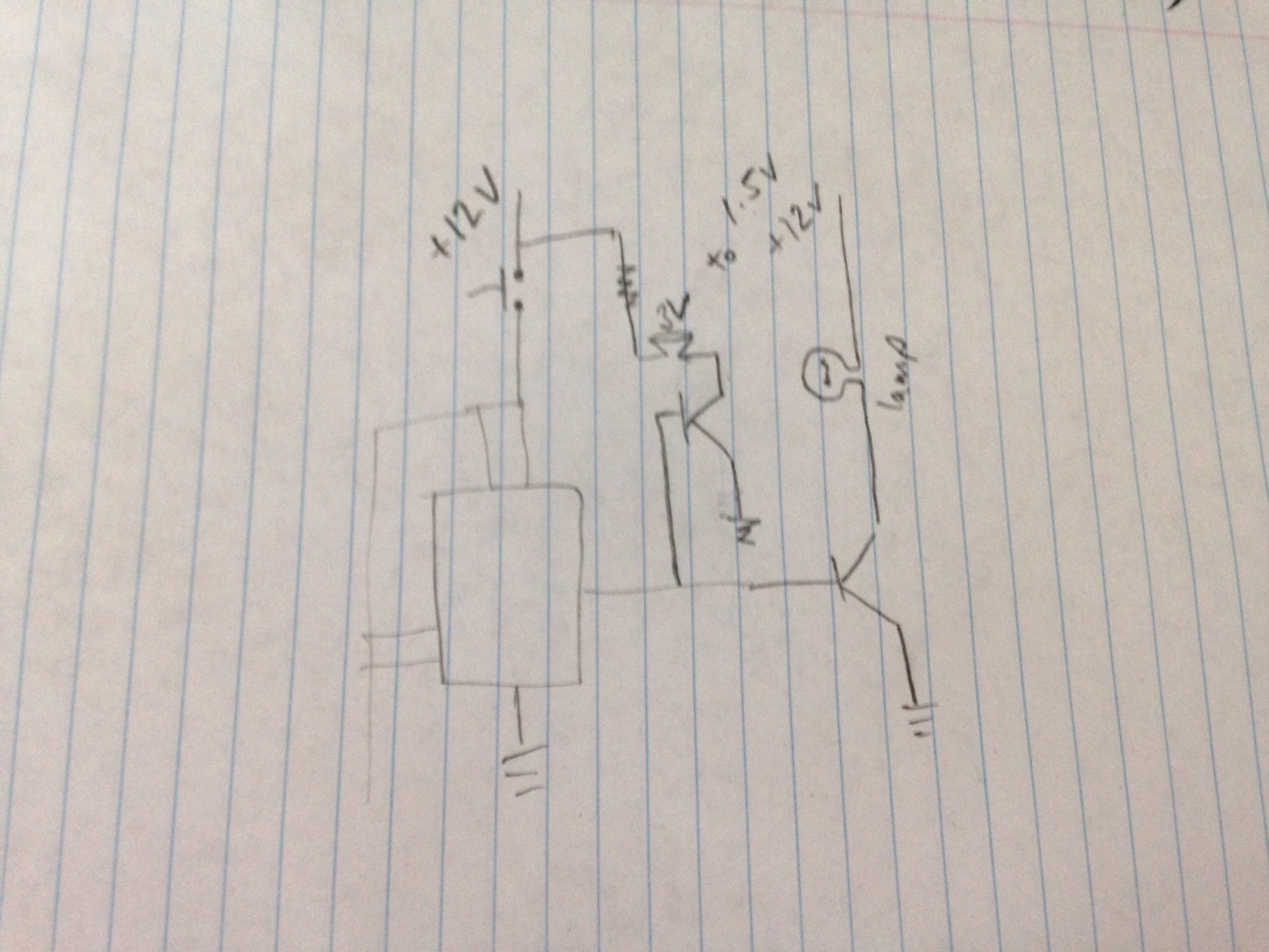

The signal comes from a 555 setup in astable mode, 1 sec on 1 sec off. The output I want it to connect to control 2 circuits. 1 will ground a +12v and the other will power with +12v.
I've tried 2 pnp and they heat up and bunch of bad things happen. I also saw that a pnp and an npn combo could switch the circuits in alternating mode, which would be fine, but I couldn't set it up either. Both transistors are partially on when the 555 is in low. This is an issue I don't know how to fix.
So my next thought would be to put a dpdt chip to control the 2 pnp transistors.
Is there a simpler method?
How much current do the two loads require?
One circuit is a ground for a light, basically a switch for the light to turn on by allowing it to ground.
The other is a simple buzzer being turned on.
The reason I need these 2 circuits is that the first could be different based on the application. Some lights would be LEDs while others would be bulbs from 1.5v to 12v.
The buzzer pulls far less than 1 amp while the light could be as big as 1 amp.

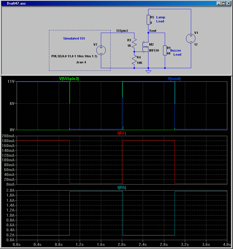

The 555 output pin 3 is capable of sourcing and sinking ~200mA. When sourcing a few ma, pin 3 pulls down to ~0V and pulls up to ~11.5V. I conclude no driver is needed for the buzzer, only for the lamp.
Here is how I would do it: Note that the lamp resistance is so low that the voltage drop across it when M2 is off means that the buzzer gets almost full voltage.
I plot the voltage at pin3, the voltage at V(Xout), the current through the buzzer, and through the lamp.

You might do well with two logic FETS with series resistors on the gates.

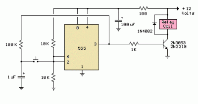

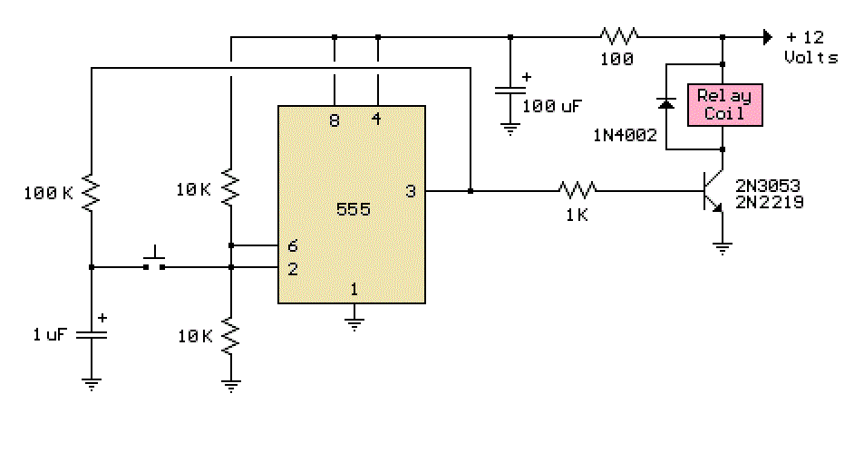

ou could just drive a relay and get up to 30 amps from the relay.
Here is a Toggle Circuit.
Here's a quick diagram. I left the transistors as either pnp or npn, or there can be 1 of each. It sums up the basic idea while being faulty.

Gee, I thought you mentioned FET's?
You MUST limit the base current. (Ib >= Ic(sat)/Hfe(sat.min)
Ib = Vin(base) =- Vbe
To put it differntly. Ic sat is the maximimum current that the collector can deliver. Hfe is the "current gain". At saturarion there is usually a different one. Grades of the transistrs have different ranges of Hfe. Thus, it has to work with the minimum value.
The minimun Vce or voltage between the emitter and collector also comes into play when driving a load. Using 0.6 to 0.7 is common.

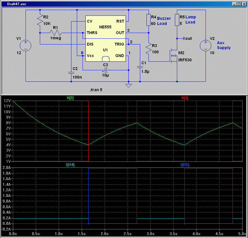

Try this:
Buzzer R4 is on for 1sec, followed by the lamp R5. V2 can be any voltage from ~2V to about 15V
The IRF640N works, but overkill. Just remember to put like 100 ohms in series with the gate. It's a "real-world" thing you have to do, 99% of the time, it might work without it.
