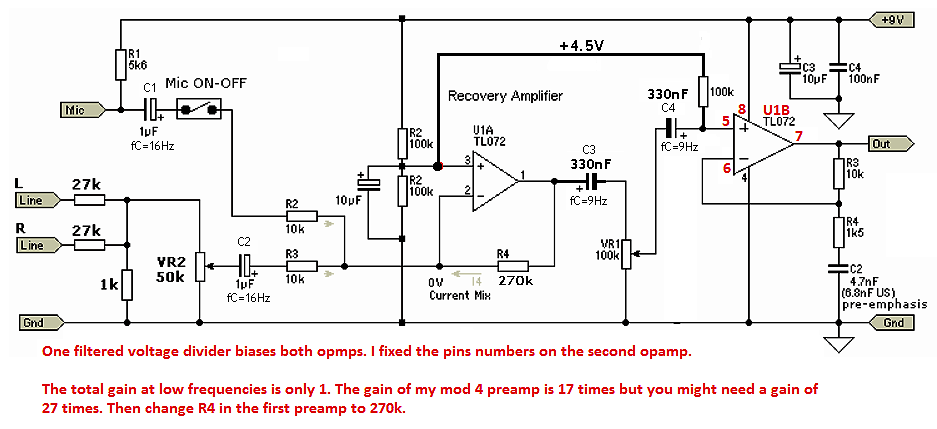

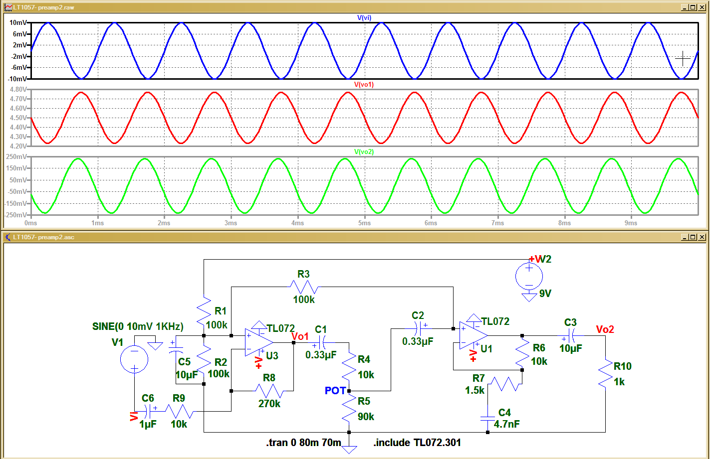

The circuit was fixed to mix Microphone plus music and amplified with 'pre-emphasis' for a FM transmitter project. Thank you for Audioguru a lot for the help. Here's a schematic attached based on TL072 OpAmp. Problem is my friend made the preamp he's not getting expected audio out. Then I did a simulation, but simulation is not working. Attention at my simulation because I used LT1057 OpAmp in the place of TL072 (I didn't find LTSpice model so). What would be the problem? If you have a model of TL072 then re-simulate please and give me the model of TL072 too.
EDIT: Post #2 has simulation file attached. (I cannot upload multiple files in a post- using Java Operamini)
Simulation file of the pre-amp (Hope you will use TL072 instead of LT1057):
  • LT1057- preamp.asc
Morning Willen,
Your OPA amps have their power rails crossed over,!!!

Good afternoon ericgibbs,
Hahaha sorry, I never hoped that I can be so much silly! :D
Thank you for the simulation model. I will be experimenting... Will be here again if got trouble.
One more thing, when I tried to download model, I got some lines of codes, like this-- http://ltwiki.org/images/f/f0/TL072.sub
I clicked in the link to get file but I saw lines of codes in the browser. How Can I use these codes or...?

You would move that linked TL072.sub into your LTSpice ' sub ' folder'
Then add the LTS directive .include TL072.sub to your circuit diagram.
[note I used the TL072.301 in my simulation, thats also a sub model ]
All models are text files.
E

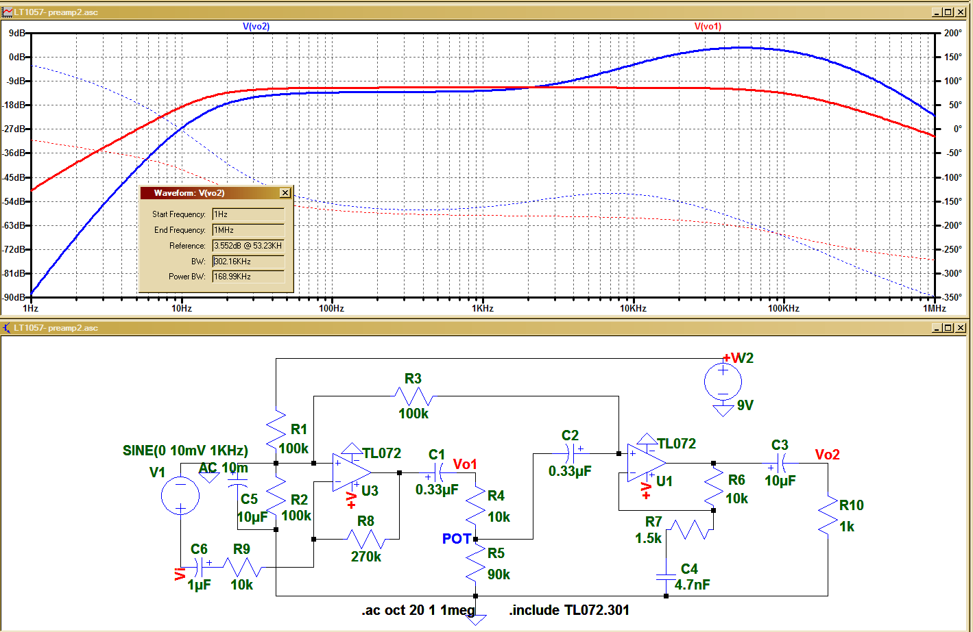

Added AC sweep image
I am being confused, I cannot get the TL072.sub file from the link I posted, I just get text instead in my browser (Operamini). Then do I need to copy the text and paste in notepad and save it with '.sub' file extension? And then....? Will you tell me step by step please?

I just can see 'DC transient analysis' and can understand. What is the information I need to understand from the AC sweep image?
Yes do that, save it in your LTSpice sub folder, then add .include TL072.sub to your circuit
[I have already posted a TL071.sub file in that zip], why not use that.?
For the TL071.301 add that to your sub folder and then add .include TL072.301 to your circuit
You cannot add the .include for BOTH the .301 and .sub,,, choose the one you prefer.
The AC sweep shows the frequency response curve of your amplifier, it is important to know the response and also the Bandwidth

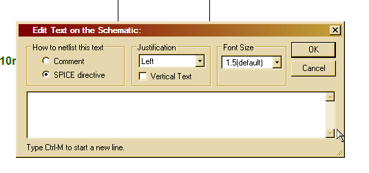

Sorry that I am not getting way to add .include TL072.sub in a circuit. How/where to write the function?
Just want to learn for other models. I have downloaded a HUGE pack of models (more than 10MB) and thousands of models are there. But I was not getting them working simply by pasting file in 'sub' and 'sym' folders in LTC. Feeling excited that learning about to add '.include' function, I will get thousands of these models are working!!
However, I am being failed to download your attached 'willen1.zip' file everytime, it's amazing. Everytime it says 'downloading failed', all other files here are being downloaded. As I said before I have TL072.301 file in the huge pack already, just remaining thing is to learn to add .include.
To display the edit text box, press s on your keyboard, you should see a window like the attached image.
Type in that window .include TL072.sub [ note that starts with a 'dot' ], make sure that the radio button Spice Directive' is ticked, then press OK button
if you want to use the TL072.301, type that in the text box instead of the TL072.sub.

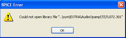

I did as you suggested. I placed a TL072.301 file to 'sub' folder and placed TL072_TI.asy file to 'sym' folder. Then wrote .include TL072.301 (or .inc TL072.301) and clicked on run the preamp of above. But got this notification, image attached.
You can see a location link in the attached image, amazingly it's showing a location where I have stored the huge pack of models. (I copied two files as I said and pasted to LTSpice program's 'Sub' (TL072.301) and 'Sym' (TL072_IT.asy) folders. )
Here are these two files attached, try it once in your system please. If you got failed too, then I have to say corrupted files. (I opened TL072.301 file with notepad, it shows fine codes I think.)
  • TL072.ZIP

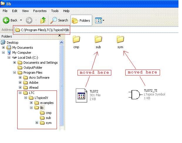

You have placed the .301 and sub files in the wrong folder, it is not sym folder but sub folder.
Also you are mixing
TL072.301 and TL072_TI.asy , you cannot do that, it will give an error message.
Look at this image from my LTSpice folder.
Can you post an image of your LTSpice folder tree.??

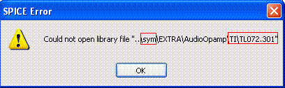

Just putting two files as shown in attached image, and adding '.include TL072.301' shows same error message as attached above (failed.GIF)
Eventually I corrected the problem like this way- The error message (failed.GIF attached above) is showing that the LTSpice cannot open library file in that location: ...sym/EXTRA/AudioOpamp/TI/
Here 'EXTRA' (and its other sub-folders) is my huge model package's folder name but first location folder name 'sym' is not my package name. It means LTSpice is searching 'EXTRA' folder and its sub-folders under 'sym' directory of LTSPICE. So I copied my 'EXTRA' folder (where thousands of models are there) and pasted it inside the 'sym' folder of LTSpice.
Then I saw EXTRA directory in the Add symbol box (from where we add NPN, PNP, MOSFETS, ICs, voltage) and inside the 'EXTRA' directory I also saw these thousands of models! Wow problem solved! :) I don't know which thing force to LTSpice to search predetermined EXTRA folder under its 'sym' directory.

You made an AC analysis, I also made an AC analysis following your commands. I used LM324 OpAmp instead of TL072 because LM324 is said that the OpAmp is very slow! So I tried its performance from 1Hz to 1Meg. I got two lines on graph (one dotted and one clear) but cannot understand what are they, and what are they showing. I can make concept of graph found in datasheet but this graph is little different. I have attached file LM324- audio preamp.
  • LM324- preamp.asc
