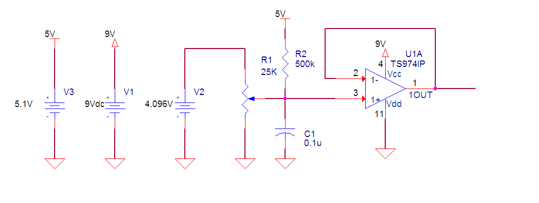

I'm using a TS974 quad op amp wired as a voltage follower to buffer a pot for an ADC. Vcc is connected to 9V and Vdd to 0V. When the voltage at the non-inverting terminal gets to about .7V above Vdd, the output voltage goes to Vcc. I've tested 3 chips in and out of circuit and with dual supplies at ±2.5V and get the same results.
Has anyone seen an op amp behave like this before? Am I damaging the chips some how or am I just missing something?

This is a simple voltage follower. When the pot voltage falls below about 0.7V the output jumps to 9V. When the pot voltage is above about 0.7V, the output = the pot voltage. It does violate the differential input voltage when the output jumps to 9V, but I don't see why it jumps.
I've tried this circuit with an LM358 on a breadboard and it acts as expected, Vout follows Vpot to the lower limit of the op amp, around 0.3V. I've also tested a new TS974 with a variable power supply and Vout jumps as Vin gets to 0.7V.
The obvious answer is to use a couple LM358s, but I've never seen an op amp act like this and I would like to know why it's happening.

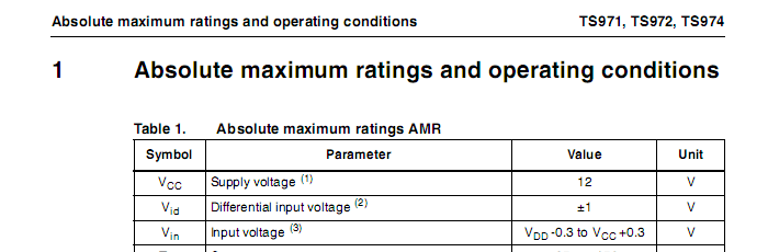

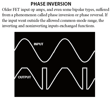

You are exceeding the allowed input common-mode voltage range.
The inputs don't work anymore and the output might go high when the input common-mode voltage range is exceeded. It was a common problem with older Fet-input opamps like the TL08x.
The only spec's in the datasheet are when the supply is plus and minus 2.5V. The allowed input common mode voltage range is from -1.35V to +1.35V. So the inputs must be (2.5V - 1.35V)= 1.15V above the negative supply which is ground in your circuit.
Interesting...
I think that is what Eric telling me. I just took another look at page and it explains exactly what I was seeing.

To avoid any misunderstanding it would be helpful to post a sketch showing how you are connecting the opa.
From your original description you say...
This suggest you are exceeding the OPA input range.??? its not clear how you have it connected.
IF VDD is = 0V and the he writes the non-inverting terminal gets to about .7V above VDD (what is the problem with that statement)...he is saying that the follower shots to VCC when the non-inverting input gets to .7V above GROUND..

I think audioguru is correct. Because of the common mode input voltage, the inputs must be within 1.15V of the rails.
I found this on allaboutcircuits.com:
One quirk of some op-amp models is that of output latch-up, usually caused by the common-mode input voltage exceeding allowable limits. If the common-mode voltage falls outside of the manufacturer's specified limits, the output may suddenly "latch" in the high mode (saturate at full output voltage). In JFET-input operational amplifiers, latch-up may occur if the common-mode input voltage approaches too closely to the negative power supply rail voltage. On the TL082 op-amp, for example, this occurs when the common-mode input voltage comes within about 0.7 volts of the negative power supply rail voltage. Such a situation may easily occur in a single-supply circuit, where the negative power supply rail is ground (0 volts), and the input signal is free to swing to 0 volts.
The LM358 has a range of 0V - Vcc-1.15, which explains why it works in this circuit and the TS974 doesn't.

No,the 0.7V input (above the negative supply which is 0V in this circuit) is not within the common-mode input voltage range.
The allowed input common-mode voltage range is 1.15V above the negative supply and higher.
