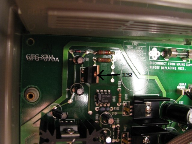

Also, i measured voltages from PSU section, (safe-side btw ''isolated'') and there was one thing that caught my eye. There is this transistor, tip32, which takes care of negative voltage regulation -5v. Its base voltage on faulty one is positive, but shouldn't it be negative as it is PNP transistor? I checked it on datasheet, and indeed it needs negative voltage.

Here's the section of psu with fishy transistor.

Ok, small update, the psu delivers +/-15v and +/-5v, those i confirmed from working on, reference point was chassis, from bnc connectors. At faulty, voltages were fine, excepct that -5v rail, which was +1.68v.
Seems there is something wrong at -5v regulator, which is that shown in photo.
looking at the photo I agree the base ought to be - on the tip 32, it looks like a fairly simple regulator with a zener/cap/resistor.
Measure the voltage on the zener, ought to be around 5.6v, might be worth taking the tip32 out if it measures wrong, also make sure there is actually a - unregulated bus voltage, there probably is if -12v is working.
If the vf input resistor is blackened then theres a good possibility that the waveform generator chip is faulty, or if it goes to an op amp first maybe thats toast.

if i recall right, zener voltage was not even near 5.6. it was that in working one, but in that what is broken, zener voltage was around 0.8v. but i'll check it again with tip32 taken out. All other voltage rails +/-15, -12, and +5v were okay. And, as for opamp, voltages were same as working unit.

took out the tip32c, and zener voltage was 5.6. This is getting strange :S tip32 seems okay, tested it with dmm now when it was out circuit
what could cause tip32's base voltage change to positive? seems strange to me...
Replace the tip 32, sounds dead to me, every so often you get one that checks ok but dunt work.
Double check while the tip is out that the collector has more than (or less than) -5v on it so the tranny can actually regulate.
With the tip out the emmitter connection probably will be +, comming from the + rail, if for some reason the tip is open/short or has a dry joint that makes sense, the + rail might be conducting through to the zener which would read forward bias volts around 0.7v.
Was the solder on the tip original?, if not maybe a 'rig doctor' pulled it out and put it back the wrong way.
thanks for reply, never thought that transistor can be faulty even if it reads ok. these voltages were when tip32 was out:
base -5.6
collector: -27.6
emitter: +4.6
i used bnc gnd as reference point, if that helps anyway
as for the soldering on tip32, it seems original, as its aligned same way, same pins at same places as working one.
changed the tip32, didn't have that exactly, but tip42, seems equilavent? nevertheless, same situation as before. i did notice that lower capacitor, which is connected to tip32's emitter, is reverse biased when tip32 is out of circuit. does this mean anything? it was around -5v
I'd expect those readings, your measuring power from the + rail which bleeds though without the transistor in place.
I think a tip 42 is similar but lower gain.
It sounds like theres a short on the - rail somewhere else within the gen, maybe the original cause of the supply fault.

oh, forgot to meantion early one thing. there are couple things getting warmer. Those resistors right above tip32, get really hot, much hotter than in working one. And, one ic, (i take a photo of it) sadly, there are no socket for ic's in this model at all. But, i noticed now when i touched those parts which were more or less warmer than should be, they stay cold, but when tip32 is in place, things get warm. And just for safety purposes, i run this by isolation transformer.
