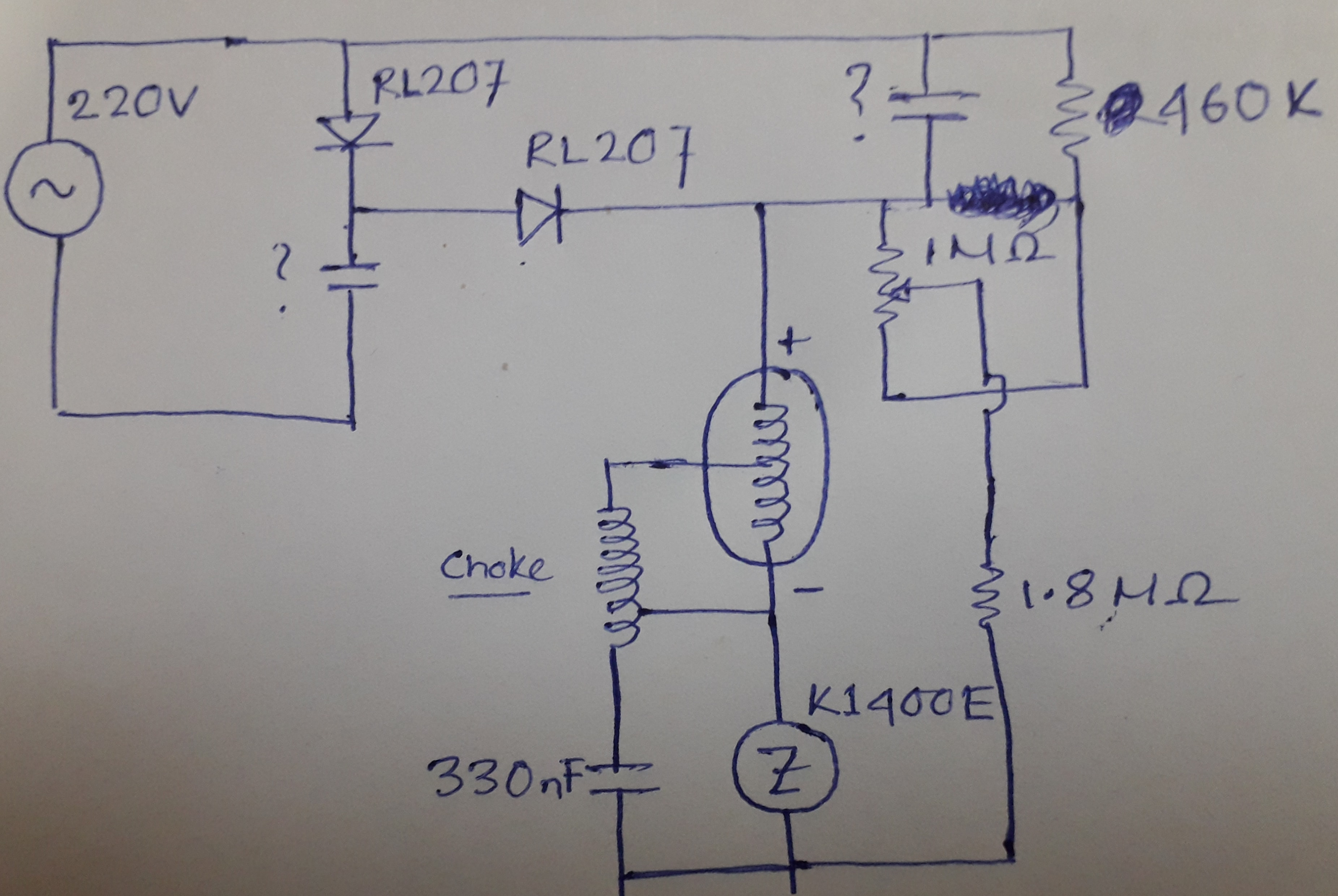

I am interested to electric bulb driver used in street lighting or any suitable area.
Need to know how this circuit can work.
Take a look the circuit in first attachment.

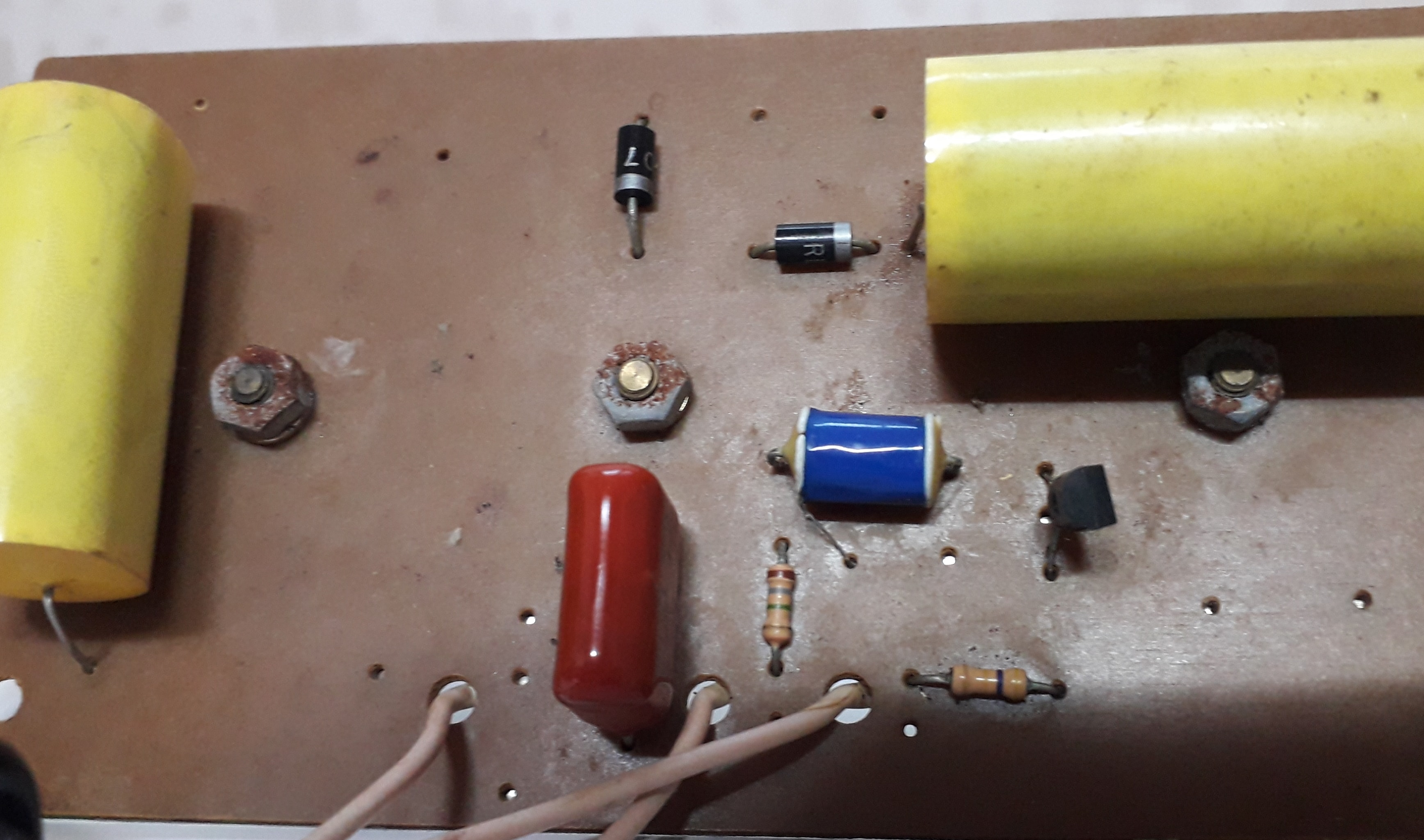

1. 220 V ac has feed to 2 diode that could pick positive half cycle.
2. On the junction point what the yellow componet does, is it a capacitor ? Using for discharging ?
3. Whats the choke is doing here, looks it comes from bulb surface.
4. Capacitor 330nF and SCR K1400E is triggering the negative part of this bulb?
5. Does 460k, 1M ohm POT and 1.8 Mohm resistor parallel to bulb is maintaning current or voltage.
6. Not sure other yellow component is doing here?
Lets discuss together to learn more for further development.

I'm pretty sure thats not a street light.
Its a disco strobe with a xenon tube.
The diodes recitify the incomming supply, the yellow cap holds the charge for the next flash, the 'choke' is a trigger transformer it generates about 6kv to trigger the strobe tube, the final cap you mention holds the charge to trigger the tube, the pot sets the flash speed, and the last cap probably used as part of the oscillator that triggers the tube.
The transistor looking device is most likely a thyristor.
Does it means at positive half cycle the 2 diodes conducts well, but in the next negative cycle the input yellow CAP helps to discharges ?
Interesting to see this point, how this choke can trigger like a transformer ?
How this kind of high voltage can generate on this system? High voltage pulse?
The final cap is 330nF ? It also saves the thyristor ?
The oscillation might generates from LC action. Do you have any idea of this 2 CAPS? what should be their values.

Anyway the thing you keep calling a choke is actually a transformer made for triggering the xenon strobe lamp.

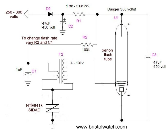

I saw how people made it before, capacitor must be charging through a resistor and discharging through triggering transformer. Take a look
