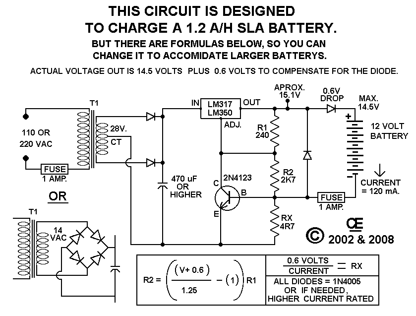

Here is a Schematic for a charger. It also includes a Diode to Prevent Reverse Battery Discharge.
And Formulas to calculate the Output Current and Voltage.
this is what ive been looking for but im going to change it up a bit to charge single cell 2vdc lead acid deep cycle cells or make it an adjustable voltage charger...thanks for posting...
I am going to make a bench power supply so that current is not fixed.
Then you might want to start a thread about building a bench supply. Start with what voltage and current it has to provide, how many outputs, etc. And BTW: using chips like LM317 is a poor way to build a bench supply. It is not that difficult to build one with adjustable voltage and current using cheap op-amps and transistors.

Why do you think it's a poor way? :confused:
Certainly building one with op amps and transistors is significantly more complicated.
An LM317 regulator is cheap, has a built-in reference, current limit, and over-temperature limit -- it's near bullet proof.
The only limitation is that it won't go below 1.2V but not many applications require a voltage below that level.
Crutschow, I Agree and if all you need is a Simple Battery Charger, Why get complicated.

1) The LM317 won't adjust down to zero V.
2) It doesn't have easily adjustable current limiting.
It's just a really crappy way to go. For the time it takes to build it, I would do a better design.
