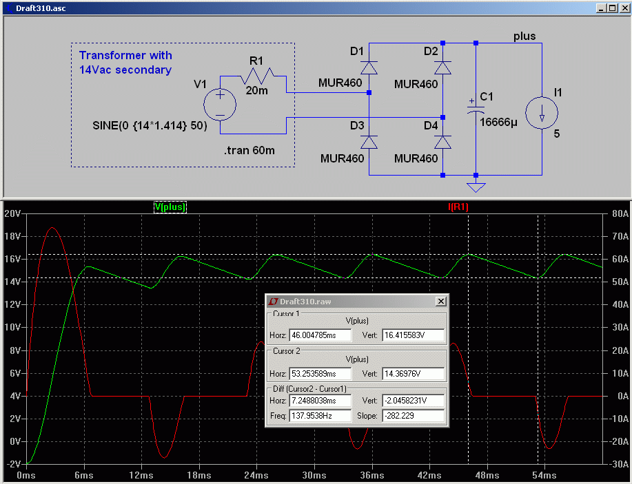

If V1 and C3 in that circuit represent a transformer, rectifier, and filter capacitor, then C3 is much, much to0 small to be a proper filter capacitor. Hence the regulator drops out because its input voltage sags below its Drop-Out Voltage (See Vdo on the data sheet).
To figure the correct value for the filter capacitor, do this simple calculation: (You have to make certain assumptions):
Assume a load current for your power supply is I=5A
Assume that the voltage in C3 can drop 3V (peak to peak Ripple) between current pulses from the rectifier so Δ=3V.
Assume you are using 50Hz AC and full-wave rectification, so time between pulses is t=10ms
∫I*t = q = C*Δ
So: C3=∫I*t/Δ = 5*0.01/3 = 0.017F = 16,667uF
So here is a sim to confirm the above. Pay attention to the peak currents required of the simulated transformer and rectifiers. The ripple in the sim is ~2V (not 3 as assumed) because the time that the filter capacitor has to supply the entire 5A load current is only ~7ms (not 10ms, as assumed) so the calculation yields a filter capacitor value which is a bit bigger than necessary.

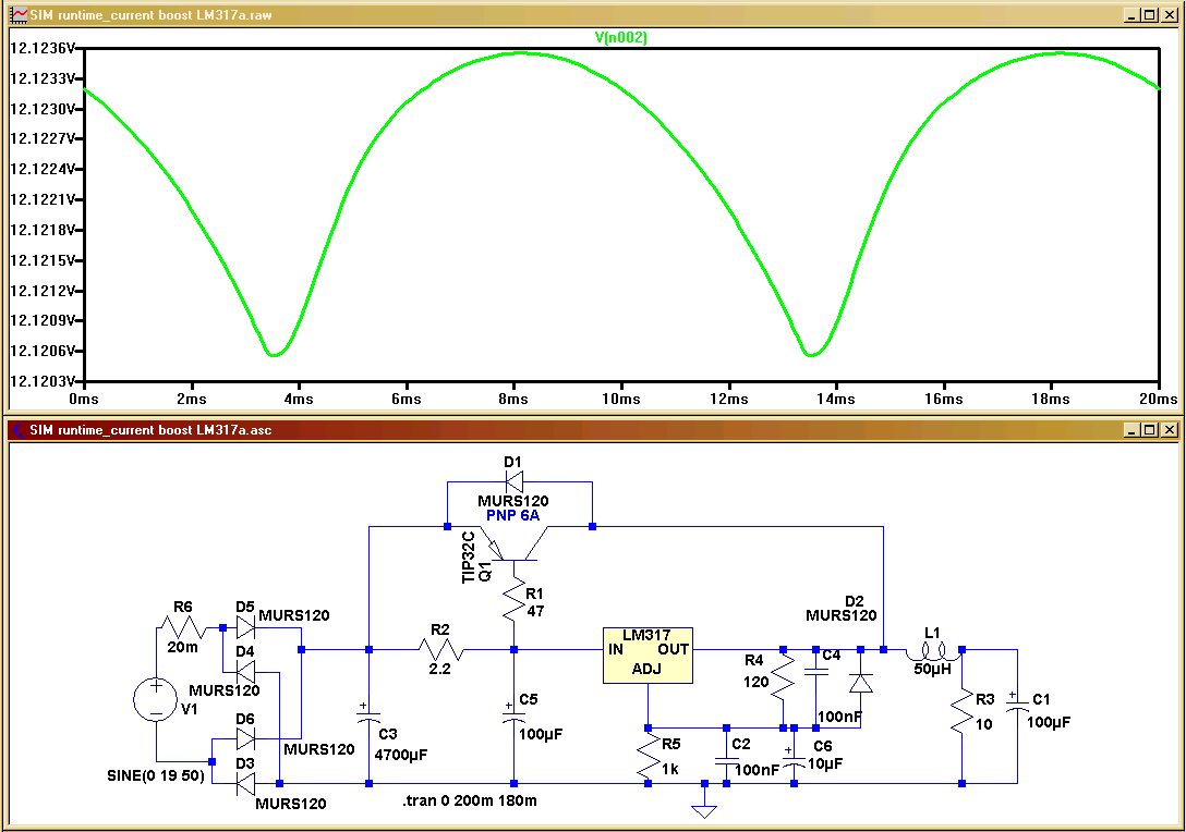

I had seen some capacitor multiplier circuits where the base was regulated by zener and was used just 10uF capacitor and the transistor were passing supply from Collector to Emitter, smooth regulated output (same as with 4600uF). So it was called capacitor multiplier.
Same way cannot I use a small value capacitor in the ADJ pin or on its divider point to get more smooth supply with small filtering capacitor?
Another: I downloaded a LM317-TI model and simulated; but got heavy ripple output. Run this simulation (attached) and what is the wrong? (wrong model of wrong circuit?) maybe you have different model of LM317, no matter anyway.

Please run the file 'SIM_current boost LM317.asc' (Attached above in). I am getting few hundreds ripple at output and it's amazing to me.
It is oscillating. You have too many, and the wrong value bypass capacitors. I went back an looked up the current-booster recommended by National (ne TI) on the TI LM317 data sheet. They use nothing on the input pin, 10uF on the adjust pin, and nothing to 1uF on the output pin. That stops the oscillation.

Here I simulated again using some tricks found on TI datasheet (example circuits). I got oscillation of different KHz (10KHz to 35KHz). Then I used an inductor at output then got solve.
Can anyone tell me why some simulation runs within a second and some simulation takes almost a minute for same circuit and same stop time? Please check this circuit without and with L1. Without L1, it took me approx 20 seconds to complete the simulation. And with, L1 it took just a second! AMAZING! why?

hi Willen,
Ref your PM.
I had to use my LM317 and TIP32 models for your circuit, it runs equally fast with L1 in or out.
Where did you get the LM and TIP models from.?
Eric
Eric
I had downloaded a huge pack of zip file (approx 1.5MB) somewhere around internet. After extract, it become approx 15MB.
Equal fast, how long? My PC took more than 20 seconds when used the inductor. And took just a second when I connected directly (without the inductor).

I do not have a model of an LM317 so I could not run the sim. I think the circuit is oscillating because it cannot drive the HUGE 1000uF output capacitor. The datasheet for the LM317 does not show the circuit with the PNP current-booster circuit but shows a similar circuit with a 47uF solid tantalum output capacitor. Fairchild's datasheet for the LM7805 shows the PNP booster with a 0.1uF probably ceramic output capacitor.
I do not have a model of an LM317 so I could not run the sim. The sim has a DC input so it could not be mains ripple but must be oscillation. Maybe because it cannot drive the HUGE 1000uF output capacitor.
The similar current-boosting circuit in the latest LM317 datasheet shows a 47uF solid tantalum output capacitor and Fairchild's LM7805 datasheet with the PNP current-boosting transistor shows a 0.1uF output capacitor.
Its less than 2 seconds for both simulations.
