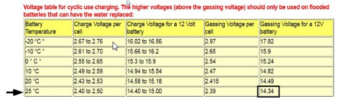

BTW: do you have a voltmeter? Put it on the battery terminals in your car and rev the engine. You will see it read 14V give or take tolerance. 14V is used in cars to replenish charge faster, long term charge should be as stated (13.4V).
You can see from the attached document that at 14.34V (room temp) a lead acid battery starts outgassing which will ruin any sealed battery and dry out any water filled battery.

Hello again,
Well i am not sure what kind of battery that chart is for, or where it came from.
I ran my older car for years with the alternator charging at 14.2 volts.
The other cars i measured first hand were (1) a 2002 Chevy, and (2) a 2000 Ford Mustang. They were both 14.5v charging.
My current car however measures 14.0v or pretty close.
So you see there is some variation and it doesnt matter what the battery manufacturer says it matters what works in real life. If yours worked in real life then you were lucky to get the right battery. I have also read that changes in battery chemistry caused some manufacturers to raise their charge voltage but others refused to do so. So there must be some disagreement in the industry. Also keep in mind that battery manufacturers want to constantly sell batteries.
I cant help it if you dont agree with what is happening in the real world, i can only present the facts as i have observed them first hand. There could be unknown differences that we dont know about yet.

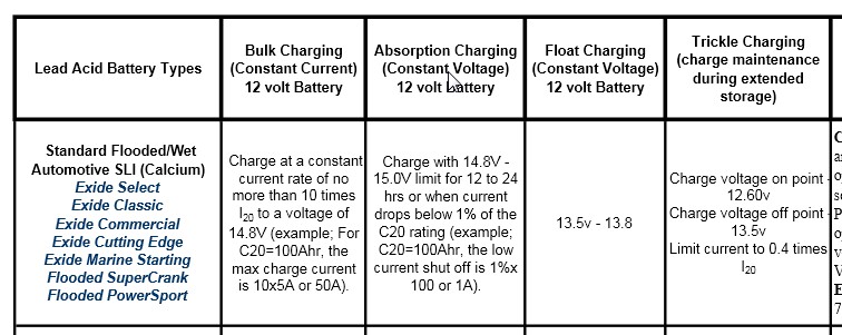

The charging information I posted are for new AGM lead acid batteries.
Here is the data for recommended continuous charging voltage from Exide who is probably the largest maker of car batteries in the USA. Note that this data is for calcium type.
This shows exactly why I said that for continuous charging, the set voltage should be 14V or less. The spec listed below is 13.5 - 13.8V. See the attached image, fourth and fifth columns. The only charge modes that use a higher set voltage are current limited/timed for short duration which means they do not apply to automotive use or continuous charging such as the OP of this thread was asking about.
Like I said: I go with the battery maker's data. You do what you want. If you think the maker publishes incorrect data, you can ignore it.

Hi again,
Thanks for the chart. I think this is starting to make some sense now.
If we intend to charge for long periods, 14 volts is probably better than say 14. 5 volts. If we intend to charge for a shorter time period, then 14.5 volts would be better than 14 volts.
