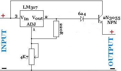

Not being able to understand simple LM317 lead acid battery charger

Why the Additional Transistor?
How Much Current do you need.

I do not have oscilloscope (to see ripple after the build), I have a linear transformer as power source and I do not want to oscillation ripple output. So that I want to conform from simulation.
I am going to make a bench power supply so that current is not fixed.

You wont be able to use the 6A capacity even if the hFE was 100
The LDO resembles an ideal zener with <<1 Ohm=Rs so I used a 12V zener in this sim.
Raising the R1 reduces the power dissipation in all parts except the PNP as it raises only current 10% with a small Rb and much bigger I sense (R1)

It's a bad design for high current. It isn't really a low dropout as the LDO suggests and is still very high ESR so load regulation error will occur.
As others have already reported, the Cap must be huge for high current using 50Hz. Try 50kHz (hint)
As I have stated in other questions, I choose RC1 = 9τ for τ=10ms or 100Hz with FW rectified 50Hz @ 10% ripple. ( it may be closer to 8τ, but close enough and give margin for aging)
C1 must also be low ESR type. $25
With R (load)=5 Ω then C1 = 9*10ms/5Ω= 18mF
Bottom Line, Learn how to use an LDO as a Buck switching regulator (consult datasheet) better yet use a low Vth, very low RdsOn MOSFET bypass or better yet use a real Buck regulator chip. with good filtering.
The RdsOn of the bypass Pch MOSFET ought to be ~1% of the lowest load resistance at any desired low voltage.

Hi chemelec,
Thank you for the clarify. Sorry for the little abnormal part like LM723 or Buck converter as Tony said, I am living in such place where electronics is just trying to sprout. Till now I just saw TL431, 78XX and LM317 as regulator.
I am trying to utilize a transformer scrapped from old Black & White TV (used for 24V DC, 2A out?).
With 24 Volts @ 2 Amps Out from the transformer, you will Only get a regulated Supply Output of Just ONE AMP.
So there is no point to building that 6 amp regulator.

Or just use the LM317 Without the added Transistor.

My intention to use the additional Q1 is to divide down the heat and power dissipation.
Q1 is NOT Required.
Even if you used Q1, it would require a Heat Sink on it.
So Just put a HEAT SINK on the LM317 and it will work good.
ALL Power Transistors and Most Voltage Regulators REQUIRE HEATSINKS to Help in Removing HEAT.
That is why the LM317 has a Hole to Bolt on a Heat Sink.

It Sounds VERY efficient transformer of current capability. Currently I just have a 220V to 19V (AC) transformer, made for 24V Black and White TV. I need simple adjustable bench power supply so the transformer maybe suitable for now.
Ok, I guess you're running at 50Hz if it's a 220VAC xformer. Is it centre tapped on the secondary or primary?
What is your required output voltage range?
What is the max current required? As chemelec noted, you don't need hi current pass transistors IF your xformer can't supply the current.
I am a basic hobbyist for electronics so I experiment small circuits basically. I am wishing to get 20V max and around 1A or little more. (I tried to add a booster transistor so that if I got a bigger load later, so I do not need build another circuit again).
Xformer is simple two input (220V) and two output.

The thing about a pass transistor is that it requires a base emitter dropping resistor to 'drive' it. This costs you current flow if the resistor isn't sized properly ( if the pass transistor isn't activated) and potentially causes MORE ripple due to voltage drop on the LM317 input.
Have a look at the 2nd 'hi current' option here:
http://www.reuk.co.uk/LM317-High-Current-Voltage-Regulator.htm
This takes a better approach, unloading the LM317 and loading as many pass transistors as you'd need. You can even add more later. If you're going for more than one pass transistor (for even higher current later on) it is imperative to keep them thermally linked on the same heatsink.
