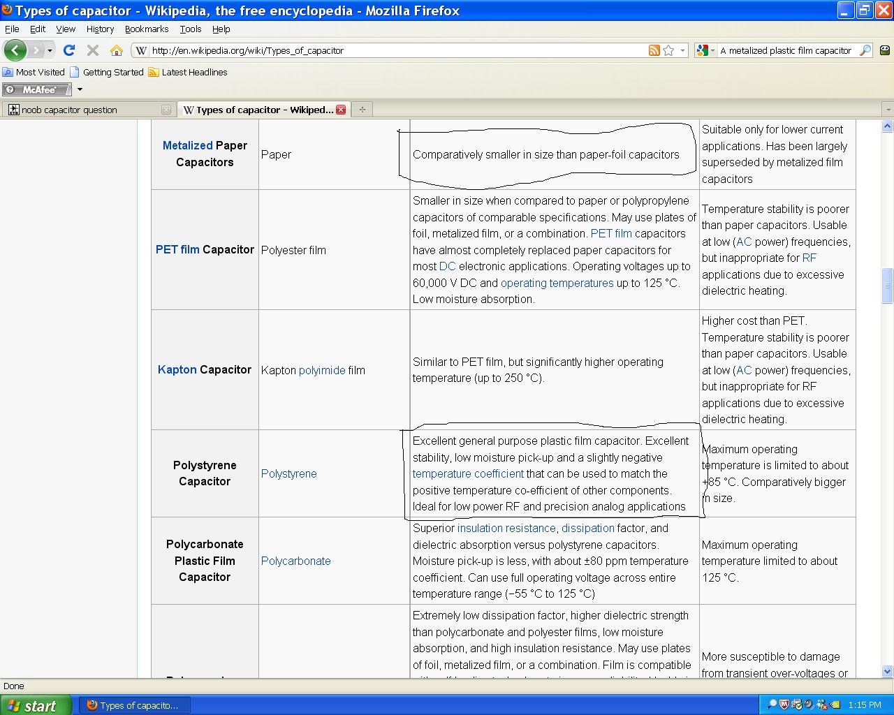

But which ones are we talking about.
Almost all audio coupling capacitors are PET metalized polyester film type.
I haven't seen paper or polystyrene capacitors for about 35 years.
