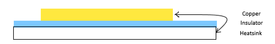

We have an 230VAC offline, non-isolated LED driver with a 300V LED bank.
The LEDs are on MCPCB, which is screwed down to an earthed heatsink.
Can you confirm that this is illegal?, since if the earth wire that connects to the heatsink was (for whatever reason) not secured, then the heatsink would be insufficiently insulated from live mains.

…it states that there should be 2mm of clearance from an MCPCB copper trace and the board edge.
…The thing is, if the MCPCB is screwed directly to an earthed heatsink, then the MCPCB copper traces may just as well be right at the board edge, because wherever the PCB traces are, they are effectively only a few microns away from the earthed heatsink? (a few microns being the thickness of the dielectric insultion layer on the MCPCB).
Also, i dont think a few microns of MCPCB insulation is classed as being sufficient insulation from the mains?

Thanks, sorry but i dont see it..a copper trace on an MCPCB is electrically separated from any point on or in the MCPCB by just a few microns, (the thickness of the insulation covering the MCPCB.)....so whats the point in the 2mm clearance?....the whole MCPCB is electrically conductive....whether a track is right next to the edge of the MCPCB , or 5mm away from the edge, it is effectively right at the edge.....because the entire MCPCB is made of conductive material (apart from the thin bit of insulation).

Not so. If the trace is spaced away from the edge then the path for arc-over includes the exposed surface (possibly-contaminated) of the insulator plus the insulation thickness, all in parallel with an air-space of unknown conductivity. That path is significantly longer than the insulator thickness alone. It is the air-space which is most likely to break down.
Thanks, what if the track is covered in solder resist? Surely solder resist has just as much insulation resistance as the dielectric insulator on top of the aluminium of the IMS board?.....so surely solder resist covered tracks can go right to the edge of the IMS board?...(or at least to within 1mm)
It is the air-space which is the likely breakdown path, so covering the trace with solder resist should help. I don't know whether alumina (or whatever insulator is used) or solder resist has the greater insulation resistance, but my money would be on alumina.
