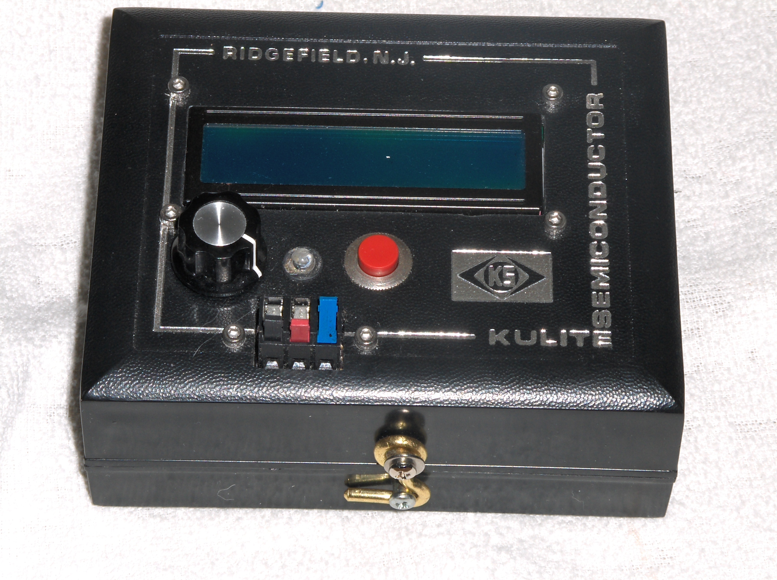

My iteration of the tester, in a box when semiconductors came nicely packaged.
