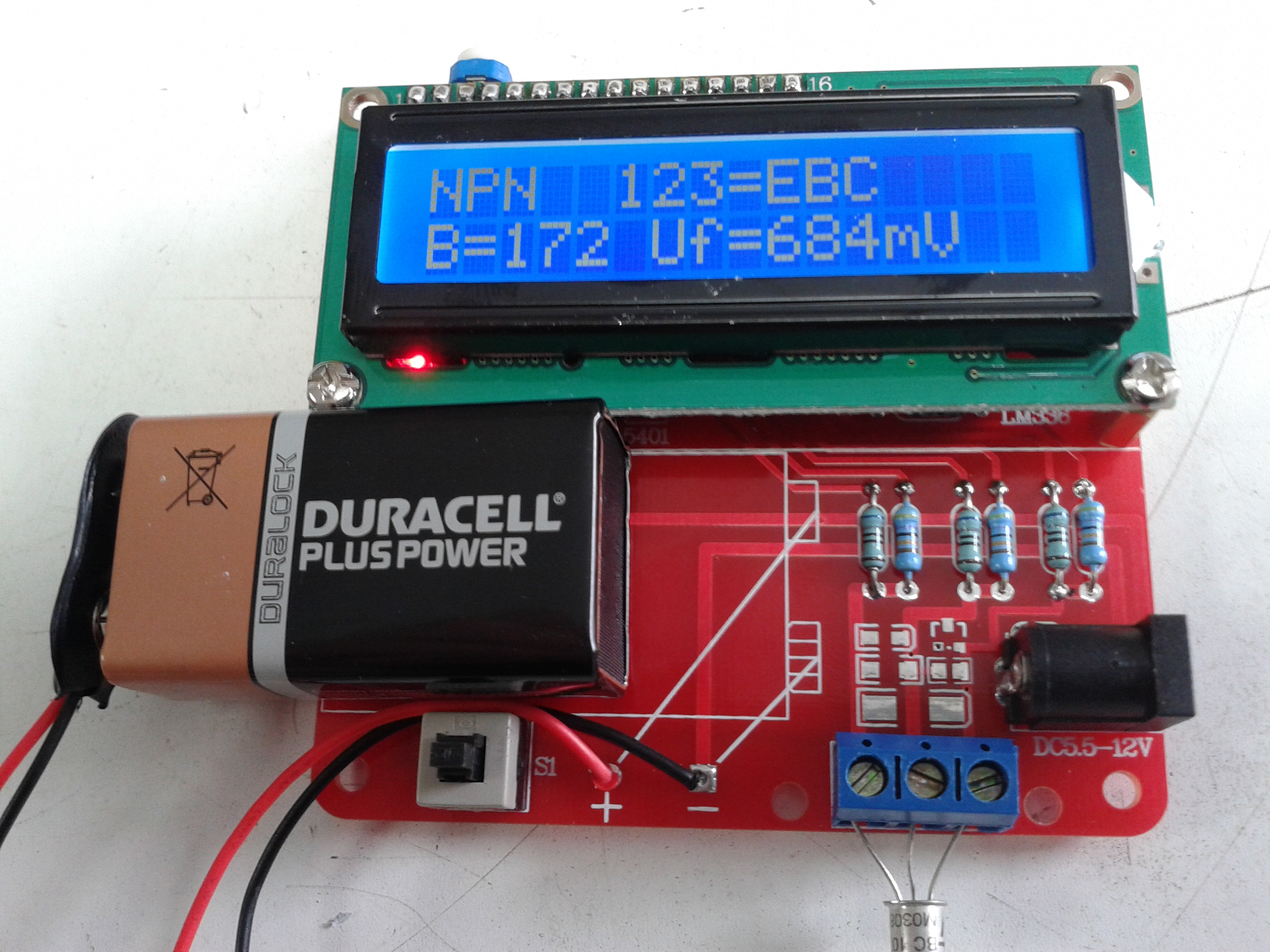

Someone brought this kit to my attention a couple of weeks ago, so I ordered one (as it's was crazily cheap - £7.45 :D)
https://www.banggood.com/DIY-Meter-...ntent=vera&emst=2NKh40Be80_237878_1013964_129
It came this morning, so I've put it together and it works great - it uses an ATMega, and not a great deal else really - the test transistor in the picture is a BC107. All the details are in the web link above, scroll down to the reviews for a link to the instructions and circuit.

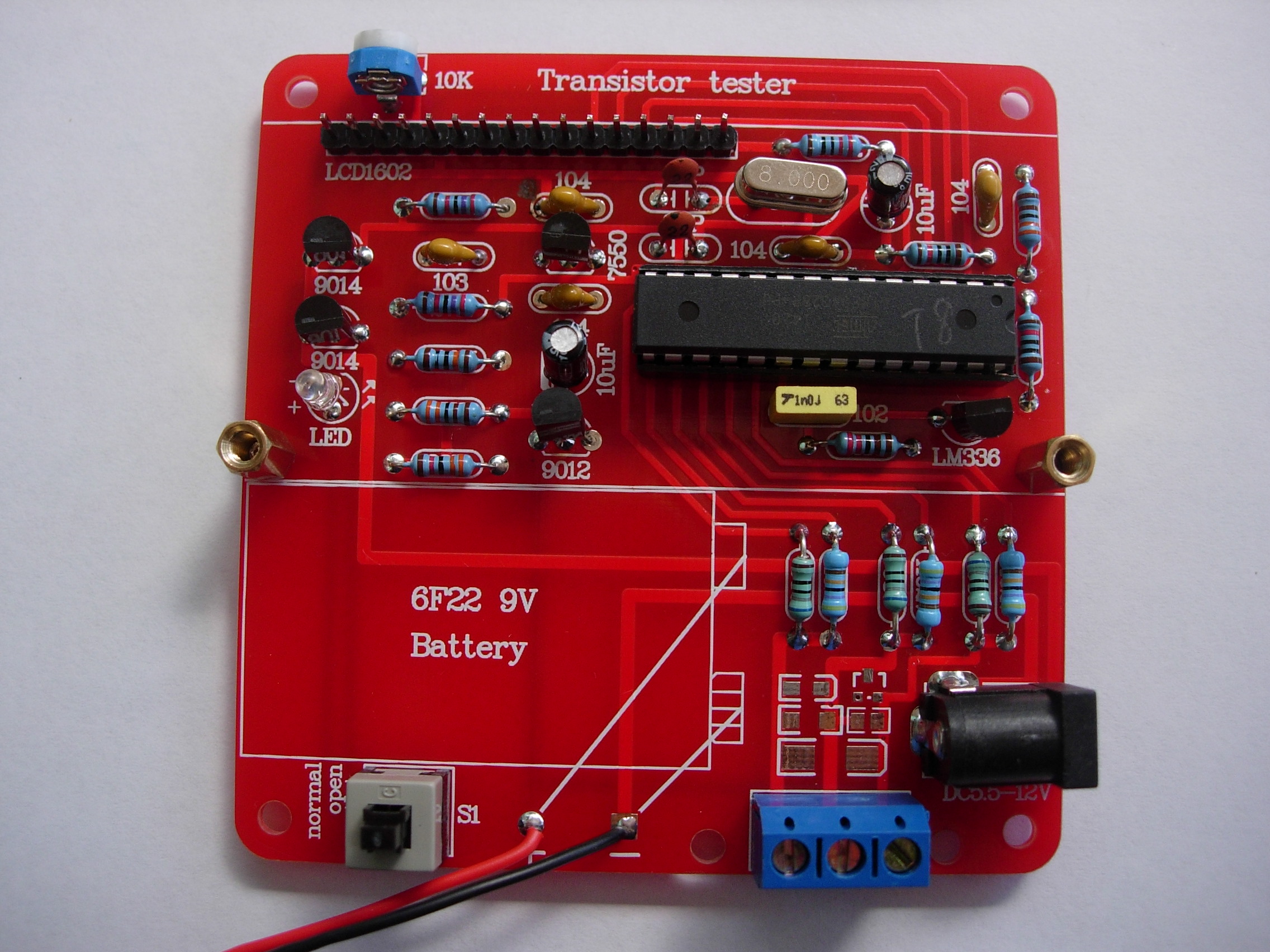

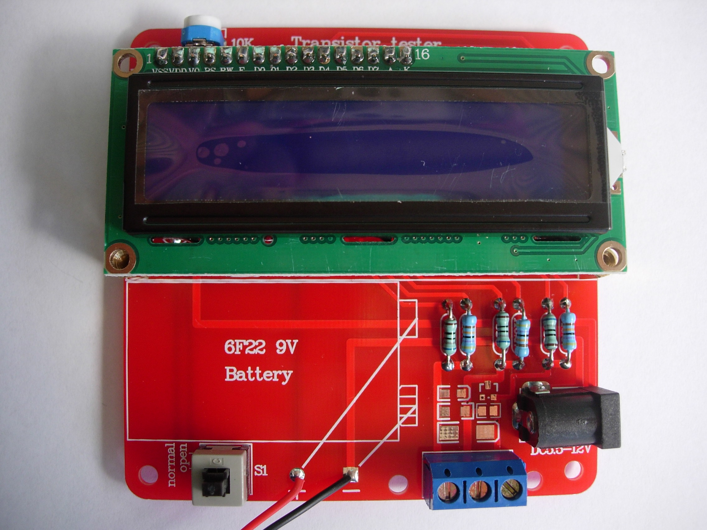

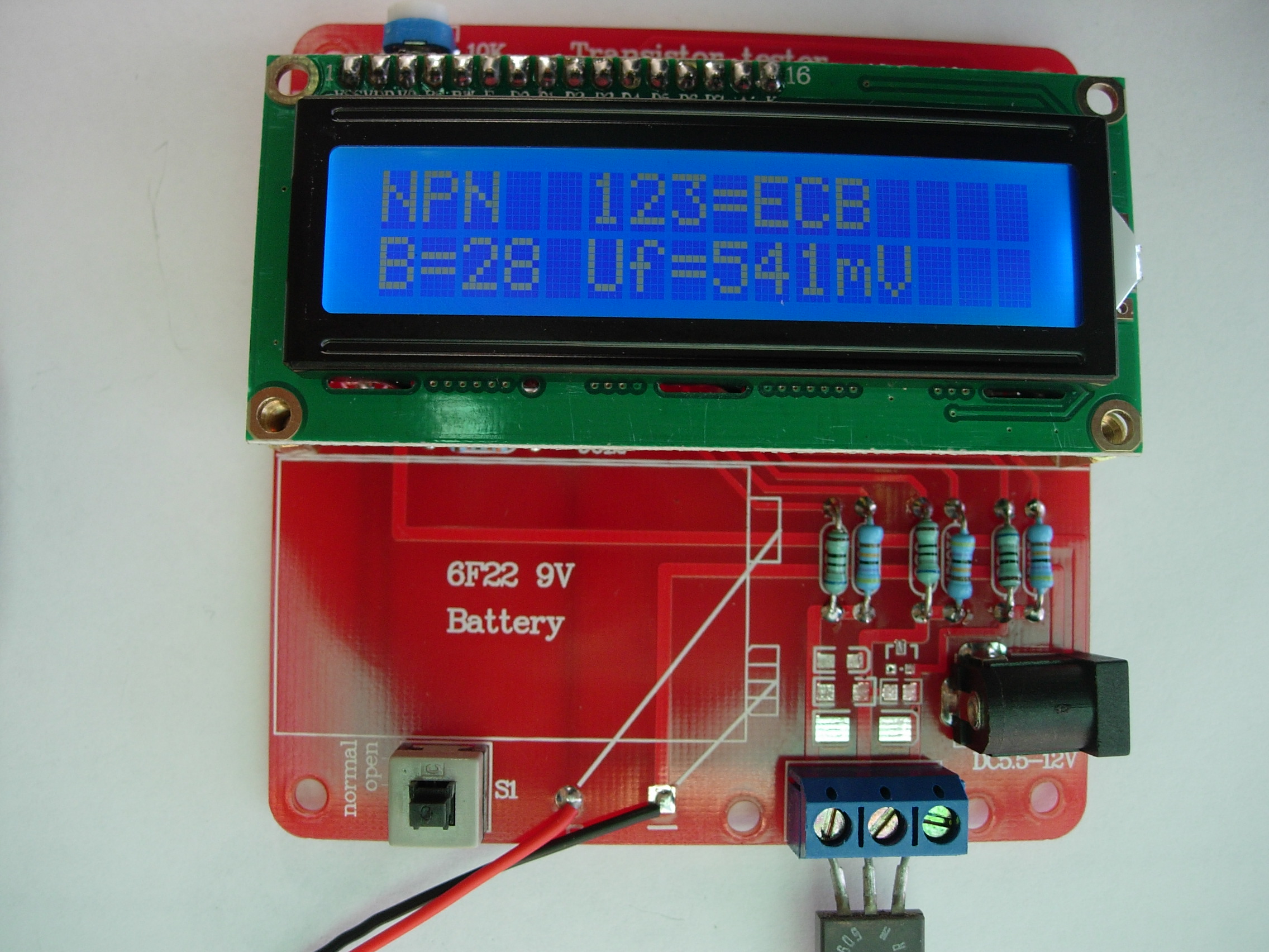

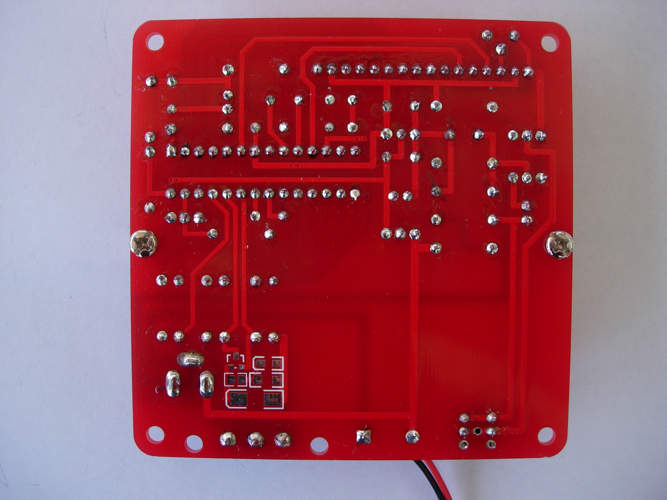

Just finished assembling & gone over board checking placement of parts. On powering up, only get the LED & backlight to work nothing on the screen. Checked the 2 electrolytics, one has 9v & the other 5v. Any sugestions where ive gone wrong.

Have you adjusted the preset? If the LCD is powered you should at least see squares when the preset is adjusted.
Thanks for that tip, had no idea what that preset was for. Very happy now.[ Bit of a trap that, if the preset is in the mid position the screen is completely blank.]
