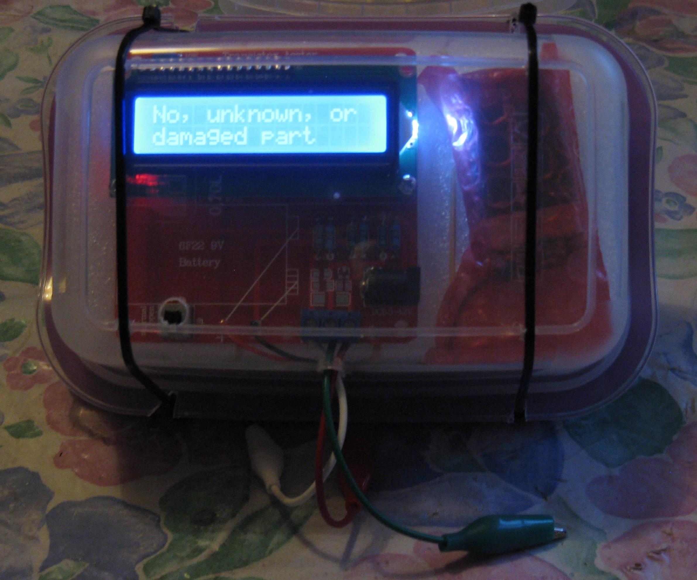

Mosaic, are you going to enclose it?
I used a food container.

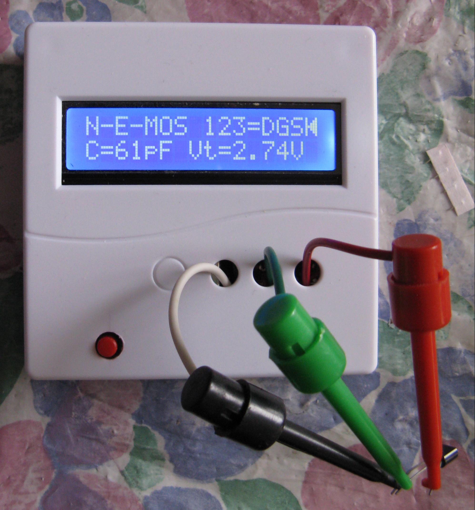

Well I just put standoffs for legs and hot glued the batt in place. I tested a few NFETs (like the junction capacitance reading) , diodes, LEDs and caps as well as some failed transistors I had to bin.

I put the tester in the case today.
The case may have been built for a different product but it can be altered to work with this tester.
Had to cut away the two protruding things in the box so the pcb could reach the 'bottom'.
Had to cut a hole for the momentary switch. Glued the red extension to the end of the switch rather than let it seat properly. This was necessary because the extra height was necessary. If you can solder the switch a little higher off the board that would be better. Might want to turn the 3 terminal block 180 degrees but in my case was not necessary.
Some peeps may want to cut another hole for the external adapter.
