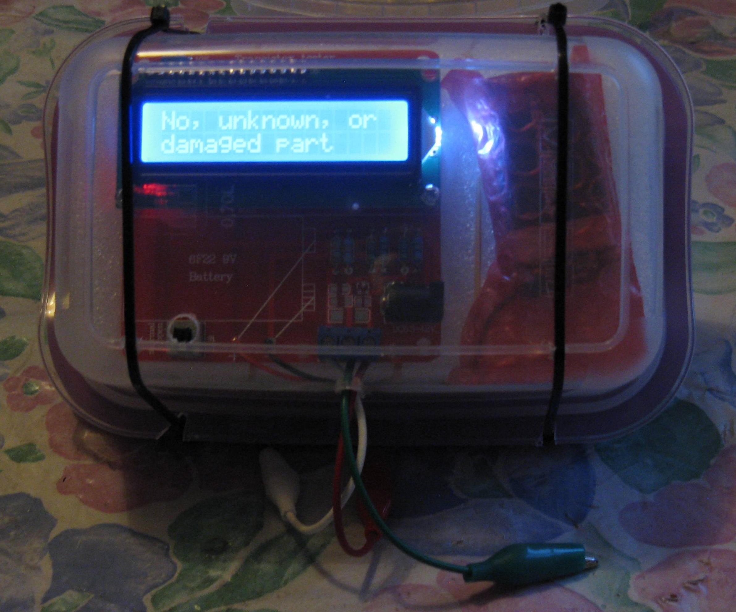

Put it together this afternoon. It gave proper results for the three components I fed it. resistor capacitor transistor.
I did not have a guide and installed the switch wrong. Turned the switch 180 degrees and the project worked much better :) I now have a guide.
Question: I may cut a trace and install a diode to protect against DC entering the meter the wrong way but there is the T3 circuit that may be already protecting. Can someone comment on this please?

At rest the current is too low for me to read on a 2 ma full scale digital meter.
With a new 9v battery I read less than 13 ma when the meter is 'on'.
Still looking for a plastic case.
The device is 81mm x 81mm x 21mm.
In the mean time I have found a free solution :)
A food plastic container from a set that I have never used.
The lid will not stay shut and so the product sucks and should be used for something else.
At a current drain of less than 13 ma the battery should last a very long time.
I'm hoping that replacing the battery will only distroy one of the four tie-wraps.
The white stuff is folded packing strips to push the display against the bottom of the box.
I have spst momentary contact switches but don't think I have to use one at this time.
I found a perfect extension for the switch. A plastic part of a Parker pen refill.
(not in the picture)
The display looks good even with the protection transparent strip in place and viewing through the bottom of the case. I just don't know enough about my camera to make a better picture.
Only three alligator clip leads were killed in the process :)
