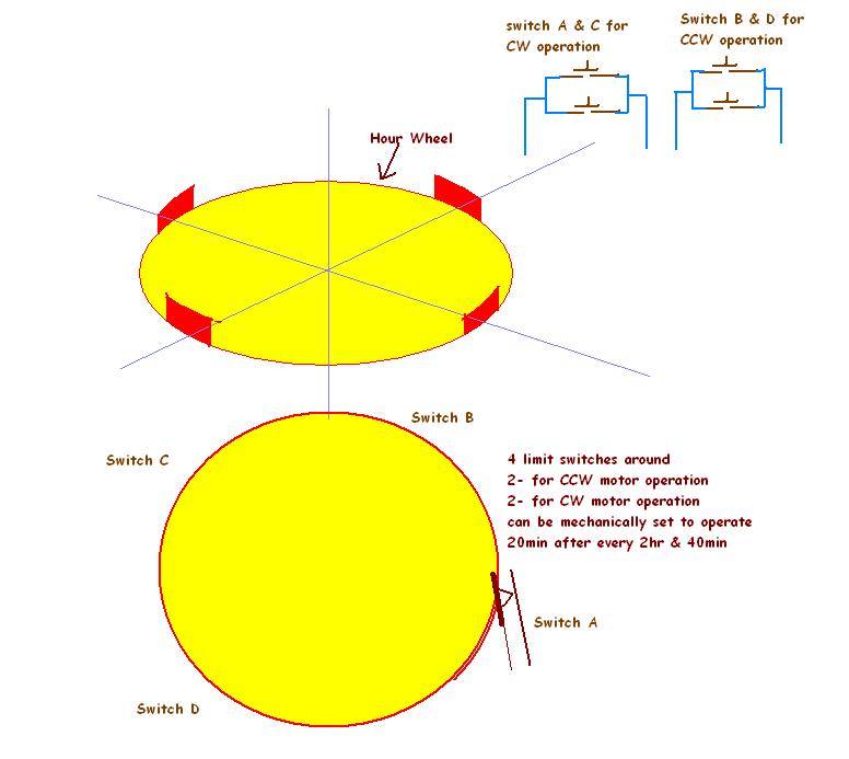

The Orbita (one of the other winder videos) would be an easier implementation because it could be done with the limit switches instead of 30 minute timers.
see the attached, if you have flexibility in choosing the time like 20min operation after 2hr & 40min like that, you can mechanically set limit switches as in the shown pic. its very simple
