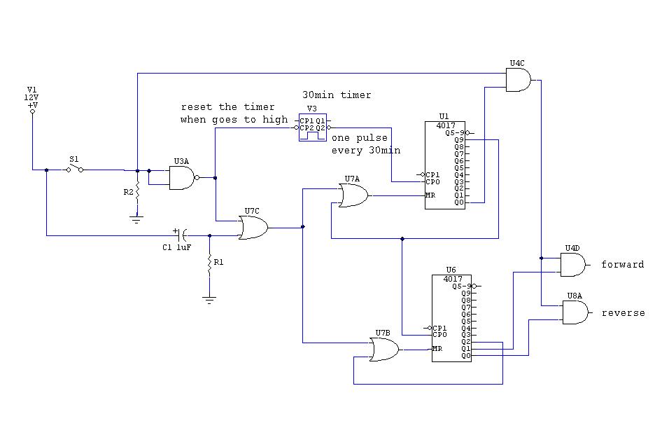

There is a way you can do it using 4017 counter, see the attached cct. you need to have a timer to give a pulse every 30min to clock the counter.
The out put is just defined as forward and reverse, need some modification depends on what you are going to use at the end to drive the motor.
if you want to go with PIC option, some one can help you...

Thanks Mbarazeen, Not too familiar with all that your schematic entails but it will give me some learning to do
What casues the polarity to switch and is the 4 hour off period built in?
little explanation may help you...
when the switch is toggled... the timer starts to count 30sec to deliver a pulse..
reset of both 4017 goes low so that it is active...mean time "reverse" out will go high....
when 30 min is over timer gives a pulse & increment the 1st 4017(above one) making "reverse" to go low..
the counter keeps on incrementing for another 30minx8 (= 4hr) until the counter get a reset...this time counter #2 will increment making forward to go high... until next 30min pulse and wait for 4hr to get a reset....
the cycle continues until you put the switch off.... when you start next time it start from beginning.
Edit: on my diagram mistakenly i swapped reverse & forward...but will not make any difference...

Thanks for the explanation mbarazeen that helps! I will give that a shot and I am sure I will have many more questions.
What did you mean when you said it will need modifications depending on what I use to drive the motor?
It is just a simple 12 volt geared motor drawing about 100MA.
you may go for a relay at the put put..or even direct drive via transistors.. why even you can select a driver IC...
In the circuit diagram what is the 30 minute timer V3? Is that something you can buy or does it need to be made? I tried looking online for it with no luck.
Also what are all those other half ovals? Would anyone be able to explain what each compnent is and its function? Or direct me somehwere that could refrence what they are?
