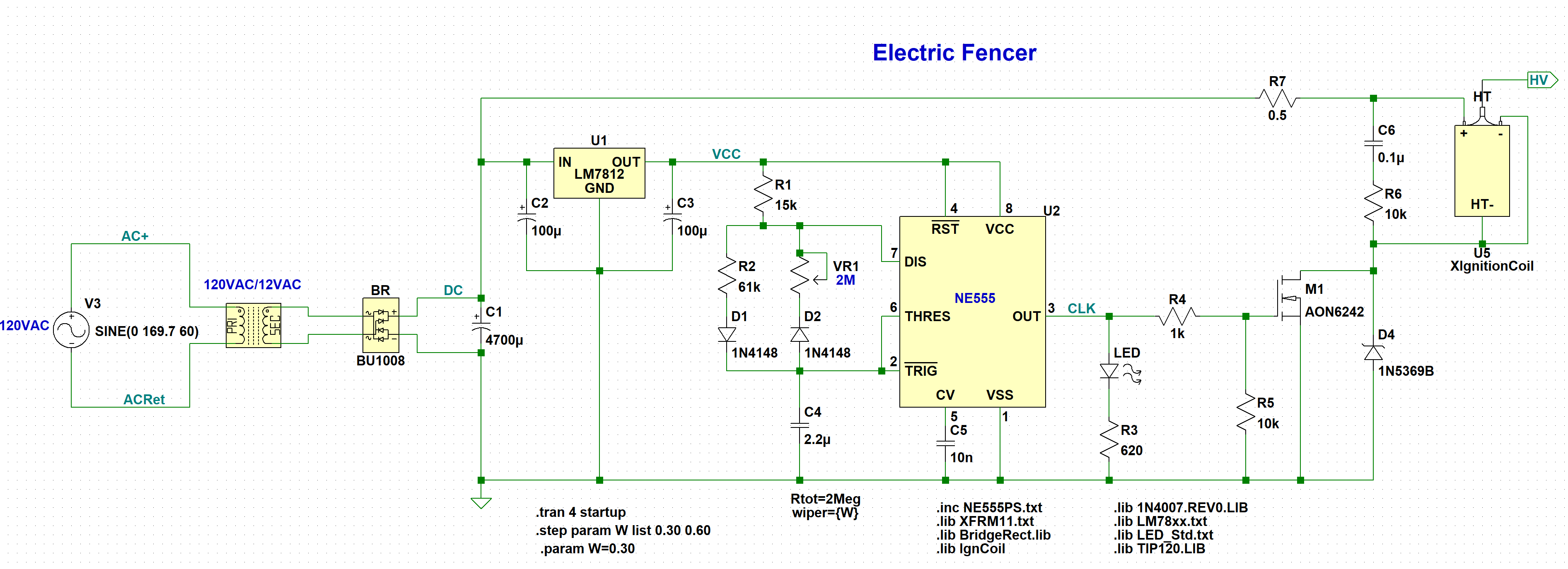

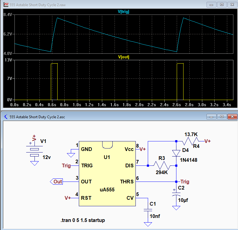

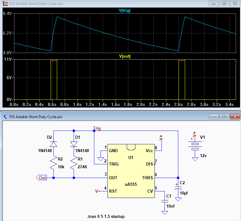

Here's the LTspice simulation of AK's 555 circuit in post #9 with fixed resistors to give the desired duty-cycle of 0.1s ON with a 2s period:

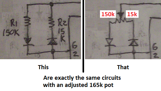

I did not understand how you got these numbers when I saw this for the first time and numbers did not work in the book formula, but now I do. Book formulas don't work with parallel resistors. This is an interesting way to do this.
Edit: Below's a modified circuit with only one diode.
The main advantage is that the timing circuit is not connected to the output, as in the above circuit, so any output loading has no effect on the timing.

I wish you can see that a pot is simply two resistors in series like this:

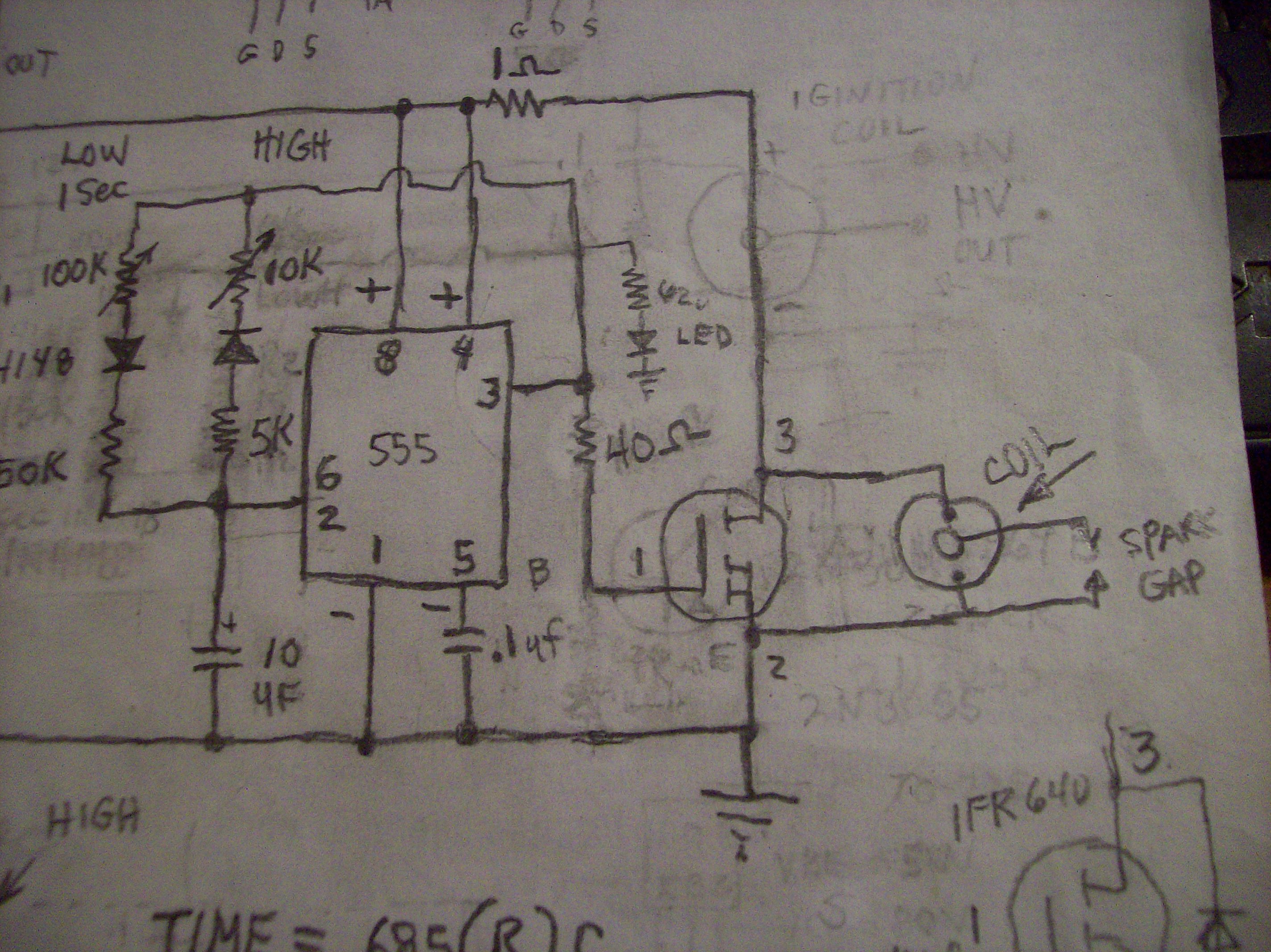

Last time I checked wall voltage was 121 vac. I will build power supply first to see what the voltage turns out to be then I know what to do next. I had a 1N4007 diode across 2N3055 collector to ground but someone said, get it off there that won't work. I found an electric fence circuit online with 1N4007 on the 2N3055 collector it said exactly what you said, it protects the transistor from HV death. I don't have any zener diodes, never did, never worked with them, I know nothing about them, don't know which 1 to order?
I have a 555 driving a 2N3055 with no base resistor I built 30 years ago. The 555 has a variable resistor for 1Hz to 30KHz. Ignition coil makes a 3/8" spark about 10mm at low Hz. As Hz is turned up spark gets shorter and shorter finally no spark above 10KHz ignition coil is not a high Hz device. No base resistor and no diode on collector to ground it has been working 30 years. It has an 8vdc power supply because that is all I had at the time to build it with. Since I can't find any of my other 2N3055 transistors I will probably use parts from old circuit to build the new circuit.

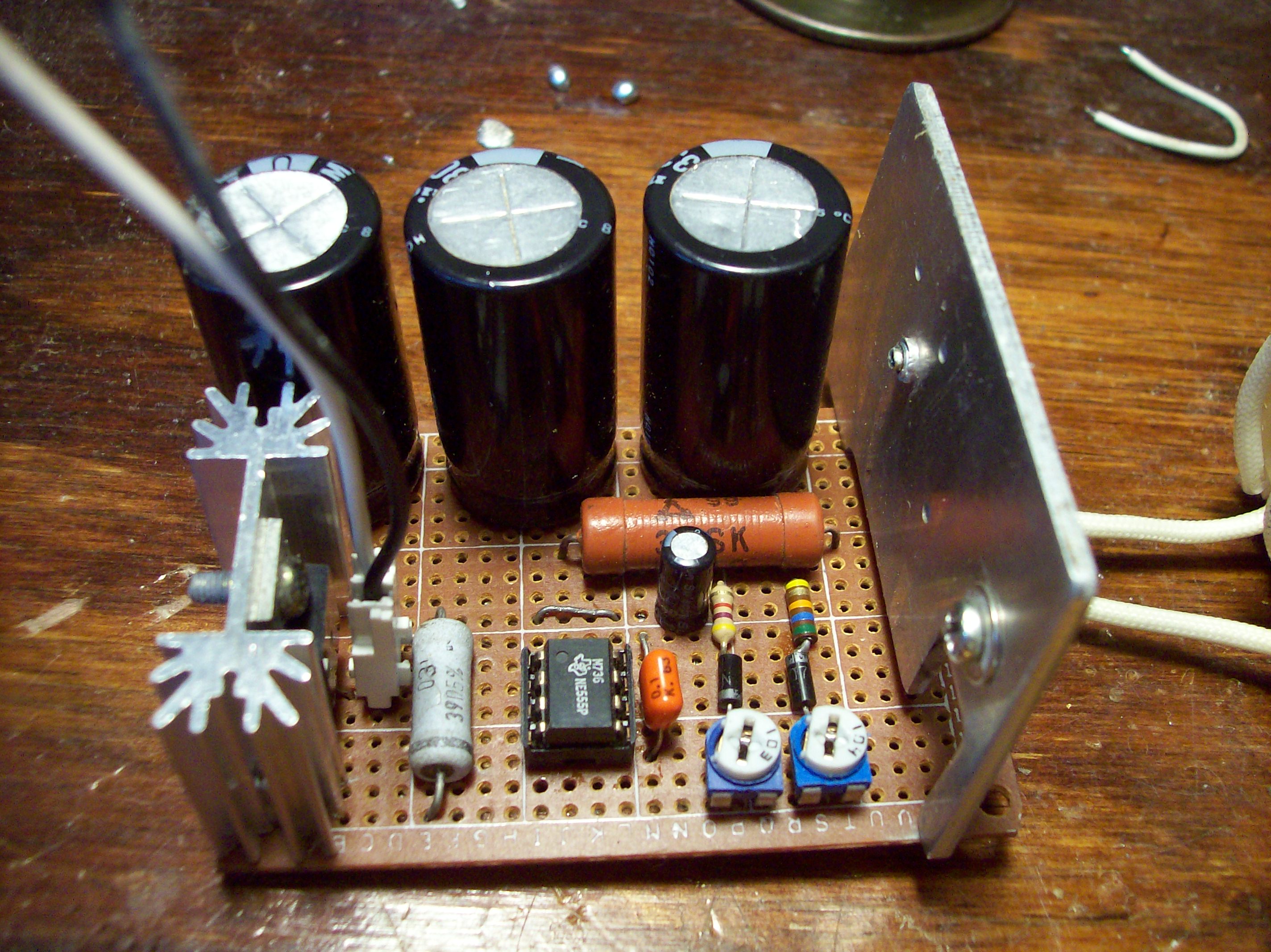

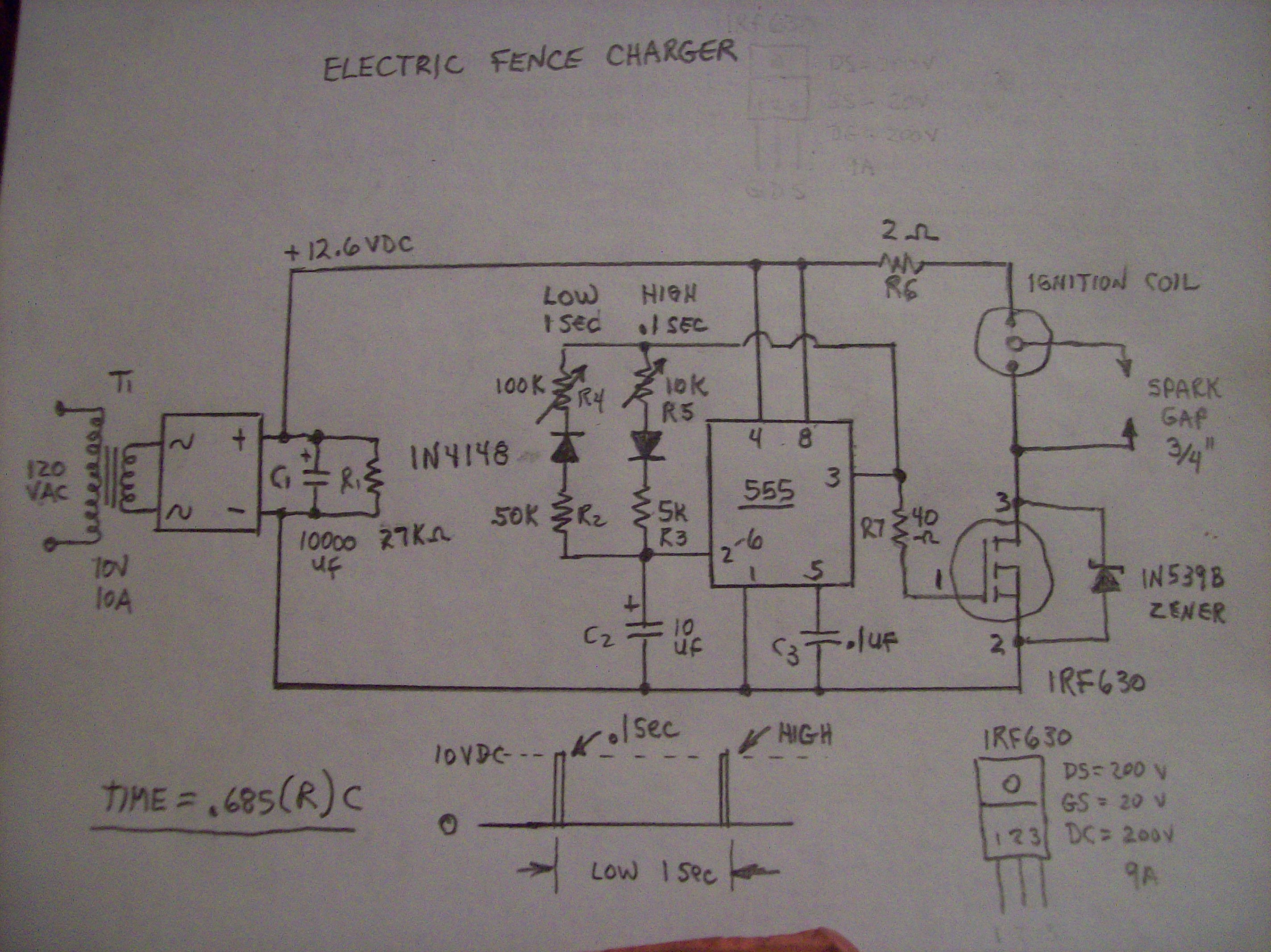

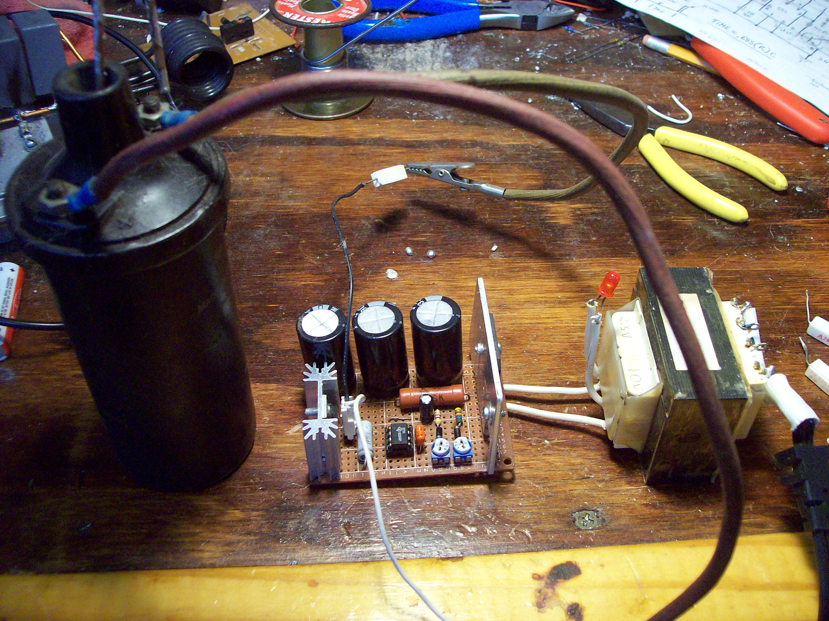

I finished the PC board today and tested it. It works perfect except for 1 problem the mosfet over heats in about 15 seconds. With R6 = .5 ohms I get a 3/8" spark. With R6 = 1 ohm I get a very hot blue 3/4" long spark. With R6 = 2 ohms I get a weak 3/4" spark. With R6 = 3 ohms I get a very weak 1/4" long spark. 1 ohm limits current to 6.3a. The mosfet should be OFF 99% of the time. I have no scope, using the volt meter and adjusting R5 for the shortest time the meter will read a voltage pulse of 3v, if I shorten the pulse it is too fast for the meter to read it, meter shows 0v but ignition coil gives a very good spark. R4 time between pulses from 1 sec to 2 sec . With 2 sec between pulses and .1 pulse length mosfet over heats too hot too touch in 15 seconds. What is the problem? Is the mosfet not turning completely OFF? Look at the blue spark on pic #4. R6 = 2W resistor or 15w resistors both over heat.
For what you are doing, I don't think there is any need for R7.
Separate from that, the bipolar NE555 output stage does not go all the way to GND. Probably not the problem, but to test the theory I would leave R7 where it is, increase it to 100 ohms, and add a 1.0K resistor from the gate to GND. This will decrease the gate drive slightly, but it still will be near 10 V. AND, it lowers the off state gate voltage by 10% ish.
Now that I've looked up the IRF630, it smells like a culprit. At 6.3 A drain current, that's 11.5 W. You may need something more accurate than a volt meter to see your true on-time.
The worst-case duty cycle is approx. 5K / 150K; 3.33%, or a 96.7% off time. Move either pot off its end stop and the off time percentage decreases.
Nice, clean assembly. Gold star.

Assuming your PS can indeed supply 10A, look at the basic Ohms laws. With a 2 ohm resistor (assume that is the only resistance), you will be drawing close to 6A current. I^2xR = 6x6x2 = 72 Watts of power thru the resistor. With a 10% duty cycle (1sec off, 0.1 sec on), that still means 7.2W of heat. The MOSFET is on for approx. 10% of the time, off for 90%.
Of course, things like RDSon of 0.4 ohms changes things (12V/2.4) = 5A = 50W x10% = 5W on resistor. 5A thru the MOSFET would be 5x5x0.4 = 10W dissipation for the MOSFET, which may require a larger heatsink.
Lower resistances to the coil just compound the heat issue even more. Not sure about the resistance of the coil itself.
I agree with Analogkid, put a 1k (or 1 to 10k) resistor from gate to ground to ensure the gate does go down low when off. With heavy current draw in pulses, it may also be possible you are dropping the voltage source on the 555 (ie the entire power supply), causing some "reset". This depends on the capacity of the transformer of course. Try a larger resistor to the coil, see if the heat dissipation drops (even though the spark may be a lot smaller). Measure the voltage supply to the 555 and at the gate of the MOSFET with a high value resistor, then again with a 2 or 1 ohm. The readings should be about the same if you are not overloading the transformer. On an "average", the MOSFET gate voltage should be well below 10V, even lower than 5V with a regular meter (which cannot read spikes). Only with a scope can you really see what is happening however....

I changed R7 to 100 ohms then added the 1K resistor and it does not work. Now I realize the ignition coil was connected wrong across pin 2 and 3 of the mosfet before but now it is connected the correct way and nothing works. I removed the 1k resistor and replaced the 40 ohm resistor it still does not work wired the correct way. I tested all the parts mosfet is good, voltages are good, every thing work but no sparks. The ignition coil ohms 1.5K ohms. Now I see the way it was before when it worked is like this circuit below. There is 12.6v to the ignition coil all the time when the mosfet turns ON is shorts out the coil and there is a big spark. No wonder mosfet was getting hot it is a direct short across the power supply. When mosfet turns ON it shorts out the coil and this fires a big spark. Now I have it connected the correct way it does not work maybe because .1 second is too short to fire the coil? Ignition points in a car are closed all the time, when cam opens the points at the correct time it fires. Now I need to experiment change pulse from .1 second to a larger number to find out what works.
With the last schematic, you would have to program the MOSFET to be on 90%, and off 10% of the time to get a pulse to the coil (based on your cam logic). Otherwise, the coil is conduction most of the time, and you just short it 10% of the time. Get the "story" straight, which is it supposed to be - 10% on or 10% off for the MOSFET? Reversing the logic to match a cam, you would have to reverse the on/off times with the two potentiometers.
The MOSFET with a 1 ohm resistor would have a total of 1+0.4RDSon = 1.4 ohms resistance total when in conduction. That would draw about 8-9 amps. That would be 9x9x0.4 = 32W for the mosfet while conducting, and adjust for conduction time %.

Wire resistance of the ignition coil is 1500 ohms. Add the 1 ohm resistor you get 1501 ohms. The ignition coil is not induction to DC volts its just DC wire resistance plus the resistor. But do the math 12.6 / 1501 = .0083 amps. How can amps that low heat the 2W resistor smoking hot the the mosfet too hot to touch in 15 seconds. It makes no difference how I just need to fix it and get it right. Tomorrow is another day. I'm going to check see what the dumbest show on TV has ON tonight, Svengoolie says, Son of Dr Jekyll. LOL. 90% of these shows are too stupid to watch but much better that most crap on TV these days. The Giant Spider that ate New York City was interesting. LOL
