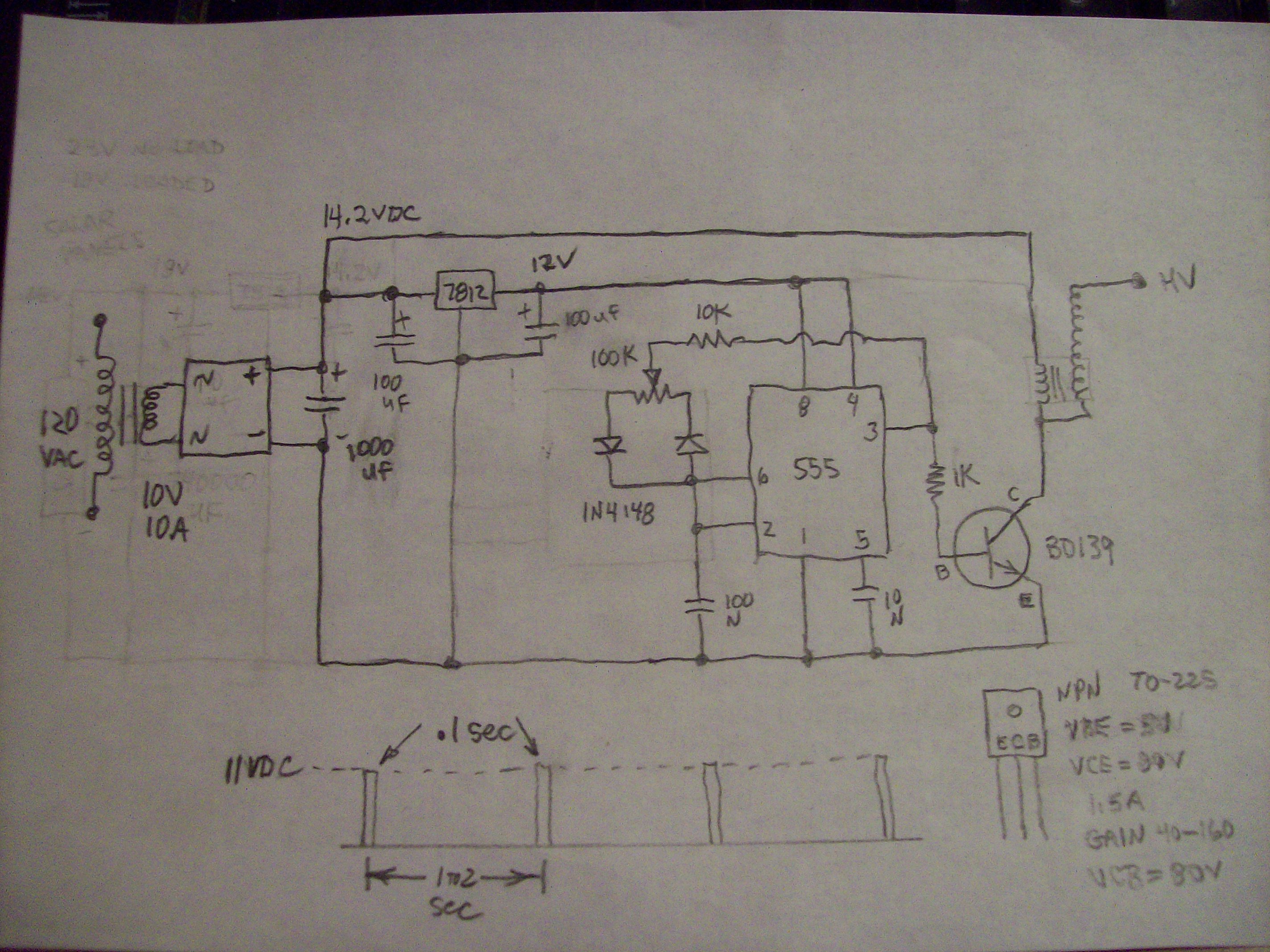

I agree that only one voltage regulated is needed.
The 740 thousand uF capacitor is impossibly enormous and should be only 470uF or 1000uF.
You show wrong pins on the BD139 transistor.

I found a 10v 10a transformer in my stash. Here is the new circuit. I read voltage drop across a 78xx regulator should not be more than 3v.

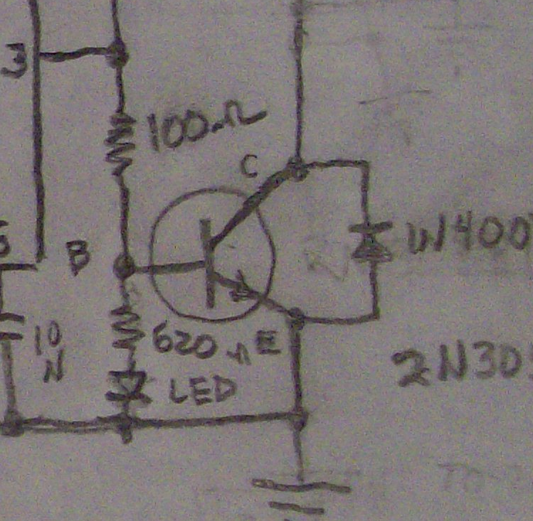

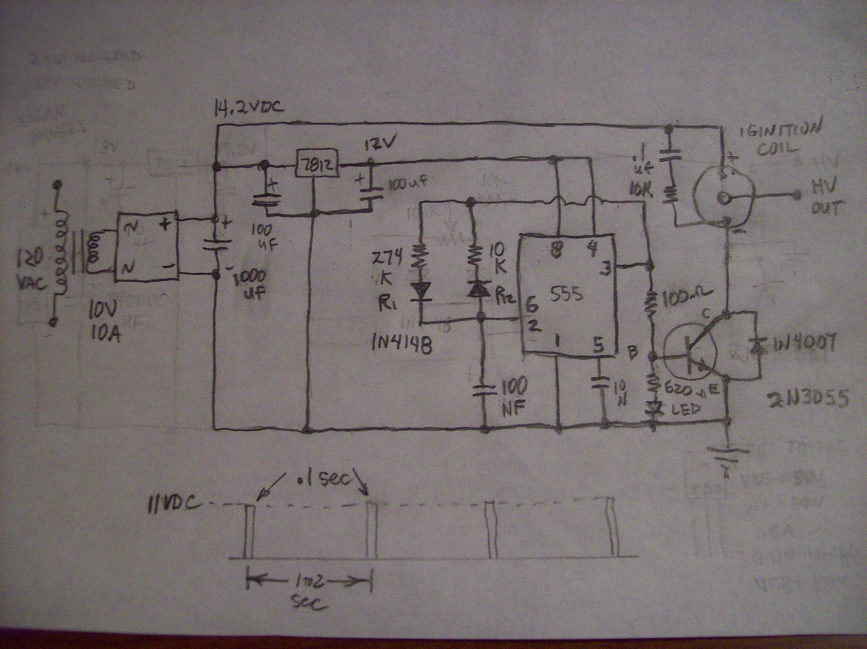

New circuit. Since the TV HV transformer is designed for RF and ignition coil is designed for 1 sparks I decided to use the ignition coil in this circuit. I also decided to use 2N3055 power transistor this will give more current to the ignition coil. Someone suggested a 150 ohm resistor connected to transistor base so I will try that first then compare that to 100 ohms to learn what different is makes. I changes variable resistor to fixed resistors for 2 second plus as someone suggested. The 1N4007 diode on the transistor appears to be a short circuit from C to B. I wish I had a selector switch for R1 & R2 so I can flip switch for 1 second pulses to 2 second pulses.
The Base-Emitter voltage of a 2N3055 is small. Around 0.7V. That will not turn on the LED.
The LED needs to get its current through a resistor directly from the NE555 pin3.
OR
Put the LED in series with the 100 ohm base resistor, If the LED can take that much current.
1) The LED connected to the base of the transistor will never produce any light, because the base-emitter turned on voltage will be only 1V.
2) The 100 ohms base resistor has 9V across it (if you have an original 555) which is a current of 90mA. With this fairly low base current the 2N3055 saturates with an output current of only 900mA.
3) The 100nF capacitor with your resistor values produces very short duration pulses and pauses. 8us and 200us.
4) The timing resistors are backwards producing 200us output current and 8us pauses between output current.
5) The datasheet for the LM555 shows 20uF with a 10k resistor for a 0.1 second pulse and about 330uF with 280k for 1 second pauses.
You talk about "555" ICs but you do not say if they are the original powerful NE555, LM555 or the weak Cmos LMC555, TLC555 and ICM7555.
1. Your right. I copied that from another circuit. It looked good but now I see it will do nothing.
2. I don't know how to do circuit math I have no clue what your telling me to do?
3. Someone else said that is correct for 2 seconds I took there word for it.
4. I copied that from TTL book. 555 online calculator says 50 and 950 ohms for 1 second pulses.
5. OK
I have NE555P and LMA555CN I have cooked some of these at 14v and 14.5v that is why I want to use 12v. If I had an 18v 555 that would be great.
I need to go back to what i know, read the TTL book for correct values, do math see what I get.
That diode does nothing in your circuit.
If it's to protect the transistor, it needs to be a Zener with voltage about 20% below the transistor rating.
You can add a switch that will add a 274K resistor in parallel with R1.
But reverse the diodes as AG noted, and change the cap from 100nF to 10uF.
That gives a time-constant of 92 seconds, which is not correct.

The diodes affect the timing a little.

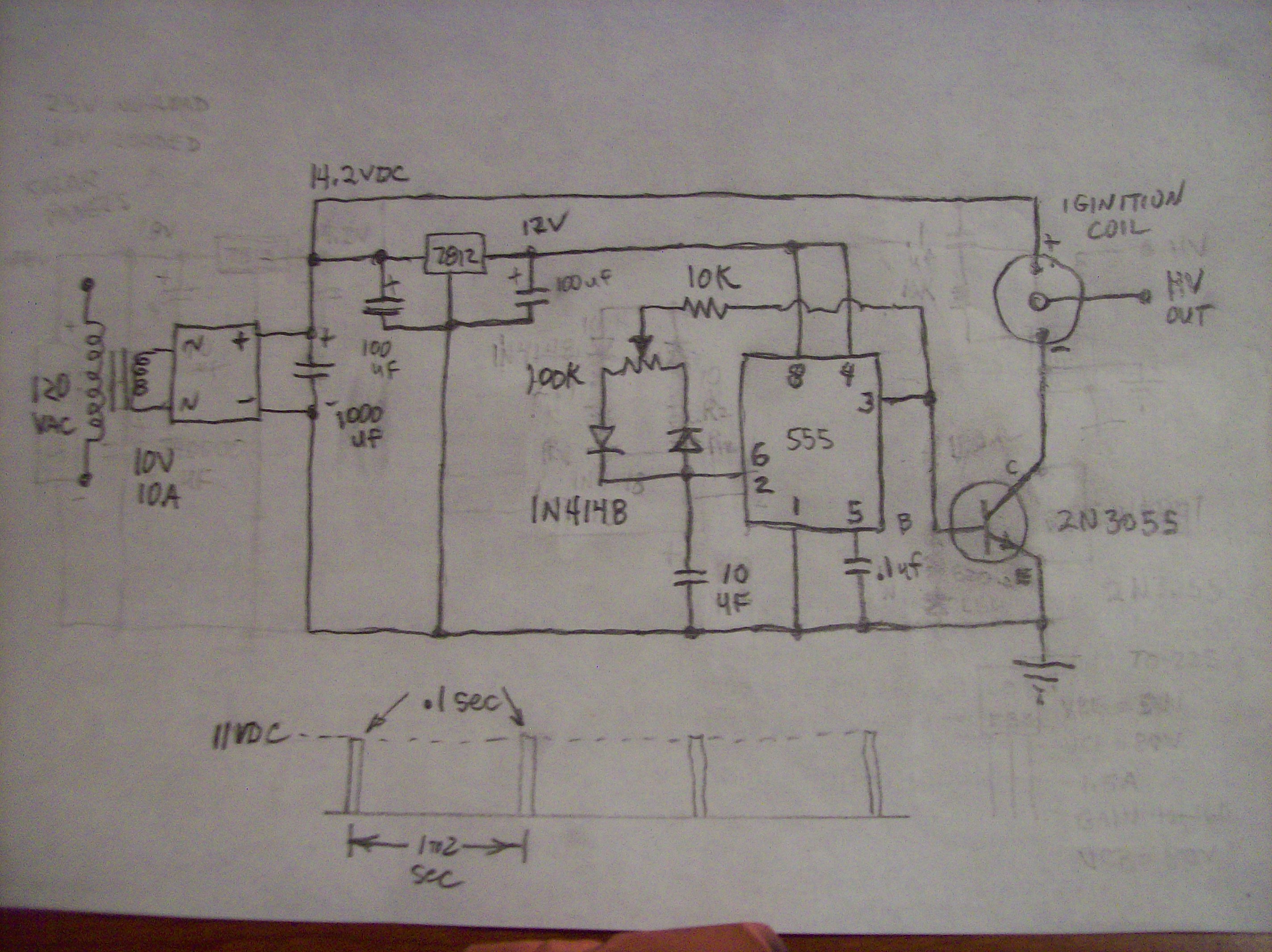

I readjusted the timing components to obtain 100ms on for 1 second and 2 second intervals

I have no information on this circuit with the 100k variable resistor? What does the adjustment do?
You'll need at least 11.6VAC output from the XFMR:
12V Out + 3V D.O. + 1.5V Br. Rct = 16.5 Pk = 11.6 VRMS = choose 120VAC-14VAC
