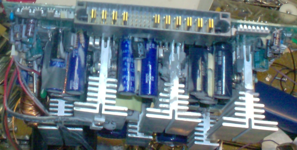

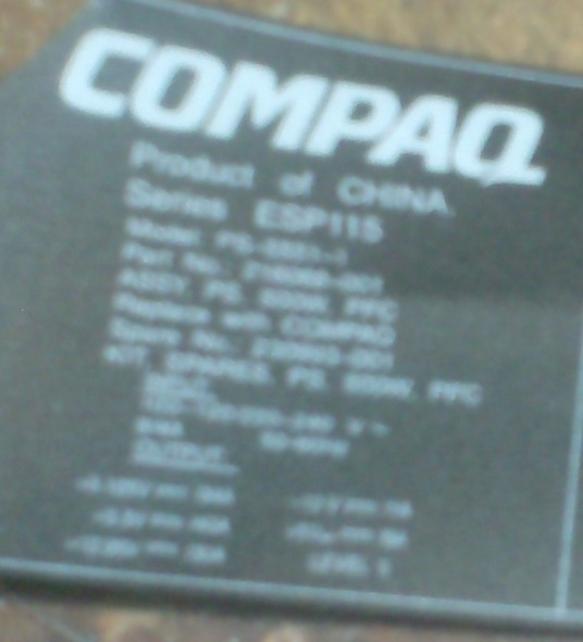

I have a compaq server power supply and I have plugged it in, but get no power out of it, I assume that it needs to be "instructed" to turn on by the server it is supplying power to. Does any one know how to turn it on? Which pins to power up or short or what ever? To further complicate this question, any one have any idea of how to boost it's output to 18V?
Kinarfi
An old saying, look before you leap, guess I should have looked before I posted. found the answer else where, but just in case some one else can use the info, you only need to short two sets of pins out.
