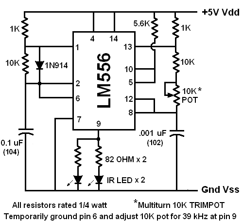

I would suspect the 555 based transmitter circuit rather then the well designed TSOP part.
I recall that the TSOP expects transmission bursts. Do not send it a continous IR stream.
Have you looked at the TX and RX outputs on a scope ?

Like colin mac said, your 555 timer gives just below 25khz. Try:
C = 10nf (0.01uF) ten times smaller than you have now
R1 = 1.8k
R2 =1k
These should be very easy to find (all are standard E12 values) and give 37.97kHz. The TSOP has a very narrow response bandwidth, you need to be at 38kHz +/- a kHz or two at most.

Nope. A burst is just a short transmission or msg. Remotes generaly send a device address and code. That is more info then you are interested. What you need to know is that is quickly sends it msg and then turns off. The TSOP is designed around this behavior. If you transmit for too long it confuses your transmission with stray light and the TSOP will not work as well. You need to turn on your transmitter for short periods of time.
Also you may be able to test the TSOP reciever with a TV remote.
You could adapted this you can adjust it down to 38khz
