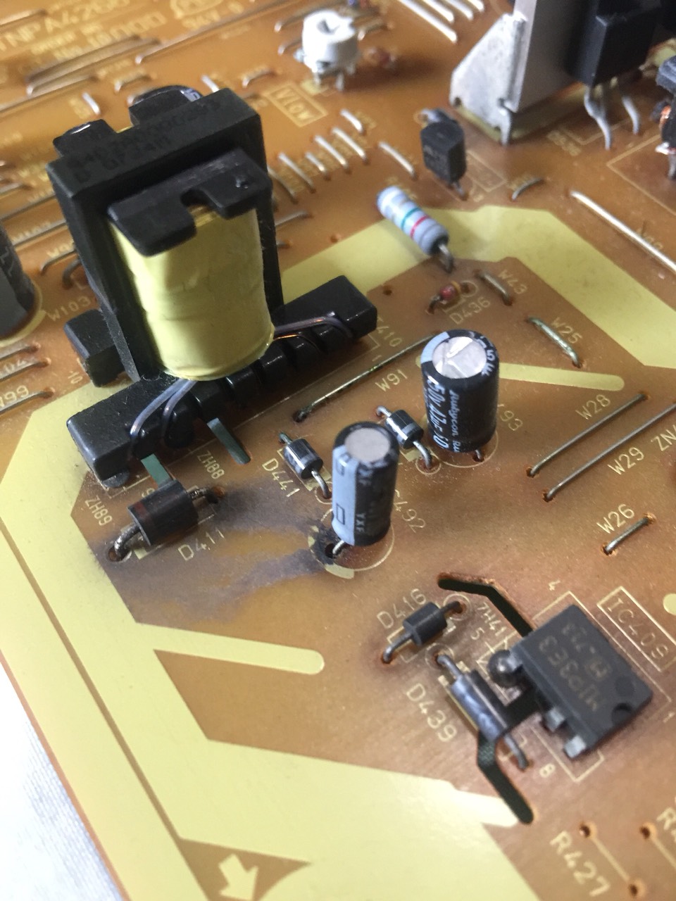

HI All, I'm repairing my Panasonic Plasma TV PSU and need help to identify this diode(D411). T2D76 is written on the body and a red band on one side. Pic is attached for reference. Any help would be greatly appreciated! Thanks in advance.
looks like TS has replaced those caps already.
i always have more luck identifying components when an image of the markings are displayed. Many cases people just read them wrong.
Thanks for the reply. Yes I'm going to replace C492. When I do diode check with my DMM on D411 out of circuit it reads 0L on both (Forward bias, Reverse bias). Seems open. Can identify this diode or can suggest a replacement/alternative?

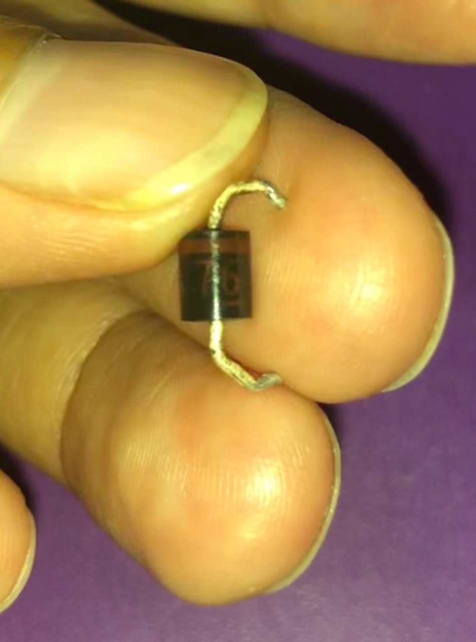

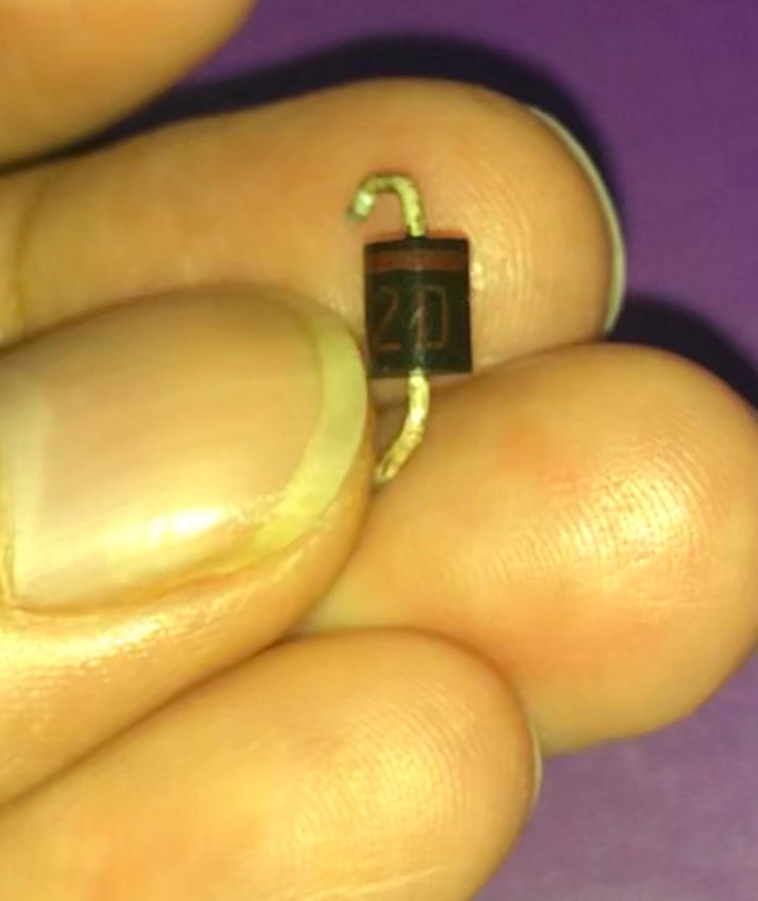

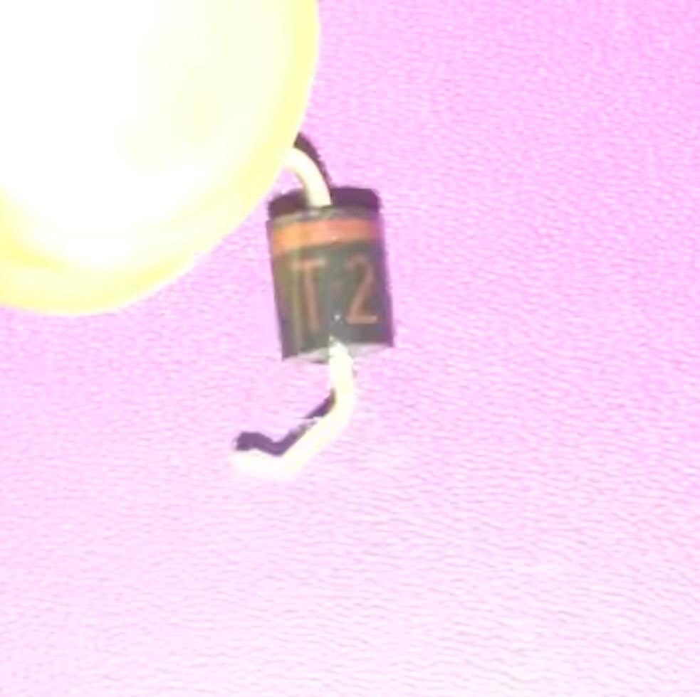

I took a clearer picture again and here is the sequence of the label as written on the body...the last character 6 seems underscored.

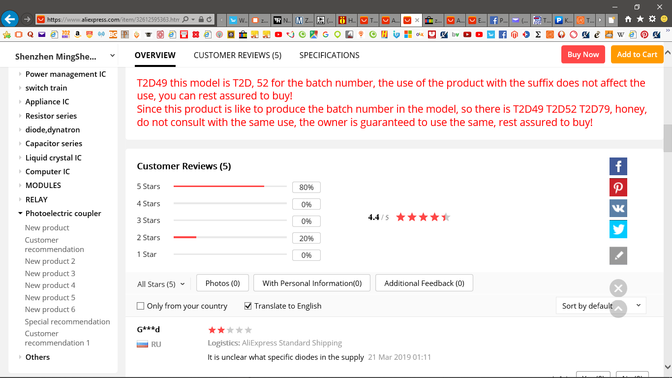

Good Luck, and please update if you find out. I saw some stuff that claimed the colors determined the voltage rating. If that's the case then its more likely the 76 is just a lot code.
I have ordered T2D from AliExpress already. Cannot find this part in my country. Need to wait 2 - 3 weeks. I'll update you guys once I replaced the suspected parts.
After over a month's wait and the suspected parts have been replaced (C492 electrolytic cap, T2D76 diode and the IC MIP3E3). Also found one bulging cap 1400uf/220v at primary side, thus replaced. Now my old TV is working again. Thank you guys for helping me save few hundred $$ sending this tv to a service center. Again, thanks to all who contributed and gave helpful and informative inputs to this thread.
