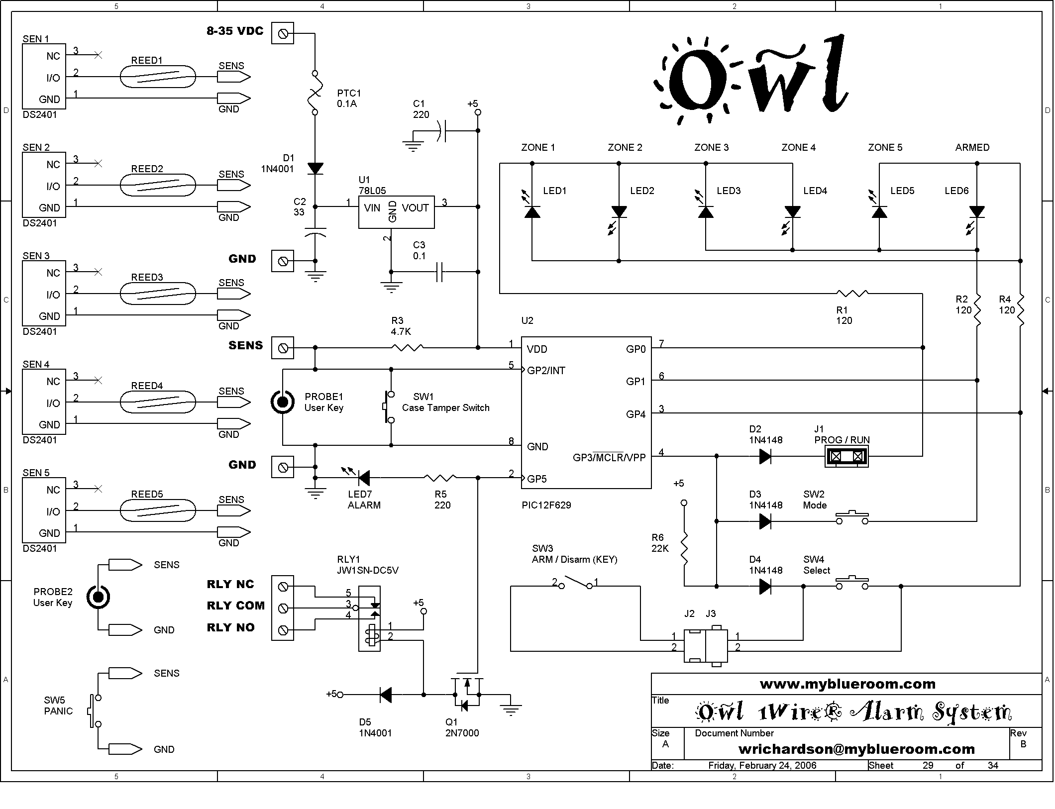

It's not parts you can get from Radio Shack, PIC 12F629
It's easy to wire up and not so easy to defeat.
It uses a microchip www.microchip.com PIC 12F629 processor and Dallas Semiconductor iButtons www.ibutton.com
I'm still working on the source code, and will post updates on my project site www.myblueroom.com as often as time permits. (Everyday at the moment)

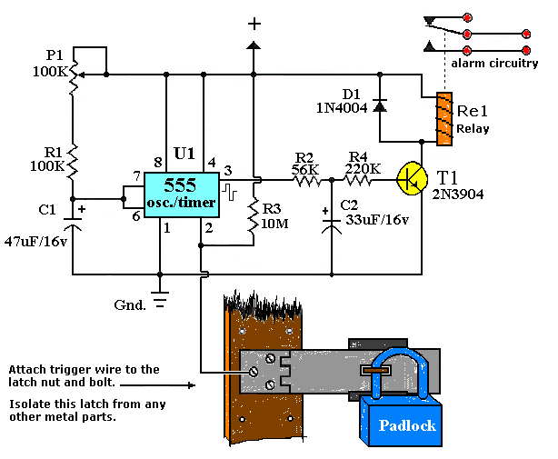

Here is a very simple circuit.
