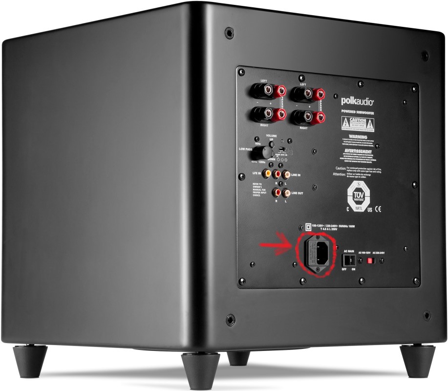

I have a Polk Audio DSW Pro 600 subwoofer that is currently blinking quickly between amber and green. For the first about 30 seconds or so, the LED light will be green then it flashes very quickly from amber to green light. I took the plate out of the subwoofer cabinet. I read other threads where they said it could be a fused issue but I couldn't find the fuse in here. Perhaps I don't know I'm looking for. Below is an image of the plate I took out. Any help is much appreciated.
If it's this device then the fuse is inside that black AC plug. You can easily take it out with a screwdriver. But if the fuse were faulty, the device wouldn't even turn on I mean the LED wouldn't even blink as you said. Feel free to check it. Good luck
PS: How old is the subwoofer? When did you buy it? (Warranty period?)

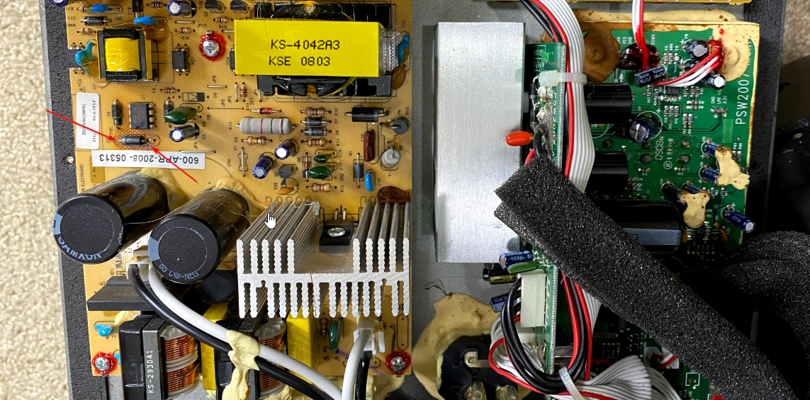

And could you check that diode with a multimeter? It looks burnt to me:
In most cases the LEDs blink (normally red) because the device goes into protect mode which tells you that something is broken on the board.
yeah that diode is marked TVS1 on the board, and it's in the standby supply... that definitely could be part of the problem...

A clearer pic of the amplifier without bits of foam in the way might help too :)
the bits of foam are glued to the power and speaker cables.... this is common on powered speakers to keep the wires from rattling up against things.... and it looks like the wires covered in foam are soldered in place
