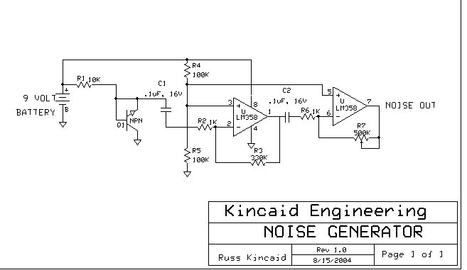

need 5v out noice genrator
I did not build this, but it should give some noise. Q1 can be any NPN transistor, R7 adjusts the output amplitude. Instead of a 9 volt battery, you can use a power supply of up to 15 volts.
