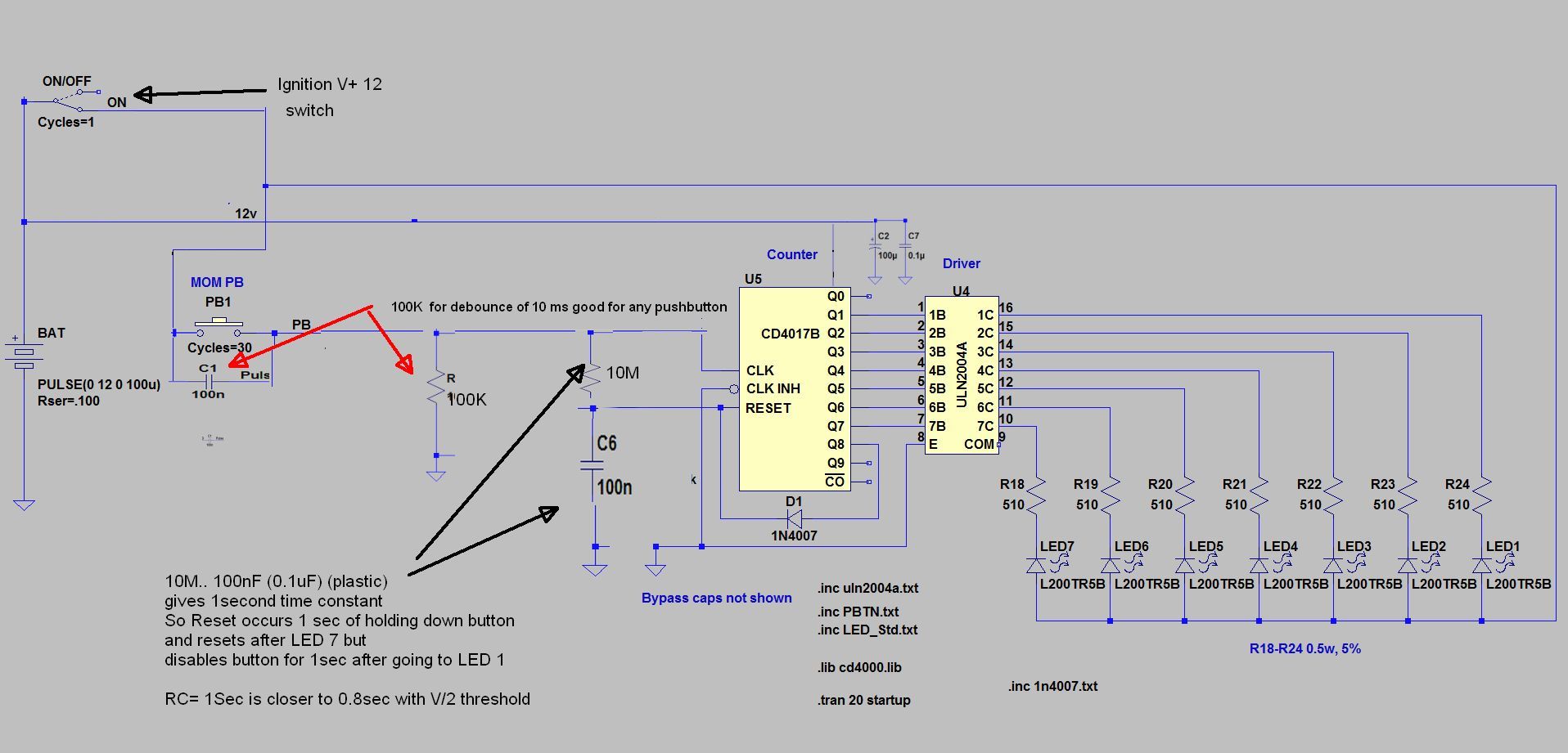

My 1st project - To cycle through 7 LEDs with push button
Aight fellas, while you all have provided some incredible insight, and I have followed some of it, I need to put something together using my limited capabilities. While I learn from the things you all have posted, I'd like to produce something as a "working temp model". To help you all help me, this is a schematic that shows you were I am so far. The numbers may be wrong, and this probably isn't the best model with the cleanest edges (and I have no idea about the circuitry inside the strobe unit)
But will this do as I need it to?
1st problem:
The LED's can't drive the LEDs at all, because you only have 0.5 to about 3 mA sourcing and sinking current (depends on supply V and temperature). That's why you need the ULN part. The LED supply comes from a +V IGN source and the driver SINKS the LED when a positive voltage appears at the input.

Aight fellas, while you all have provided some incredible insight, and I have followed some of it, I need to put something together using my limited capabilities. To help you all help me, this is a schematic that shows you were I am so far. The numbers may be wrong, and this probably isn't the best model with the cleanest edges (and I have no idea about the circuitry inside the strobe unit)

Coin Cell wont work and would not connect to CLK. Use dash or accessory V+ is on always. Also need diode and large cap.

1) remember , it must remember the same LED.
the unit will need to light the same LED that was on prior to switching off the unit.
2) It must use an inverter like ULN2002 to invert the output to give Common Anode LED to V+ or switched 12V
3) Both the ULN2002 and CD4017 work down at 3V ( suitable for LiPo )
4) The ULN2002 is a darlington with ~22K input impedance ( inc. 3 diode drops)
5) The only way the coin cell will work is if the LED's to run the switch and CD4017 off 3V and common Anode (+) (ULN2002/4) as I said before.

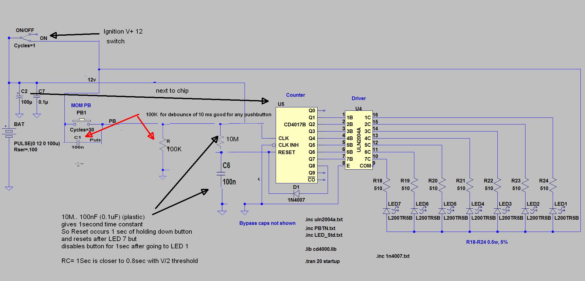

I cut N pasted it with an ECN to reflect my prior suggestions. Hope you approve. :)
hysteresis on CLK input, Time constant will switch with ~45% hysteresis compared to T=1/e or 62%
the 100nF if ceramic may have self leakage < 10MOhm so plastic is recommended.
The Clk input is shown connected permanently to 12V :confused:.
No, rather it is connected to a momentary push-button , incorrectly shown as Normally Closed connected to ignition switch +12V
Tiny push buttons are ~1ms bounce and larger momentary push buttons are ~10-20ms while flakey old contacts depend on pressure and can oxide and bounce forever, so the cap also helps burn off oxide ... ( microscopic oxide detonation) , although scaling the C up and R down would do better in the latter.
The result is CLK is Schmitt input from 1/3 to 2/3 V+ so it generates a clean clock with slow falling edge and from switch and fast rising edge from diode and slow rising edge to RESET needs no Schmitt as the Reset prevents clocking and this occurs when released after 1s.
So 1 switch is all that is needed with direct unswitched power to circuit and switched power to pushbutton and LED Anodes.(+) to perform dual task of click advance or HOLD Reset after advanced the Alarm to last position so on the RESET ... Alarm advances to 1st positona nd Johnson Counter Resets to 1st position. Now both are in sync until battery is glitched or disconnected. ( switch bypass cap also couples glitches....so another LPF may be needed on CLK in. )

Perhaps I should explain the schematic I edited. that the reason no Flip Flop is needed the momentary switch with cap across or to ground acts as a Sample & Hold, so any crappy switch it will be effectively debounced.
To eliminate the Darlington and R's simply use 1 R and a switch to ground to save battery and only needed when LED strobe is needed.
Try it out here
Result below
Falstad Sim uses 5V and wrong polarity of R and probably no Schmitt trigger on CLK input, so added for accuracy.
Moving the switch debounce cap to ground improves feedthru filtering or LPF of load dumps on Auto Vbat when 100 Ohm added in series.
