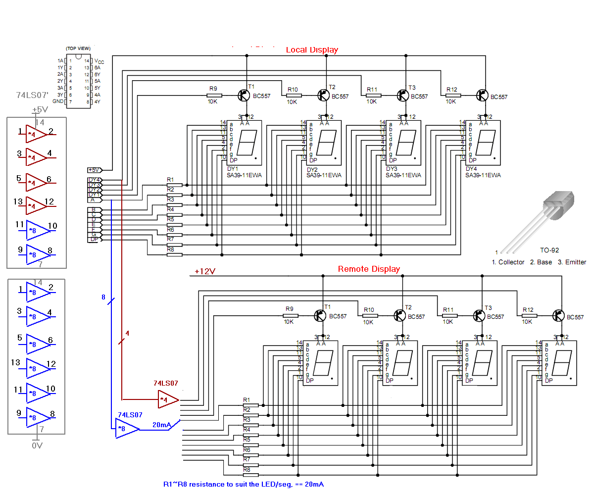

Here is my way of driving large 7-segment LEDs. The MosFets are a bit overkill, but work well for any size display.
LED current is 700mA.

This is the first time you have given the LED's as being 'high power' I was under the impression they where going to 'ultra bright', about 30mA.!
BTW: there is an important difference between 7407 and 74LS07 devices.
To cope with the 800mA load I would suggest N MOSFET's on the segment outputs and either P MOSFET's or pnp Darlington transistors on the digit drivers of the 74LS06's NB: this is now an inverting buffer.
the following mods are for:
Boncuk drawing as starting point.
A 74LS04 should be used between the ULN inputs and the PIC, this is to give a double inversion of the seg driver signal.
IIUC the digit drivers will also need inversion before the BS170's

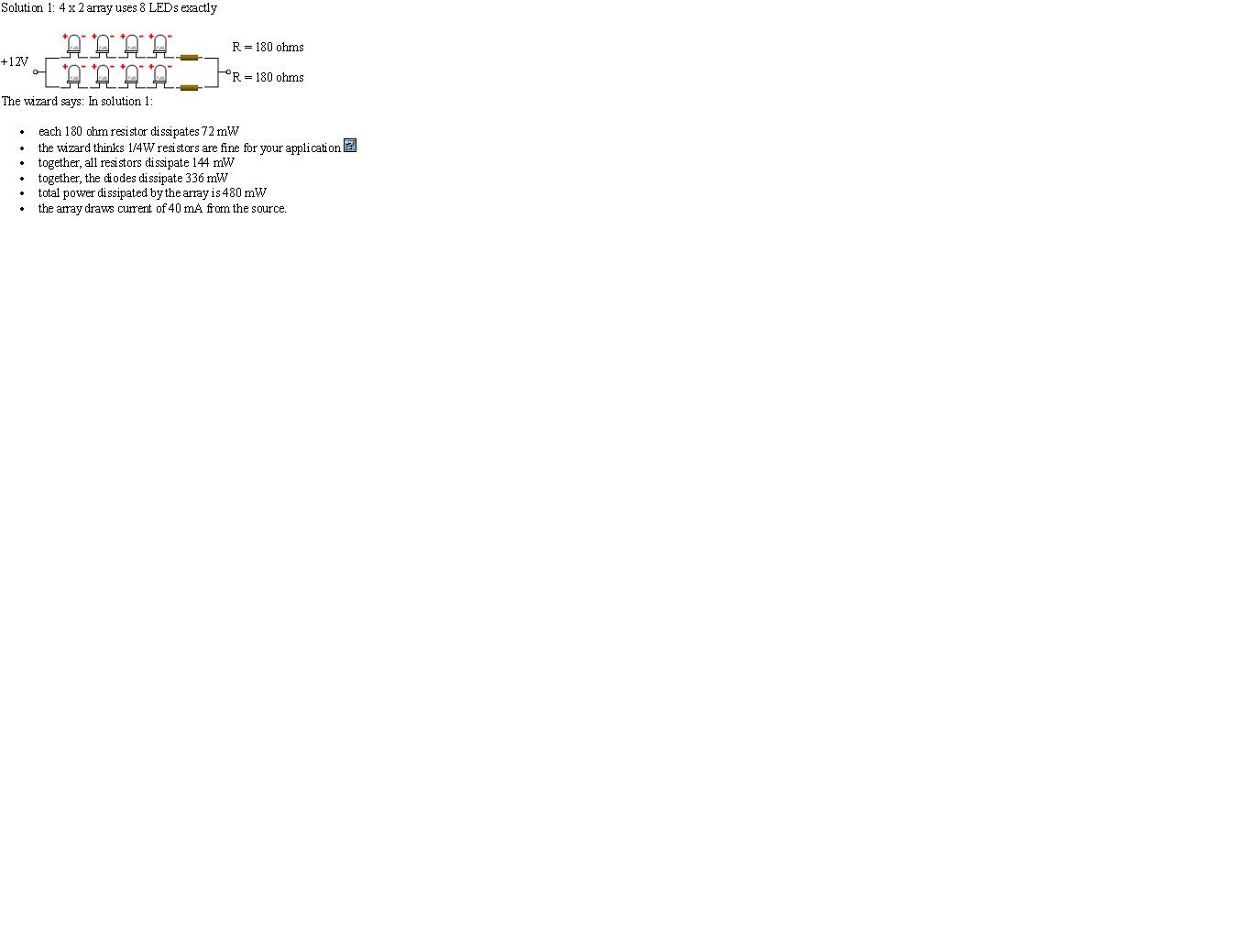

Sorry about the confusion on the segment displays. Here is what I found for the array per segment. The counter display will have 4 x 7 segment displays showing(min:secs). The 10" displays will be homemade with each segment consisting of 8 leds. The specs for the indvidual leds is 20ma forward current & Vf of 1.5v. I used a led wizard program and it showed that each segment array would use 40ma. There is an attached pic from led wizard. So if all 4 segments of each display are on it would use 160ma, not 800ma like I originally thought. My bad. So since that is the case, would the last drawing from Boncuk be ok as is or does it still need modification? Thank for baring with me.
Hi Eric,
Sorry about the confusion on the segment displays. Here is what I found for the array per segment. The counter display will have 4 x 7 segment displays showing(min:secs). The 10" displays will be homemade with each segment consisting of 8 leds. The specs for the indvidual leds is 20ma forward current & Vf of 1.5v. I used a led wizard program and it showed that each segment array would use 40ma. There is an attached pic from led wizard. So if all 4 segments of each display are on it would use 160ma, not 800ma like I originally thought. My bad. So since that is the case, would the last drawing from Bancuk be ok as is or does it still need modification? Thank for baring with me.
The current of 200mAish is more realistic. Are you sure about the 1.5V forward drop.?

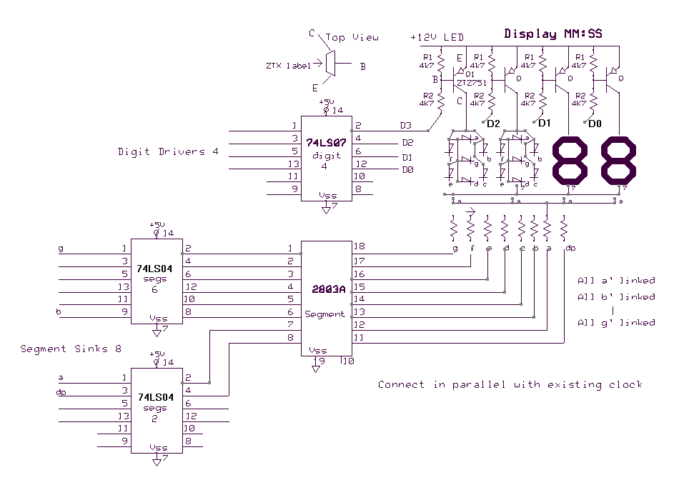

I will modify one of my earlier clock circuits and post it tomorrow.:)
hi djv.
Have a look over this.
It was a 6 digit clock, chopped to 4 digit. OK.?:)
If you can get a HEF40098 i/c, the two 74LS04 could be replaced by one ic.

That looks pretty awesome.
I have plenty of 74ls04 chips so that will work.
My question is the ZTZ751 PNP transistor the same as a Farichild MPS751?
The specs are here https://www.electro-tech-online.com/custompdfs/2009/01/mps751.pdf
I believe it has enough (ummph) to handle the application.

Hi Eric,
That looks awsome.
I have a lot of 74ls04 ic's laying around. I do have a question about the ZTZ751 PNPs. I cant find them anywhere. The closest I could find was a spec sheet on a Fairchild MPS751, but I cant locate that chip anywhere. Is there another PNP transistor I could use?

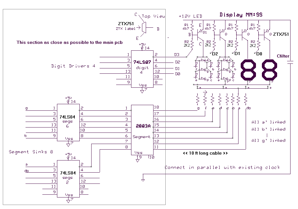

Thats a typo it should read ZTX751. Can you get this.?
The MPS751 collector current is too low.
You require a current of approx 500mA min at a gain of 100.
Corrected the drawing, Iss2
EDIT: what power supply will you be using for this remote display. ?
