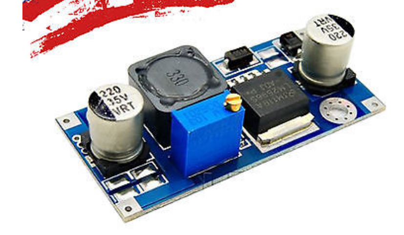

Where I used to work, the technician would secure trimmer pots in position with a drop of nail polish. This kept the adjustment in position, yet still allowed it to be adjusted in the future.
In high-vibration applications do you think this is necessary? I'm using DC-DC converters like the one pictured, and a change in voltage will either interfere with operation or damage the connected circuits.
Is there a better choice than nail polish for this? Acrylic paint would probably work as well. A nice dot of red nail polish is a quick way to see the pot has been adjusted!

I thought you did not need to lock them at all since they are worm gears which are high friction and can't be back driven? No experience with this though, so educate me.
I agree with the above: but if you're really determined, how about a blob of hot-melt glue?

10 turn pots are usually not going to drift with vibration, at least the small ones, and usually the panel mount ones that can be moved by vibration, usually have a dial lock on the indicator/knob assembly (looks like a combination lock type of knob). sometimes people put 10 or 20 turn panel mount pots in to replace single-turn controls, so that's when you might not have a multi-turn pot locked down in some way (there used to be a bunch of SSB CB radio mods that used a 10 or 20 turn pot on the clarifier knob in place of the original single turn pot). usually, glue or paint on the little trimpots is there to tell whether somebody has tried to adjust it.

Threadlock compounds are most damaging to styrene containing plastic (EPS/Styrofoam, polystyrene, ABS, ...) and less so on acrylics but will still make clear plexiglas cloudy (as will Superglue) unless it is 100% solvent free (foam safe and or "plastic safe").
They don't bother polypropylene or HDPE (as used on the Bourne trim pots shown in post 1).
