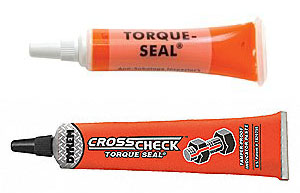

In the past, we used to use "Torque Seal" for locking pots.
But, the rights to that product were sold to Dykem a while back and their product is called "Cross Check".
Same stuff as used on critical bolts in aircraft structures. It is not to "lock" something, however. It is used to see if the bolt/nut has turned since it was torqued, or if it has moved (or been moved) since the last inspection.
I get that. You can use it in the same tamper-evident context with a pot... and for something with a small mass like a control screw on a pot, it does act as a locking agent. Both of those reasons are why we used it.
Not exactly on all plastics. A dab on the brass screw and the blue body of the trimmer will get you a dab of your marking dot that bonds well to the brass but may easily slide off of the slick (difficult-to-bond-to HDPE or PP) as thetrimmer s turned ad the strength of the marking pigment film strength making it look untampered.
