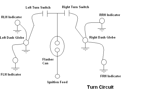

I have a 1973 Shovelhead Harley, which I have recently restored with new wiring and hand controls.
The left and right turn indicator switches are momentary contact (meaning I have to keep pressing the switch WHILE I am cornering....a major pain.) Each switch has a wire going to a flasher can and a wire going to a dash light.
I have seen a bike similar to mine where the momentary contact switch "triggers" the flashing of the indicators, and a second press turns them off again. I asked how it was done and was told that it involved a proprietary Harley "little box" and $300!
Is it possible to achieve this with common electronic parts. How much techno-savvy does one need to do it?
Any help would be appreciated.

Those relays are not alternate acting, as he wants. They have either one coil, which requires an opposite polarity on the coil to alternate the contacts, or two coils, which requires a pulse to one or the other of the coils.
I'm not clear on the existing layout.
I am guessing that there is a single wire which activates the left turn signal and left dash light .... and also a single wire for the right turn signal and dash light.
You would probably find each of these control wires in the vicinity of the handlebar momentary switches.
So you would need to have a latching relay of some sort for the left and the right sides. ....One separate relay for each side .... two altogether.
If I understand correctly, the flasher can has two different connectors, one for the left side and one for the right side.
Is this correct?
With a Shovelhead Harley just look mean when turning. Know one would dare hit a mean looking biker
If you could draw a wiring diagram or sketch, showing the handlebar switches, the flasher can, and which wires have voltage, wire color, the lights themselves, and anything else useful, it would help to come up with something that would work.
Make one sketch with the existing wiring, and a separate sketch with what you want.
If you don't have a scanner, try the Windows Paint program or something similar, save the sketch as a jpeg file, and post in a message.
It is important to have a good idea of what the parts and layout are before you
try to add something to a circuit.

Attached is a simple circuit for my Harley indicators. I hope it helps.
