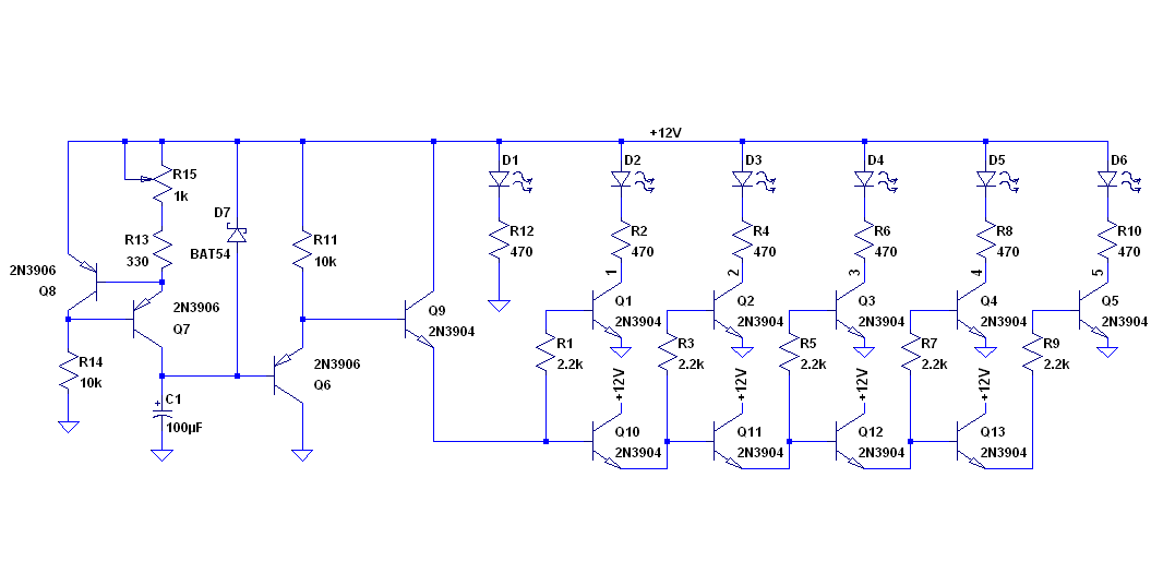

motorbike led turn indicator for rear view mirror
hmmm
this i have to see.if the front and back lamps are connected in parallel then it will the good for me.i can connect this circuit in parallel.
if they are in series then i shld think what to do.
By the way according to my analysis this circuit will not work. Well try it and lets see the result. I waiting for it.

give me some time guys.i got all of the components(with exact zener ratings).tomorrow i'll populate then and wll post the results.

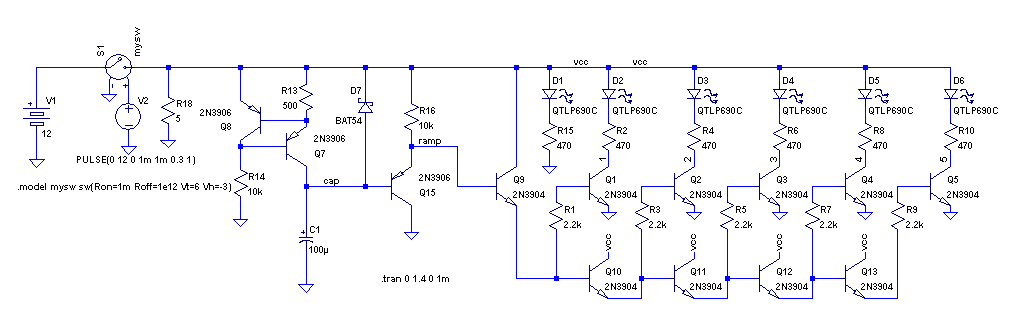

It will be difficult to get even time separation for the LED turn-ons if you try to use zeners. The exponential nature of the cap charge, combined with the ever increasing load as the zeners conduct, exacerbates this problem. if you want to pursue an all-discrete solution, you can use a current source to charge the cap, buffer it with an emitter follower, and use cascaded emitter followers (or diodes) for the level shifting. Emitter followers seemed to have slightly better linearity in the simulation. I have posted a schematic below.

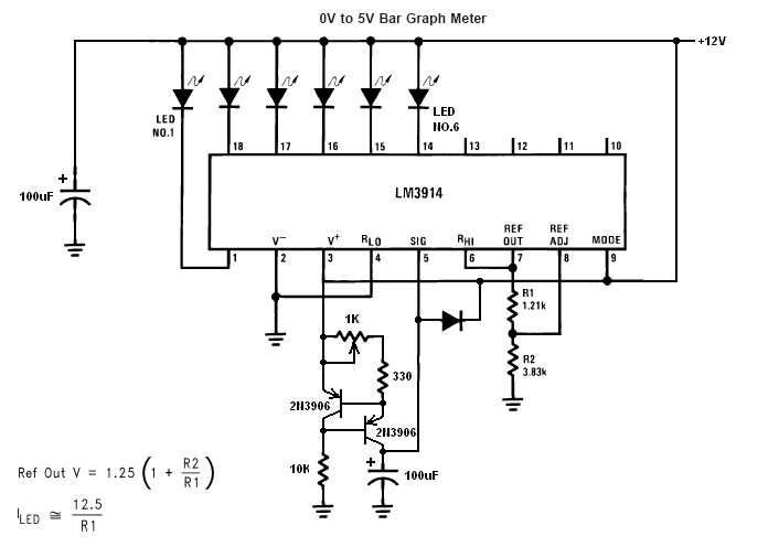

I think that an LM3914 would be simpler, if the all-analog solution is to be pursued. I have posted a possible solution below, which has not been tested or simulated.
A 555 and a 5- or 6-bit shift register, or a 555 with a binary counter and some decoding logic, is also a possibility. A PIC would certainly be simpler from a hardware point of view, except that it requires a voltage regulator. Any digital solution would have to deal with the noisy power supply of a vehicle. The analog solutions have an advantage in this respect.

i populated the circuit on pcb board,it worked but not similar in all the times.when the engine is at a particular RPM they LIT fast and the RPM is low they lit slow.
may be this is what "roff" said.
@roff
ur LM3914 circuit looks good.but i don't understand how the cycle starts and ends.is it gona give me the exact pattern?imean 1+2+3+4+5.....
Try to regulate th voltage by putting a 12V zener at the supply with a 100ohm resistor in series. It will maintain the voltage stable

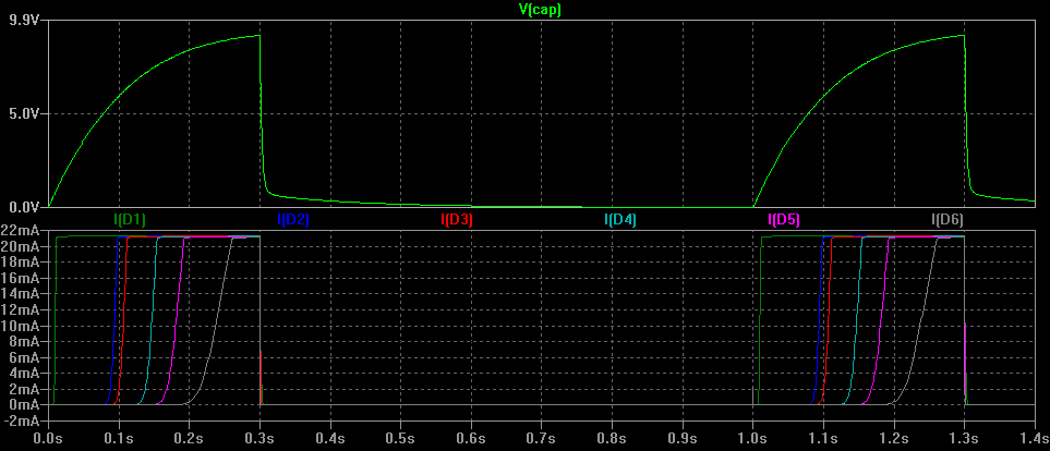

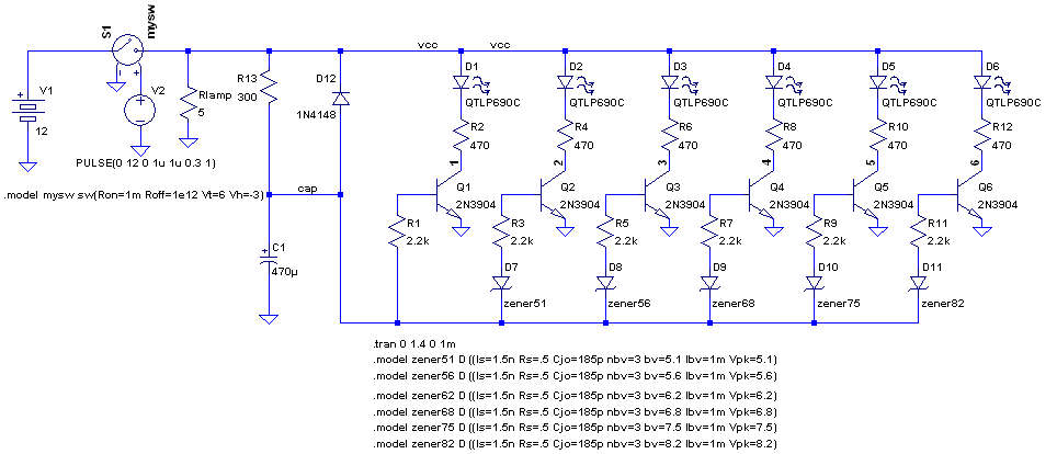

Here is the simulation of Ferreira's circuit. I tweaked the value of R13 to give the best spacing I could achieve. I also had to guess at the pulse width and duty cycle of the turn signal "relay".
I have attached the LTspice file in case someone wants to run the simulation.

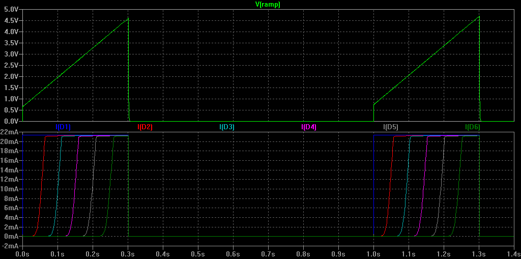

Here is the simulation of the modifications I proposed.

The only way to tune each led would be using 5 voltage deviding trimmers and the same value zener for all the nodes. This way you could set the trigger voltage of each node.

It should do what you want, and it will run the same sequence each time the power comes on.

The emitter followers (or diodes) and the current source solves that problem.
