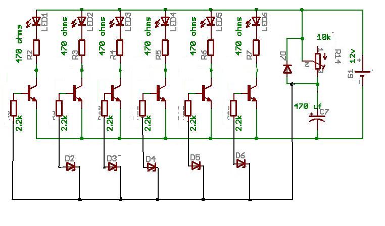

i made a circuit diagram based on what u explained.pls have a look
the two points that i don't understand is
1.Connect the cathodes of these zeners together with the base resistor of the 1º tr
2.Now connect the "base node" to the capacitor, trimmer, diode junction
am i missing something.pls correct the above pic if required.
guys pls give me some rough diagram(paint brush) so that i can understand better.
It means there is aproblem with the timer cicuit. Which 555 are u using? what is the value of the resistor and capacitor in 555 what is the time constant? are u running ur circuit on 5v or 12v? are u using the voltage regulator?
You should adapt R2 to R7 to the led current and test different zener voltages to suit the correct lightup sequence. I think this a plain and simple circuit that is immune to all electric "noise" in a motorbike power supply
are u saying that this circuit is giving u the sequence u want? or u want this circuit to be altered to give u the sequence u want
It will ramp from 1 led on to all in a speed adjusted by the VR, and the step is determined by the different zener diodes. As the capacitor charges when it reaches the zener vlotage + 0,7V from the junction it switches that led, then the next and so on.

This circuit is not suitable for you. cause you need a circuit that will repeat the same sequence after all leds have glown. but this circuit will stuck after all leds have glown ..
Don't forget that it is connected to the turn-signal lamp. on-led sequence, off-leds off, on- led sequence and so on

i'll be connecting the circuit to the turn indicator lamp.as helder said the supply to the turn signal will be 12v and on-off-on-off type,as this will be driven by a relay.
so as per helder circuit LED's will glow in sequence of 1+2+3+4+5+6 and these all will stay until i rest the power(that means OFF condition of the turn signal).and again when the signal is in ON condition again the sequence will start.
am i right helder.

iam using the circuit as it is posted in the above link.mean while helder circuit seems work simple and fine.today i bought the components i'll try to populate and see the results.
Turn indicators have 2 lamps, one in the front and one in the rear. He can replace the front lamp by this circuit and it will work fine.
