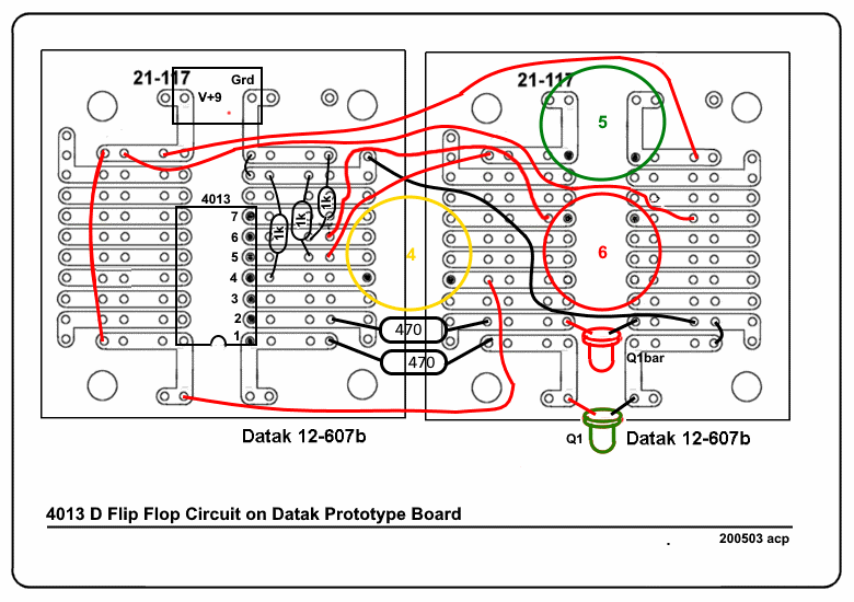

Finally e-tech
In post #4 some excellent info was shared on the flip flop operation.
especially
What I described earlier is a DFF wired as a "toggle" FF.
The image in post #3 shows the DFF wired as a "Set/Reset" FF.
When wired this way, the D pin is always connected to logic "high".
The SR FF is toggled using only the Set and Reset pins and the "clock' pin is not used.
The Set pin makes Q high and Qbar low. The Reset pin makes Qbar high and Q low.
Reset overrides the Set pin.
The schematic in post #3 comes from
It was hoped that, using schematic in post #3, a better understanding
of how the circuit works could be gained by building the circuit.

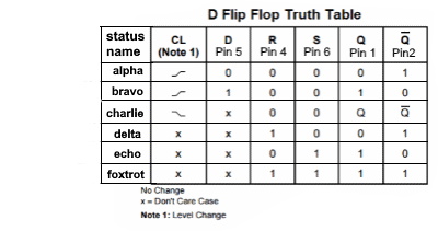

Here is what observed:
1. When the circuit is powered Q always comes on. The only
outcome on the Truth Table that fits with that is
Data is 1, Reset is 0, Set is 0, then Q is 1, Qbar is 0
Have scoured the data sheet for the flip flop
Flip Flop 4013 D datasheet
and cannot get what the power on status is because the state
described above does not fit e-tech's
DFF's are usually initialized to a known state at power on.
This is usually done by momentarily applying a logic "high" to either the Set or Reset pin.
But it is the only thing that seems to make sense from the Truth Table.
2. Immediately after power on, with Q on, pressing Set (pin6)
or Data (pin5) does nothing but pressing Reset (pin4) turns off
Q and turns on Qbar.
3. With Qbar on, pressing Set (pin6) turns off Qbar and turns on
Q. This is the operation which is most easily and reliably
reproducible: With Qbar on and Q off pressing pressing Set (pin6)
turns off Qbar and turns on Q.
And conversely, With Q on and Qbar off pressing Reset (pin4)
turns Q off and Qbar on.
And so it is possible to toggle between
3a. Q on and Qbar off to Q off and Qbar on (press pin4)
and
3b. Q off and Qbar on to Q on and Qbar off (press pin6)
This would seems to be consistent with status name Delta.
That is, pressing Reset (pin4) turns Q off and Qbar on.
Similarly pressing Set (pin6 seems to create status Echo.
That is, pressing Set turns Q on and Qbar off.
4. The operation of Data (pin5) is not as forth coming.
Sometimes, but not reliably, with Q on and Qbar off,
Reset (pin4) is pressed which, as is indicated in 3a.
above, turns Q off and Qbar on. Then pressing Reset
and second time and then pressing Data (pin5)the
state toggles Q on and Qbar off.
Not sure what is happening here
5. In status name Foxtrot both Q and Qbar are on.
I have pressed the momentary switches in every
conceivable combination and cannot get both
Q abd Qbar to be on. Is that possible with
the citcuit? If so how?
Thanks.
Allen in Dallas

That is because you have left the clock "floating". The clock input is now in an "unknown" state.
First rule of using cmos chips is never leave inputs floating. If an input pin is not connected, then pull it either high or low but do not leave it floating.
In this case you've left the clock pin floating. A rising edge or spurious noise will trigger the flip flop. So pull it down for testing purposes.
You have not initialized the chip to that specific state, It just happens to match the entry in the table. This means the next time it is powered up it may end up in a different state. Like I said, you need to initialize the chip to the desired power up state
First, please read about switch de-bouncing.
Second, please carefully re-review the logic table on the data sheet.
The Q output is already high, If you read the logic table, a high on the set pin will set Q high. So why would you expect it to change?
The other pins are doing what thay are supposed to do. That is shown in the logic table on the data sheet
The S/R pins immediate force the state of the Q/Qbar pins respectively. But Reset overrides Set.
The D pin only comes into play when triggering the FF with the clock input. Its state is transferred to the Q or Qbar
and
That is correct.
The D pin only comes into play when triggering the FF with the Clock pin.
The S or R pin take precedence over the clock pin. The R pin takes precedence over the S pin.
I think that is an error in the truth table. The Q and Qbar are complements of each other, so both can't be high or low at the same time.
At least I've never seen a good DFF one work that way.
One thing you are probably struggling with is noise on the circuit. CMOS chips should have bypass cap across its supply pins as well as debounce circuits at the input pins. Your schematic shows resistors but that usually is not enough. Without these, noise can cause false triggering of inputs causing erratic circuit behavior.
BTW- you are experimenting with a D FF but that doesn't mean you have to use the D and Clock pins. The DFF is a flexible device. You can use it as a Set/Reset flip flop and just pull the D and Clock pins permanently low.

- CMOS chips should have bypass cap across its supply pins as well as debounce circuits at the input pins. Will also research how to include by pass capacitors at the supply pins and reissue the schematic.
- The D pin only comes into play when triggering the FF with the Clock pin.
- The S or R pin take precedence over the clock pin. The R pin takes precedence over the S pin.
- Use the DFF as a Set/Reset flip flop and just pull the D and Clock pins permanently low.
