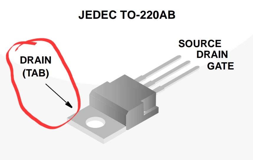

I want to attach all 8 tabs to the circuit board as heat sink but can I attach all 8 on together on the circuit board?

● When I posted my answer, the only information given was "N channel MOSFETs in a TO-220 package".
● This picture, from an IR datasheet which I posted originally, shows a schematic symbol with D, G and S identified without pin numbers and a picture of the package without pins being identified in any way.
● Your claim that a TO-220 AB package has nothing connected to the tab is absolutely false as the picture posted immediately prior to your second outburst, which is from the F12N101 datasheet, shows the tab connected to the drain in a TO-220 AB package.
If you had actually answered MrDEB's question, instead of attacking me, the drains of all the MOSFETs would be connected together....and a wasteskd circuit board would have been the result. Fortunately(?), you seem to prefer arguing than answering questions, so no harm done.

You make the erroneous claim that the tab is isolated in a TO-22O AB package. Please open your eyes, use whatever vision-assit aid you need, and look at the picture in post #24, which if from the datasheet for one of the MOSFETs MrDEB has.

And based on the datasheets' confirmation that both transistors are using TO-220AB style packages (AB suffix means only the three leads are connected - the thermal Tab is not electrically connected) - which means you can connect all of your transistors together without a problem.

Just in case you missed it. JEDEC TO-220 AB.
Those TO220AB parts don't meet the standard.
I am so utterly pleased to call you out on your bovine excrement. Delighted really.
Digikey lists 926 N channel MOSFETs in TO-220 packages. Of those NINE HUNDRED TWENTY SIX, EXACTLY TWO have ISOLATED TABS.
TWO out of 926. 0.22% have isolated tabs.
