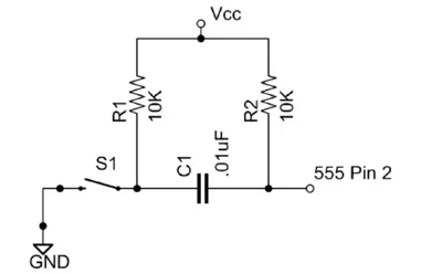

Hi, I apologize if this is elsewhere or out of place, but I've been out of diy circuitry for decades. I need a simple circuit, maybe a 555??, to output 12vdc for maybe 3 or 4 seconds when triggered by 12vdc, and then stay off until the trigger voltage is recycled off and back on again. Output would be very low current, only enough for a small LED. I can no longer figure out how to do this. Ideas? Thanks, Jay

I'm not a 555-solves-all-problems guy, but in this case the datasheet monostable circuit will. With a bipolar 555 and a 12 V rail, the output will be approx. 10.5 V. Add this circuit to the Trigger input to extract only the negative edge of the input signal.
C1-R2 form a differentiator circuit. Because R2 is tied to Vcc, the Trigger pin rests high. when the switch is closed (or whatever is driving this goes low), the right side of C1 goes low and triggers the 555. R2 immediately starts to charge up C1, teturning the Trigger input high in approx. (R2 x C1) seconds. With the values shown, that is 10 microseconds. The circuit can sit there forever and the 555 will not retrigger. When the switch opens or the input signal goes high, the left side of C1 goes high. But the right side of C1 already is high, so nothing happens and everything sits. When the input goes low again, the 555 cycles again.
