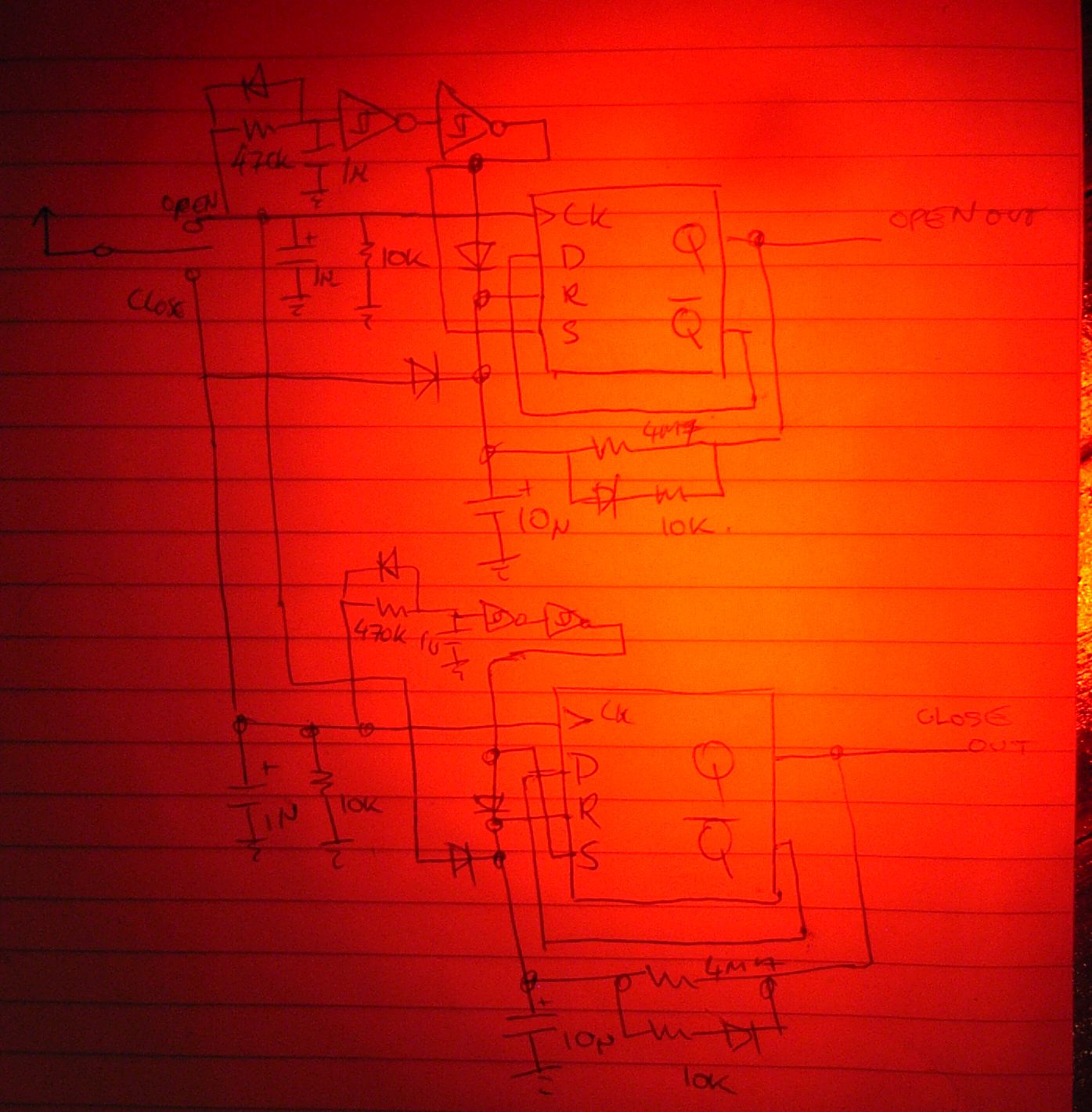

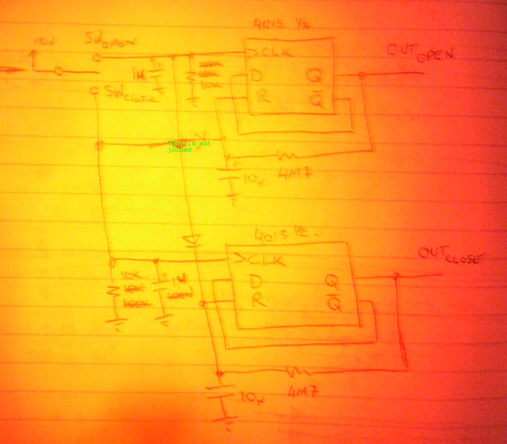

If you're happy with the following functionality, a simple 4013 circuit can be used.
* Tapping the OPEN switch will toggle the self-resetting (35 seconds) OPEN flipflop and reset the CLOSE flipflop. The OPEN flipflop output drives the OPEN output.
* Tapping the CLOSE switch will toggle the self-resetting (35 seconds) CLOSE flipflop and reset the OPEN flipflop. The CLOSE flipflop output drives the CLOSE output.
If you want the HOLD = MANUAL CONTROL and TAP = AUTO CONTROL that KeepItSimpleStupid wrote of, the second more complex circuit should do it. It is the same as the above , except for the following:
* Holding the OPEN switch > 1 second disables the OPEN flipflop, but keeps the OPEN output on until the OPEN switch is released.
* Holding the CLOSE switch > 1 second disables the CLOSE flipflop, but keeps the CLOSE output on until the CLOSE switch is released.

I have had a chance now to look at your circuit, which has prompted me to look at and understand how a 4013 operates. I have a couple of questions:
When power is first applied to the circuit and neither the up or down toggle switch has been activated, what is the state of the outputs? Are both Q and /Q low?
If I understand your description and the circuit, each subsequent press of the toggle in the same direction (e.g. 2 presses up) will toggle the Q and /Q outputs between high and low. Is that correct? Ifso, this provides the ability to interupt the timed sequence in either direction of the roof without sending the roof back in the other direction.
For the inverting buffers in the second version, would a 4069 be suitable?
The output current of the 4013 is insufficient to drive a relay. Is that correct? I expect I would just need to insert an NPN transistor between the power supply and the output signal to drive a relay?
I do have trouble reading your sketches in terms of the capacitor values - having trouble working out what is a "U" and what is an "n". If they are all "U" (microfarads) then I should be fine.
Q & /Q will be in opposite - but unknown (oops) - states.
That's the plan.
I'd recommend an inverting gate with a schmitt trigger input, e.g. 40106, 74C14 or 4093.
That's right. The transistor will work too. Remember to put a flyback/freewheel diode across the relay coil to protect the transistor.
Yeah, sorry; they're all 'u's.
I have looked at the same table from elsewhere but struggle to understand which state corresponds with initial power up. In the circuit, /Q is tied to D, so value of D depends on value of /Q - which one is determined first?
It could be anything. Sorry for the oversight. Simply connect the 10uF cap between supply+ and the R pin instead of to gnd. And the first circuit should have the series 10k and diode in parallel with the 4M7 resistor, as per the second circuit or else the outputs will be disabled for 30seconds.
Input S is not used in the simpler circuit, so do I presume this is tied to 0 volts (?).
yes
Input R is initially low, so got that one sorted.
It will be initially high once you switch the 10u cap connections thus providing a known powerup state.
Those combinations of inputs (CLK = X, D = X, R = 0, S = 0) don't align with any of the options in the table
For that state, the outputs don't change. If CLK changes, the outputs will reflect the D input.
Obviously what I want on start up is Q = 0.
The 10u cap from the +ve supply to R will do that.

Just so I understand what is happening on the reset input, by changing the 10uf cap to connect to ground:
On start up is it taken high as the cap rapidly charges up
This sets Q low
Does the cap then discharge through Q until it goes low (but this does not change the state of the outputs)
If Clk is pulsed positive, Q goes high and the reset cap starts to charge via the RC network until it goes high again and turns Q off?
It shouldn't connect to ground but to the supply positive
On start up is it taken high as the cap rapidly charges up; This sets Q low
Yep, the Reset input is taken high on startup
Yes. The use of the 10k and the diode make the discharge time quite quick.
That's correct. The reason that the RC is there is so that the relay turns off after 30 seconds or so; otherwise it would stay on until you toggled it off manually.
