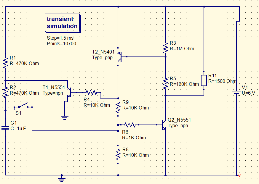

I have this circuit for press-on-press-off. it is working with a resistor (and led) as R11=1500ohm.
1. How can i change the circuit if i replace the R11 from 1500ohm to 8 ohm?
2. the press-on-press-off works only in low frequency, how can i change the capacitor or other part to work on higher rate.(twice)
smaller c1. you can also make r8, r2 and r1 smaller but that might affect other things.
If you reduce R11 to 8 ohms, the current through Q2 will be 0.75A, so Q2 will need to be a transistor that can carry at least 1A (the 2N5551 has a maximum of 600mA).
You will then need to reduce Q2's base resistance consisting of R6, R8, and R9 to provide at least 50 mA to the base of Q2.
Alternately you could change Q2 to a logic-level type N-MOSFET (maximum Vgs threshold <=2V) with the gate connected directly to the collector of T2.
The 2N5551 is not suitable to drive 8 Ohms with 6V with this circuit and even if all the base drive R's were reduced it is still not suitable for any current > 100mA for heat and insufficient current gain reasons. However a bigger Logic level NFET could work.
However a much simpler design can be made from a D flip flop with clock RC pulse input and feedback from Qbar to D input. then driving a FET from either output.
