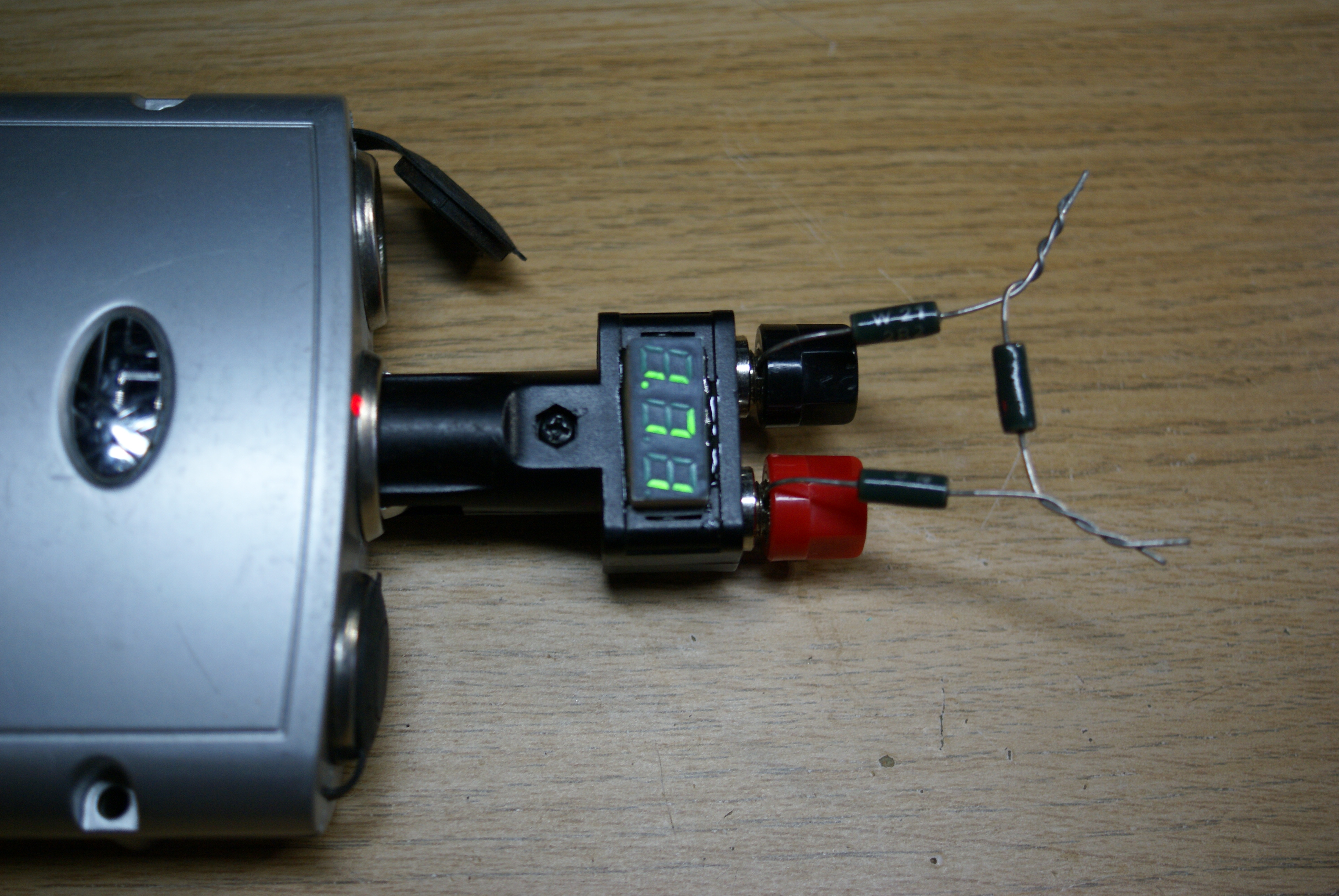

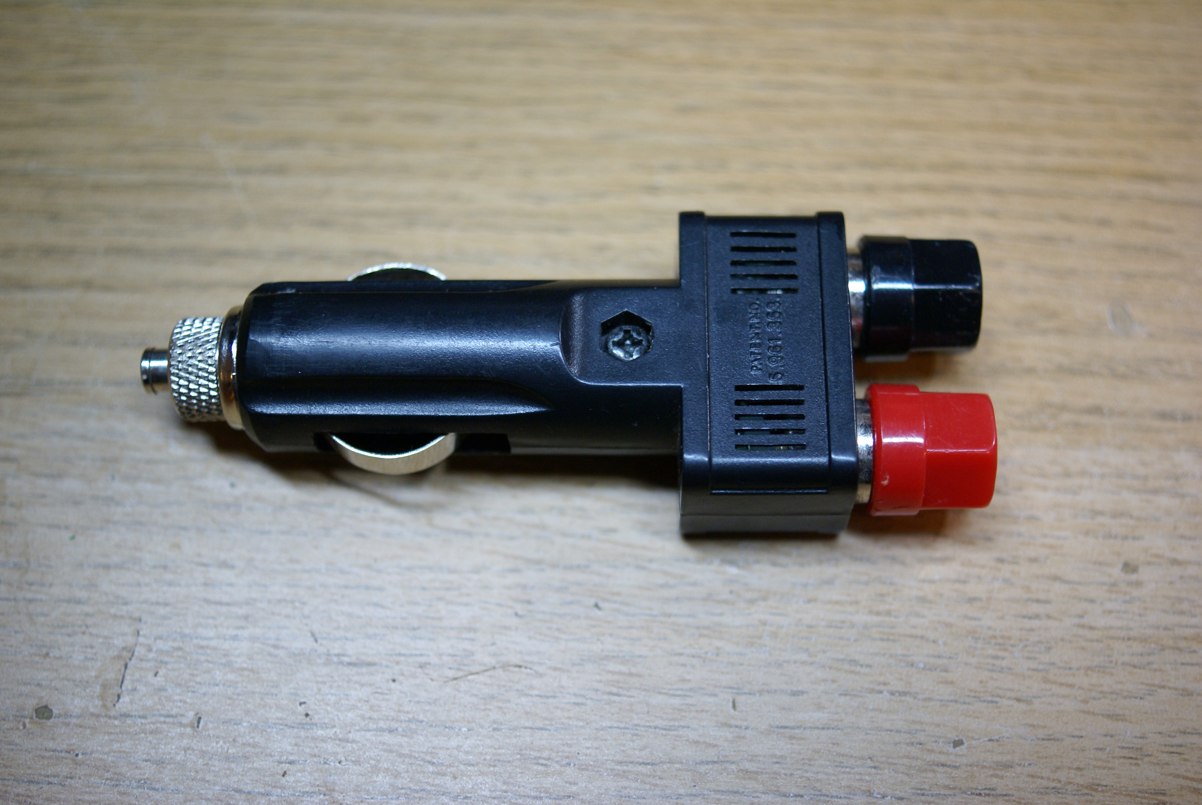

I've found these car adaptors useful:-
and I've modified one with a voltmeter on one side and an ammeter on the other.

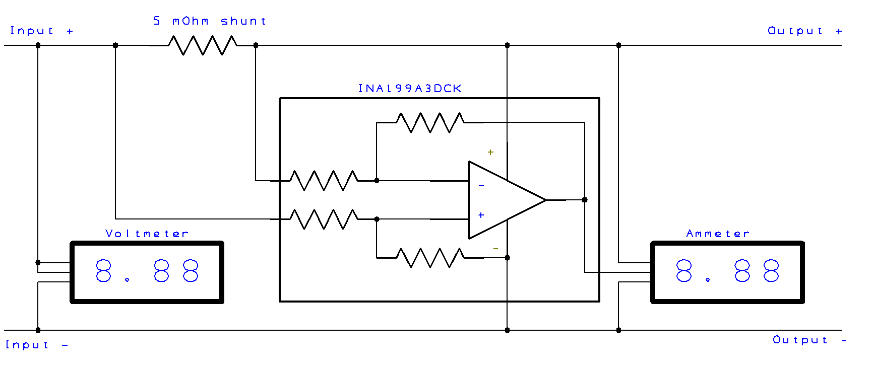

To measure the current, I used one these:- https://uk.farnell.com/ohmite/lvk25r005fer/current-sense-res-0r005-1-2-w/dp/1462326 to sense the current and one of these https://uk.farnell.com/texas-instruments/ina199a3dckr/current-sense-amplifier-14khz/dp/3118145 to amplify the voltage. The output of the amplifier connects directly to the voltage input of the current meter.
Here is the circuit:-

The circuit has been modified slightly. There's a diode feeding the INA199A3DCKR and a 10 nF capacitor between it's positive and negative supplies. The amplifier and the two displays are fed from the input, so it's only the output current that is measured.
