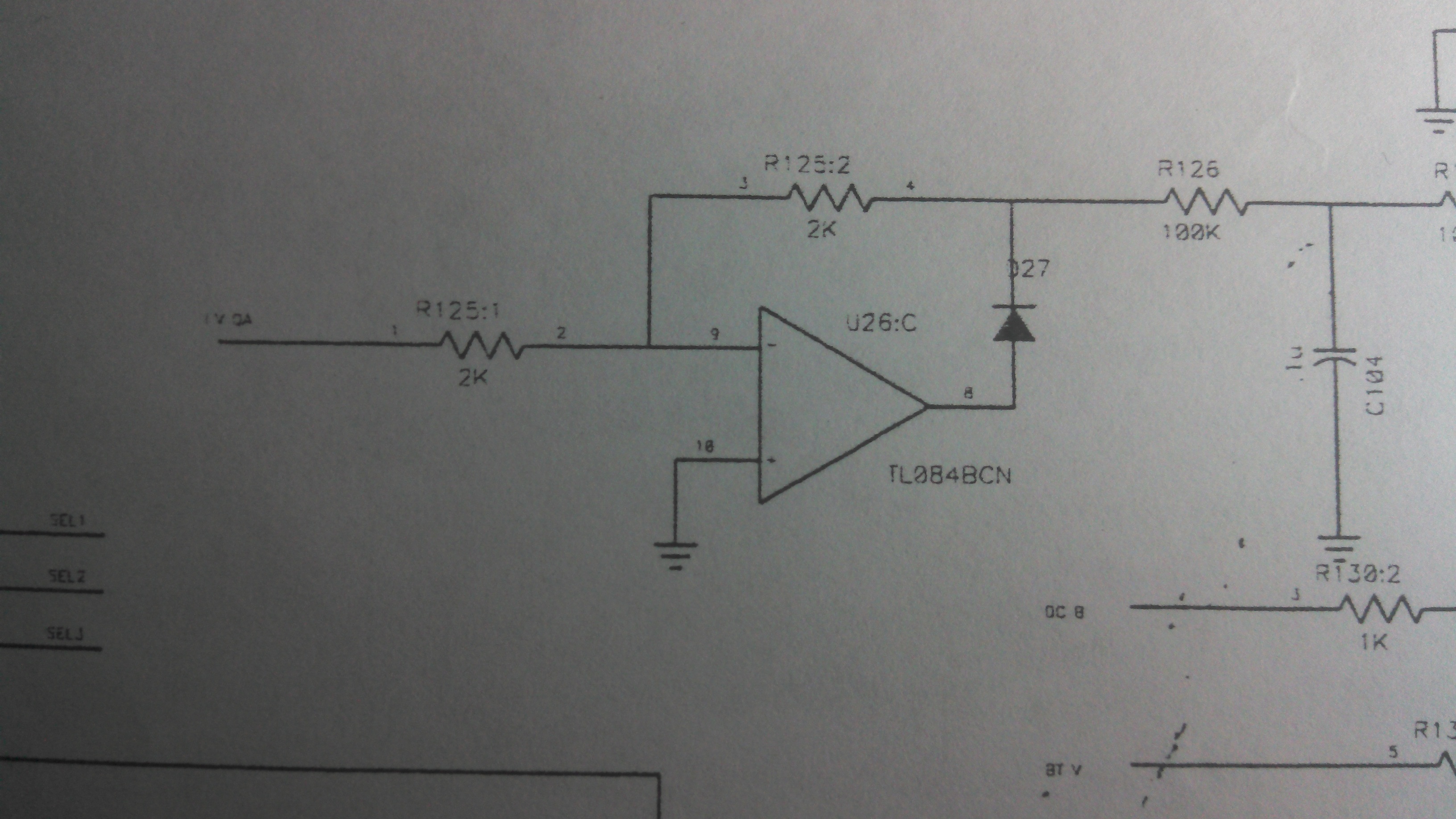

Op-Amp Detector, What does it do ?

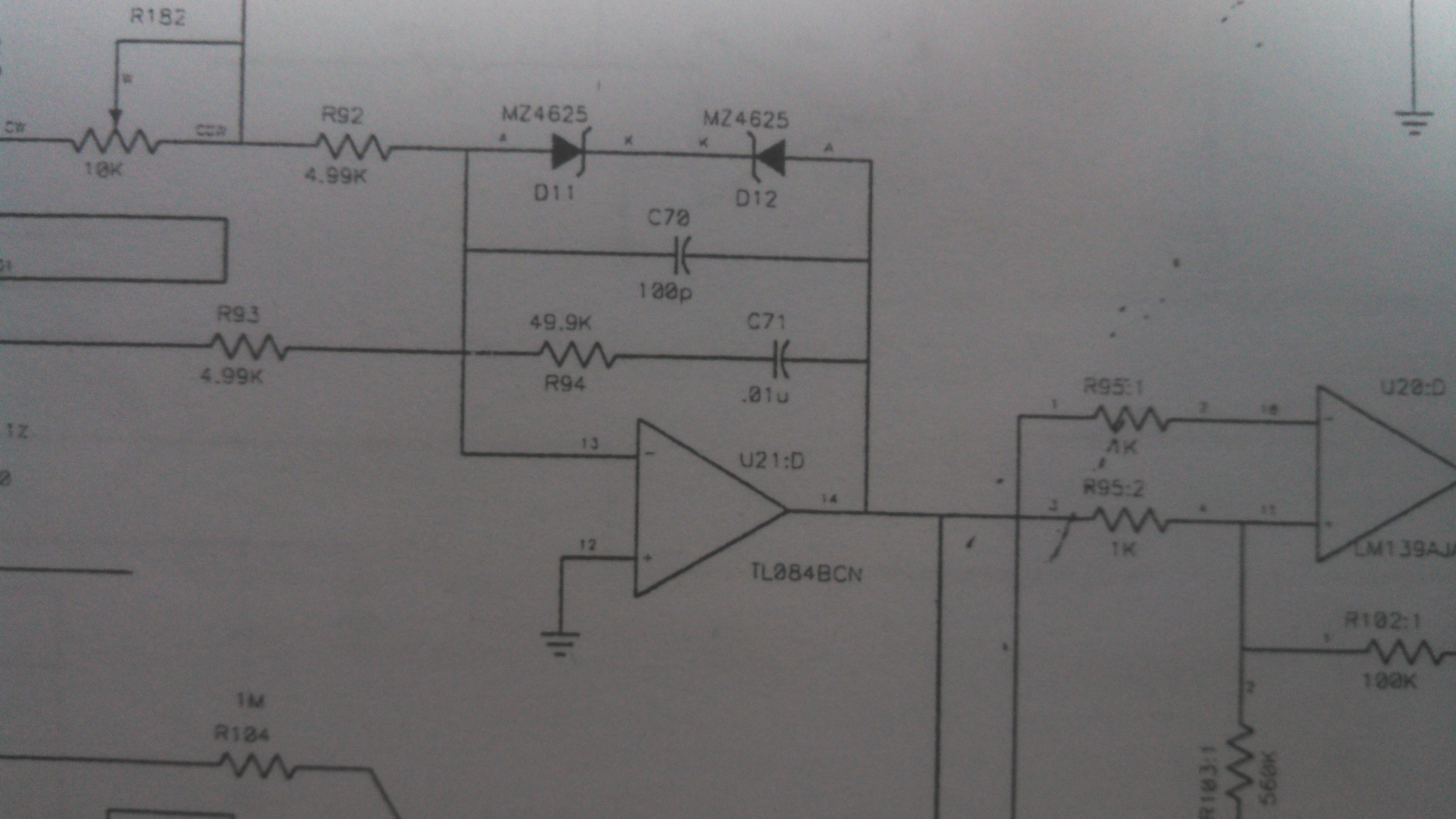

Here is an RC network in the feedback section of an op-amp , what does it do?

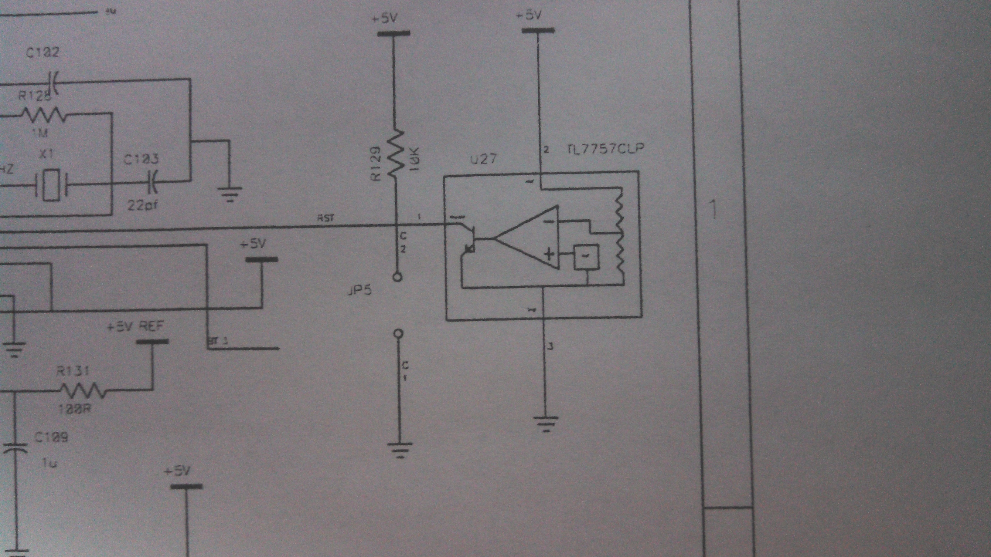

This IC voltage Detector, goes direct to the Micro-controllers RESET pin, what does the IC voltage detector do? once the VCC is to low it Resets the Micro-controller?
If there is a short and the VCC is low all the time , it's just going to keep Resetting the Microcontroller right?

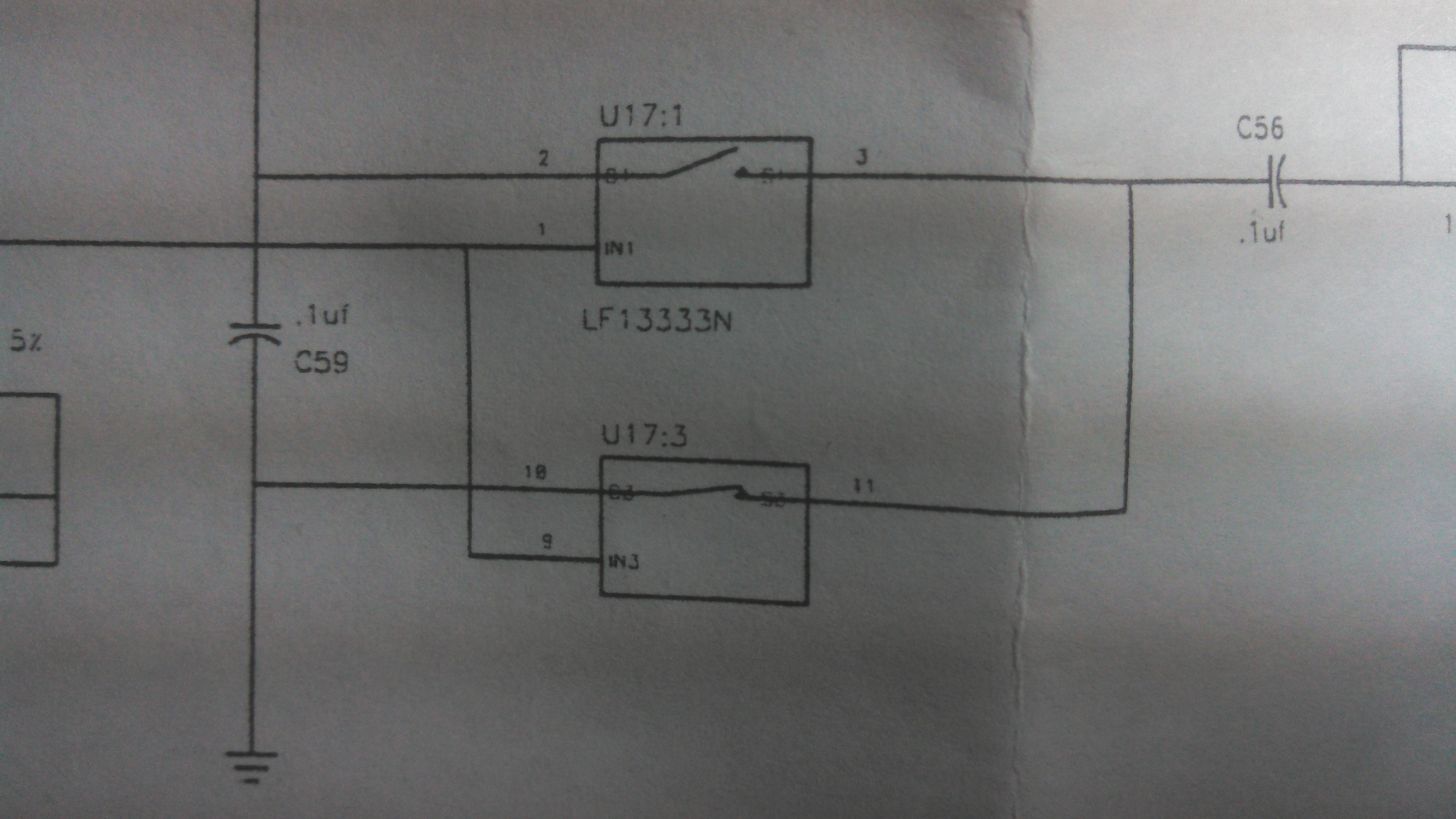

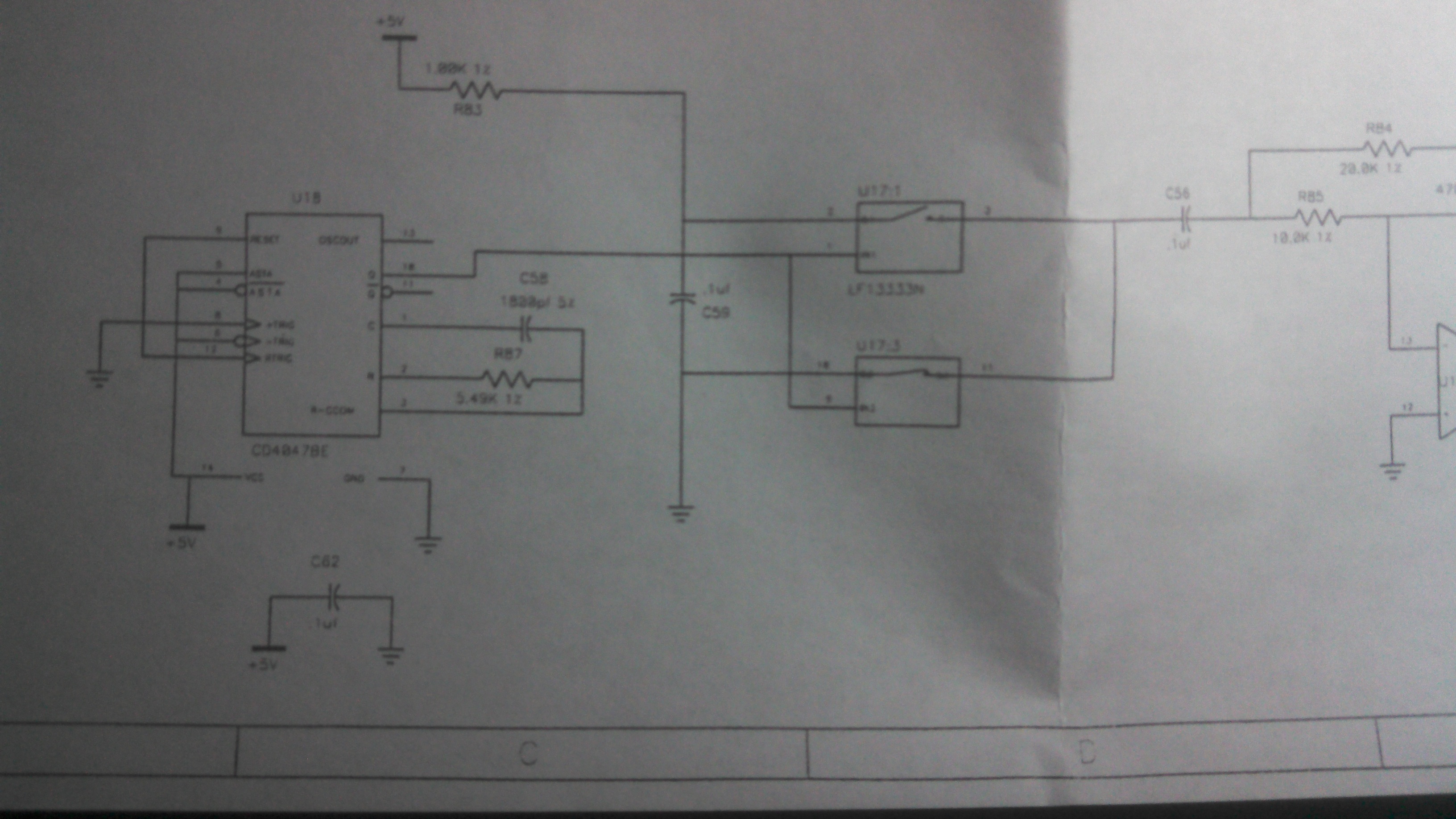

What does these LF13333N Switches do?
When they have an square waveform on the input pin of a LF13333N the output of the LF13333N switch changes the Amplitude of the square waveform i have noticed

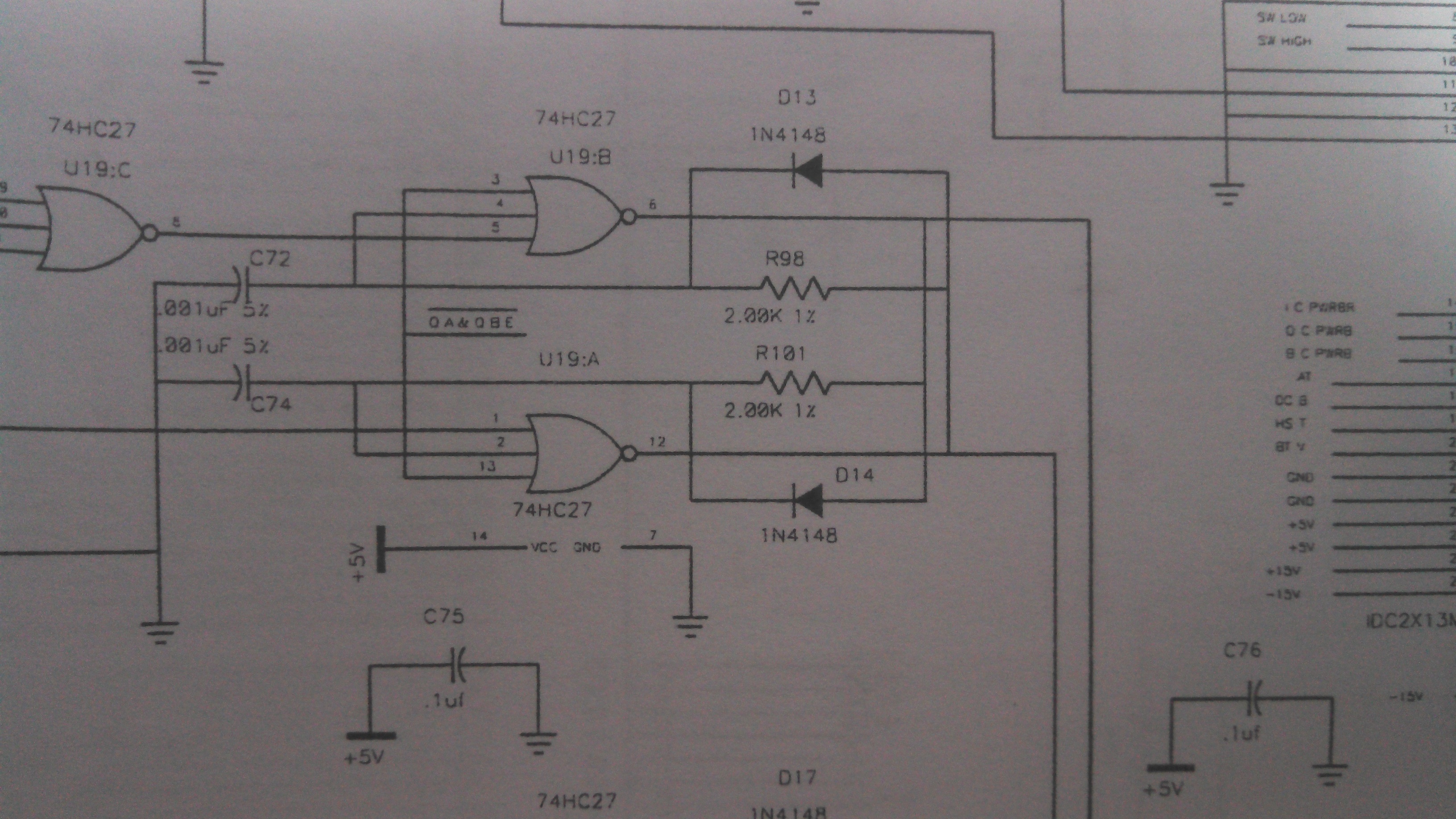

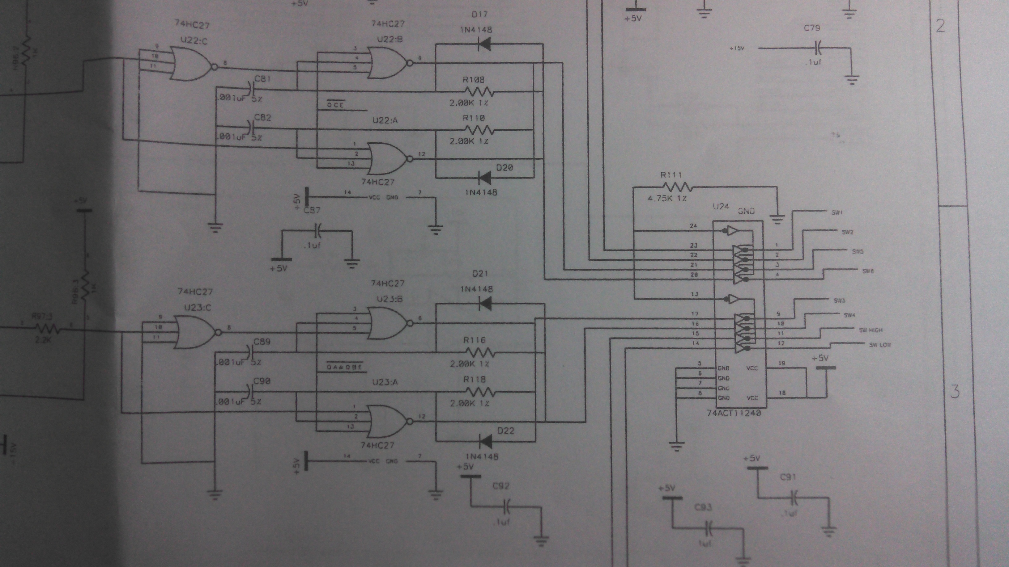

What does the Diodes do? The Nor gates have these Diodes for what?

1.) The Diodes are for when the NOR gate is in the OFF state
When the NOR gate is in the ON state is a time constants from the capacitor and resistor and when the OFF state is doesn't go through the resistor, is goes through the diode
2.) The Diodes protect it from creating a short circuit since the NOR gates are connected in Parallel

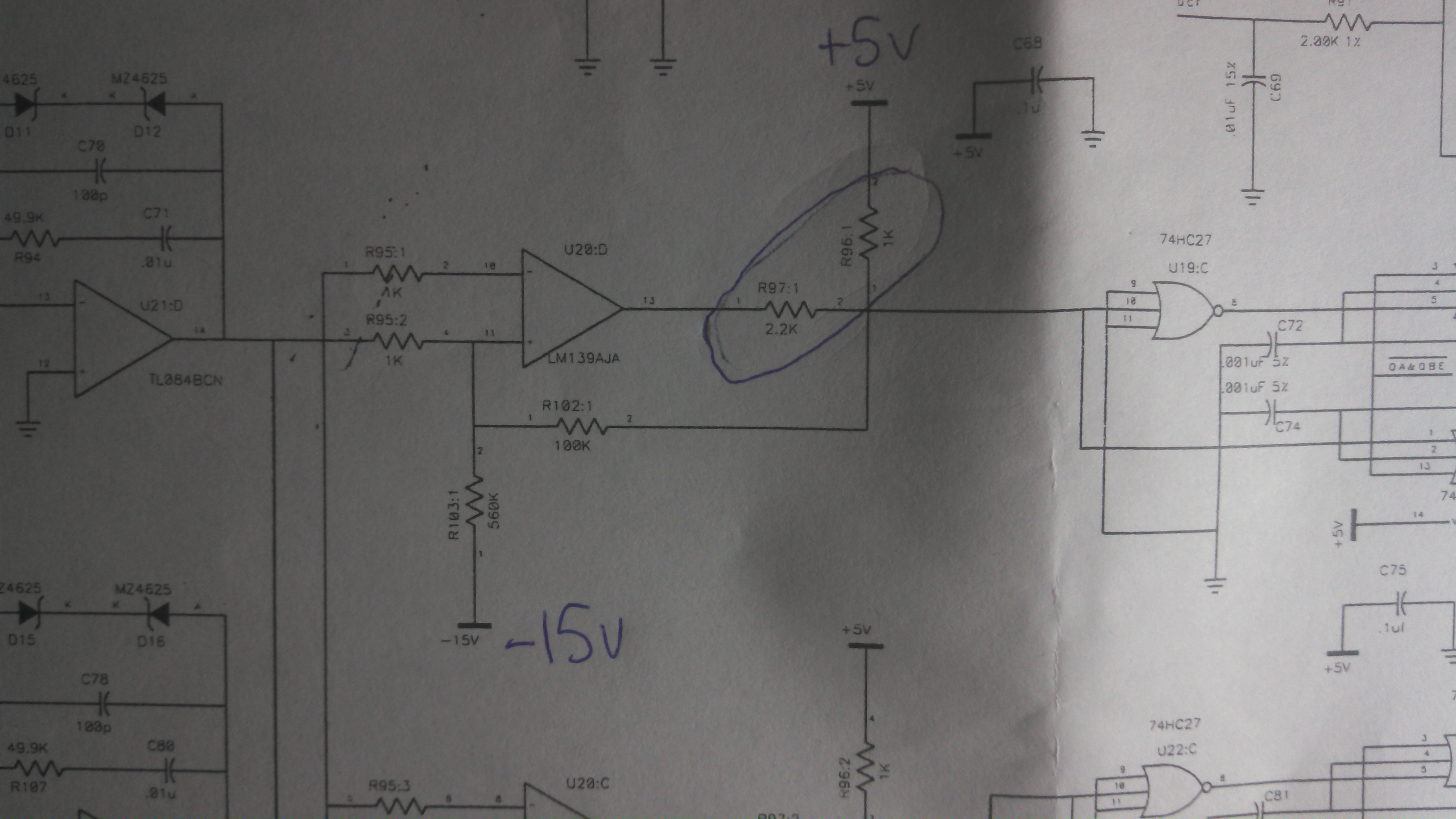

This is a comparator op-amp
When a Logic HIGH is on the input , the output is a LOW
When a logic LOW is on the input, the output is a HIGH
The Diode is to set the hysteresis
I'm not sure when they didn't use a Schmitt invertor instead
I guess the diode sets up a DC offset voltage?

I posted the wrong pictures he is the right one
What do the 2 resistors do? the ones I circled, I see these a lot in logic circuits, It's not just a voltage divider, its like it's pull up the logic signal to a reference zero
Does the 2 resistors level shift the logic signal?
Does the 2 resistor Clamp the Logic signal to clip at a certain voltage?
Why is the VCC +5 and the VDD - 15 volts? why not -5 volts or zero volts, why -15 volts?
Click here:
Your schematics are useless because they do not have a DOT where a wire joins another wire.
Yes true, The Designer at my work didn't put in the junction nodes
But What can you make out of it from my questions please would help me out a lot
I'll bet that +5 is a common logic level and a Vdd of -15 is available.
Op amps have LOTS of trouble with voltages at their supply rails. Only recent OP amps are doing a good job at it. Older OP amps/comparators can only swing within say 1.2 V of a power supply rail.
