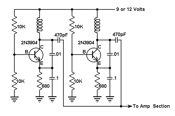

METAL DETECTOR HELP easytreasure

IT IS ALL ON A PROTO BREAD BORD I CHECK ALL THE PARTS ARE RIGHT ASK ME WHAT YOU NEED TO SHOW WERE I FAILED I MADE TWO COILS THE SAME TO TEST IT BUT NO CHEEPING IT WILL MAKE NOIES WHEN I PULG IN THE COILS BUT THEN STOPS

You can start by not typing in all capital letters. It sounds like you're yelling and it gets very annoying. Please fix your capitalization.
I am sorry, but there is not much that I can say about that circuit which will be very encouraging to you.
The correct operation requires two oscillators to be running at (nearly) the same frequency.
There are no adjustments built in to the design to allow this to happen.
The frequency of the oscillators will depend very much on the actual values of the components, and the normal tolerance of the components will be about 5 to 10 percent, enough to set the oscillators so far apart in frequency that you will not hear them beating together.
The audio stages which feed the loudspeaker are a very good example of how NOT to design audio amplifiers.
The results you get will be very dependant on the exact characteristics of the transistors and the ambient temperature.
I visited the website which you give the link for, and saw how he was slagging off others for copying his design.
If I had designed this circuit, I would keep very quiet about it. Really!
I also visited http://www.easytreasure.co.uk/bfo.htm today..
I agree that if I designed that....I would rather not talk about it...I learned stuff there though about how not to build a Metal Detector.

Yes it is a CRAPPY CIRCUIT.
But you can TUNE the Frequency by Starting with Two Round Coils.
Than FLATTEN One or the Other Coil as needed. (NOT BOTH.)
Flattening a Round Coil to an OVAL SHAPE will change its Inductance and Frequency of Oscillation.

Unless you have a lot of time on your hands and free parts you would be better off buying one from the toy isle at Walmart.
Measure at the transistor bases.
were with a frequency, conter would i take measurements
I Don't think that circuit will work.
It does not look like Q1 and Q2 are properly Biased.
What Transistors are you using for Q1 and Q2?
I'll Prototype it up later today and see if it works.
When a common-emitter transistor (like the two transistors with the coils) has its base DC shorted to its collector (by the coil) then the transistor does almost nothing.
Yes I think the Coil should go between Supply and Collector.
And one of those .1 Caps should be .01.
LTspice thinks it will (assuming ~ 100uH coils), but it would be interesting if you could confirm with a breadboarded version.
LTspice agrees. Oscillation does occur in the sim, but amplitude is only ~0.7V.
Just because LTspice shows it works, Does NOT mean that it does.
