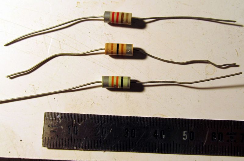

Actual Tests with "Delivan" Chokes, 10% tollerance ones:
220uH Choke
101 Khz.
100uH Choke
162 Khz.
22uH Choke
283 Khz.
Delivan ?

Delivan: A Manufacturer of Small Choke coils.
Not sure if they are still in business, but I have Hundreds of them in Many Values.

The Coils I Used for my TESTS.
