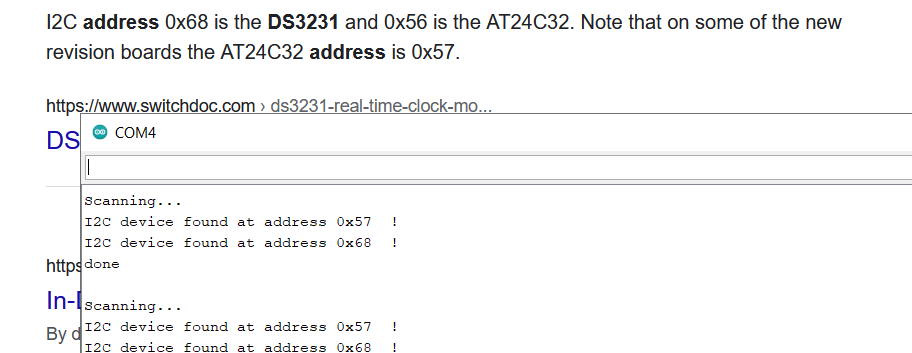

Just scanned ds3231 and it shows two adresses. Why????
Oh there is also eeprom atmel732... :banghead::banghead::banghead:

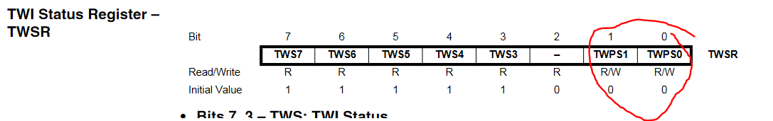

Can i define speed of i2c in one command like this? Syntax is not working.
I need to set those two bits in zero for no prescaler.
atmega 8, CPU speed is 8Mhz
I am probably just messing #define with functions. becouse this function works
void TW_100khz() {TWBR = 32; TWSR &= ~(0x03);}

All I2C eeproms are 7 bit 0x5(x), or 8 bit 0xA(x) + address! 0x57( 0xAE ) is the 8th address ie.. all address lines at high.
Check the max speed of the RTC before you jack it too high..
As you only have four options Try slowest, then bit by bit increase until it fails...

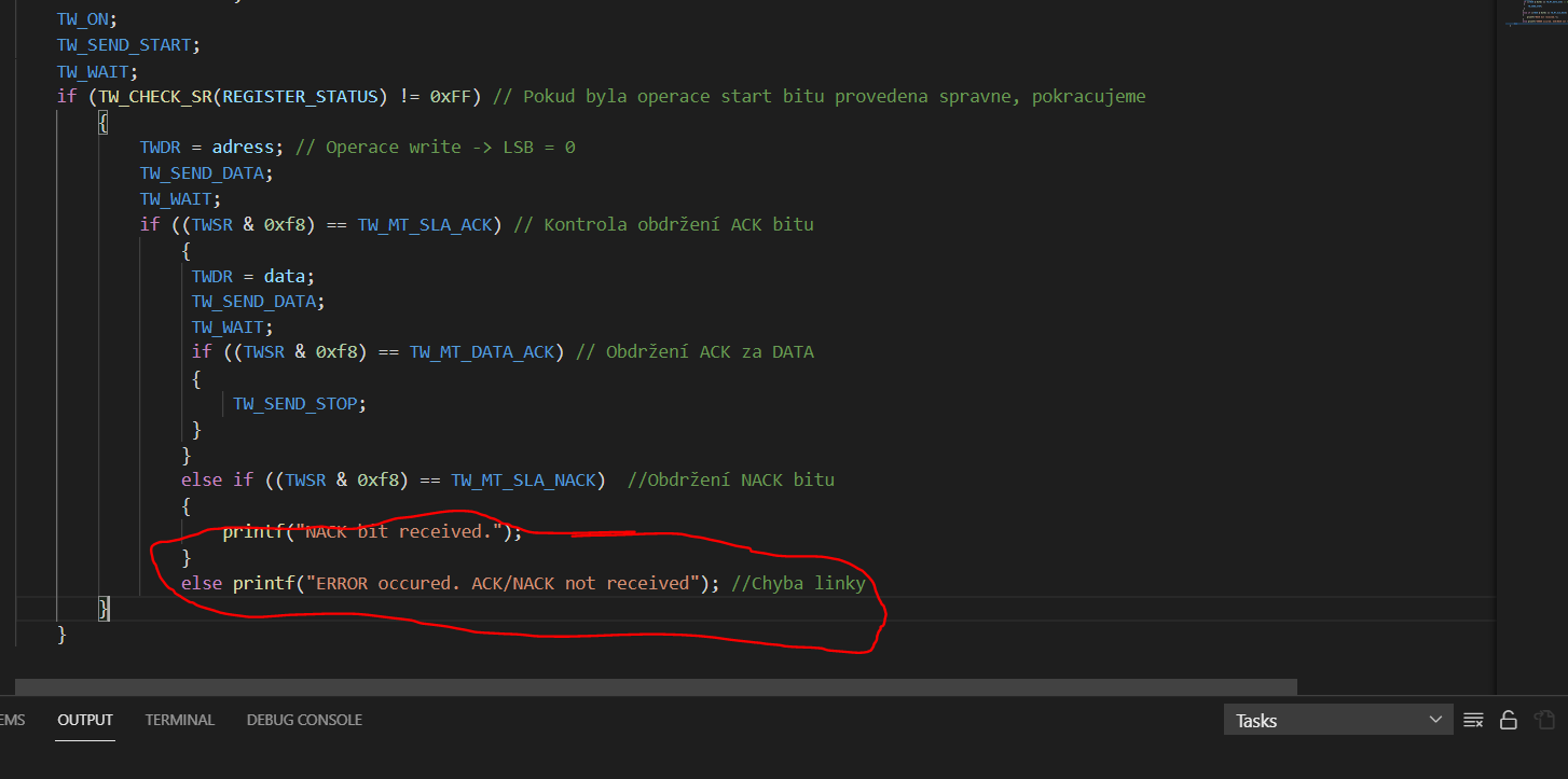

When interfacing i2c should mcu do other tasks? Shall i implement this line of code (bolded, italic, underlined)? Purpose of this is to wait for "job done" bit.

char I2C_SEND_DATA(char adress, char *data, unsigned int data_size)
adress= adress<<1;
TW_ON;
TW_SEND_START;
TW_WAIT;

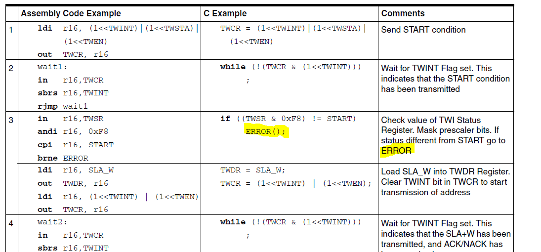

Whats behind Error() function?What should i code here? Should i end i2c here, wait and repeat?
Its code you write to handle a condition that deviates for the main flow of your code.
In table your example callout is to handle a bit thats not a start bit .....? Just a guess on my part.
So you code to handle that exception.
Regards, Dana.

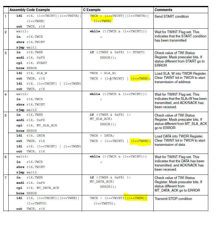

Can someone tell me, why there is need for repeatedly write logic one to TWI Enable register? Thanks

Probably need to study this

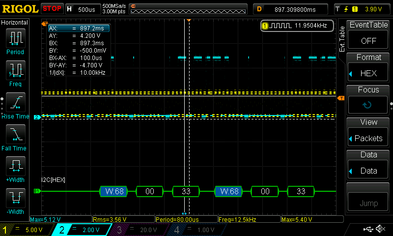

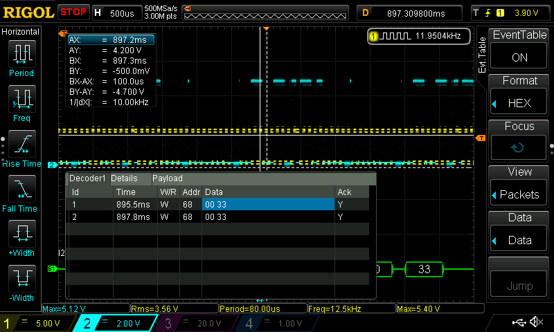

It looks like its working. I though that rigol has better environment. I can see only in event table that ACK bit was received.

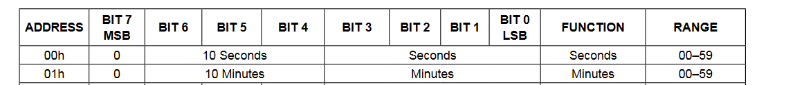

This command should adress ds3231 on slave adress 0x68, and then write 0x33 to 00h register.
0x33 -> 0b0_011_0011 -> 33 seconds

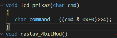

I need to send high nibble becouse of 4bit lcd comunication.
When i am shifting 4 bits right is masking even necessary? Its not like old snake game =)?
You don't need to mask for this shift.

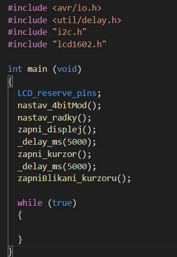

I am just curious how library of util delay know which frequency of cpu i select?
I have plan to substitute _delay by timers
¨View attachment 132335
It depends entirely on the compiler/IDE - usually you define it in the source code somewhere - but I've had instances recently using MPLABX and XC8 on PIC's where it seems to detect it automatically, presumably from the clock setting part of the code?.

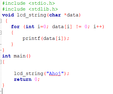

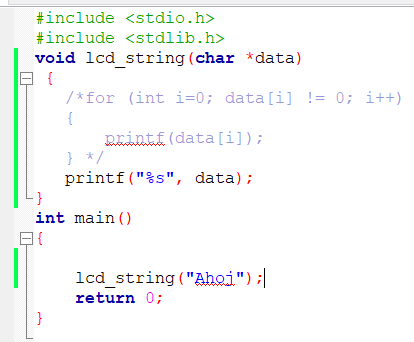

OK, I have written a program for showing a character on the display. I need to learn pointers in C, for char array.
I tried this at C terminal on pc. But it not works.
edit 1 :
Oh nice. This works
edit 2 :
instead of %s there should be %c.... at first picture
