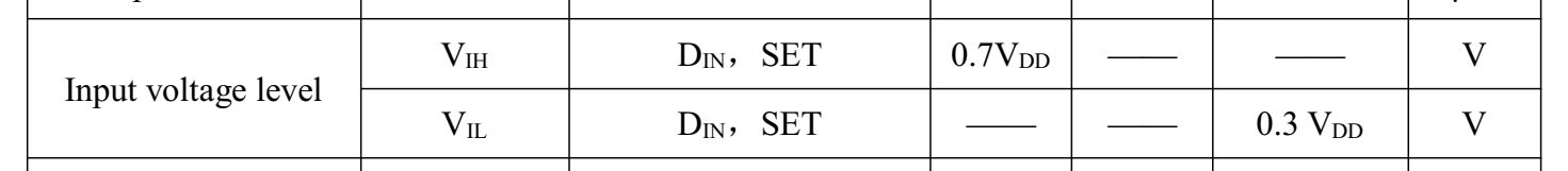

Hello all, this is one of my first electronic schematics and I'm trying to make sure everything looks good (electrically) before I order board and components. Another set of eyes on this to criticize and give constructive feedback would be great and point out any issues or mistakes my circuit may have! I think its easy enough to tell when this is, its a stand alone RGB LED array with its on little MCU. The purpose is to use an Arduino to use as a programmer for the on board ATTiny MCU so it can operate and loop through an animation where the only external connection is to power from a 5v DC supply. I think if anything the MISO MOSI lines are going to have to be revised. Attached are the datasheets for the LED's and the MCU as well as a screen shot of the schematic.

You need decoupling capacitors. The LED datasheet shows 100nF where you've got 22pF. Check the regulator datasheet for the capacitors required for that. And, what are the 56R resistors for?
Edit, those LEDs can take up to 60mA each - that's 960mA - make sure your 5V supply is greater than 1A.
Also, not sure if the LM317 can work with a in to out voltage of 1.7V. You would be better off with a LDO linear fixed 3.3V regulator.
Pommie ah oversite regarding caps, the 56R's are for general current limiting to the LED's, figured it couldn't hurt and it may help keep the LED's cooler than if I was just to hook them up to 5V.
VDD and VSS are backwards.
Also the output voltage of the mcu run at 3.3v is not high enough to meet the input high requirement of the led. It must be 0.7xVDD=0.7x5v=3.5v, and the mcu will only put out 3.3v max

The WS2812B is not 6V but rather VDD +3.5~+5.3 V but 4.5 V min is recommended due to line drop. If using 3.3V then a level shifter or 5V buffer is needed.
I did a bit of digging on WorldSemi's site and found the attached PDF that seems to indicate that the WS2812E which is indicated in the OP's diagram is 3.3V MCU compatible with regard to the Din pin on a 5V supply to the LED - page 10
However, trying to find a proper 'E' version datasheet is a bit elusive.

As for the original circuit, how it is possible to get so many things so wrong on one simple circuit? - he even posted the datasheet which had been completely ignored, it might be in Chinese, but the diagrams are still clear.
Remove the unwanted resistors, replace the caps with 0.1uF, and wire the entire chain in series so they are addressable - plus add a level shifter, or use a 5V processor.
