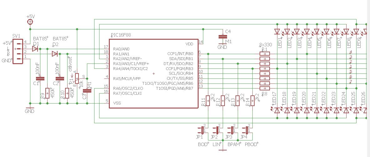

I like to build a VU meter from a PIC micro.Just searched on net & I found couple of projects. Basically I need to show the sound level on 10 to 16 LEDs.
I have some doubts regarding the hardware interface to PIC ADC.The below project used a signal diode and a filter cap feeding to ADC.
My questions are
*If we feed the audio input from a pre amp output it will not scale to 5V ADC because line out voltages has something like 200-300mV. How is he scaling?
*Does one half wave is it enough?
*How often do I have to read ADC?
Presumably by amplifying the signal first?, or attenuating it if it's a speaker signal - although the +ve reference is adjustable with a pot (but you can't vary it down really low).
Yes, it's quite normal on VU meters.
As often as you want, bear in mind you can only see changes up to a certain speed anyway.
ok thanks I understood.
One more question. Isn't that Audio feeding diode (BAT85) drop the 300mV audio signal (Pre Amp Signal).Because diode has a forward voltage drop...!!
Yes it will, that's why they use a BAT85 rather than a IN4148 (0.7V drop).
A germanium diode would be even less, but as you're providing a high enough signal it doesn't matter.
With an active Rectifier ( Operation Amp + Diode ) the Drop Voltage doesnt matter.
When You need a peak signalling You can install a sample an hold cicuit after the Rectifier an connect it to an additional A/D Converter.
The Values can then be shown as a one led Value on the Display.
With an little FET the S/H Stage can be discharged by the Controller.
A long time ago I've seen such a Thing with an LM 3914. The Source is not in my Mind.
The pic might not (unless its very quick) repsond quick enough to the audio peaks, so the meter would probably work better if you implemented a peak picker circuit.
I think thats what Nige was implying further up.

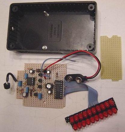

I have an LM3915 circuit showing audio sound levels in my living room. For 14 years it has shown peak sound levels and when they are loud it shifts down 20dB to show the loud levels. Therefore it is very sensitive to low sound levels. Its peak detector circuit responds very fast but holds the peak levels for a moment so you can see them. I have a rechargeable 9V battery in it that I use occasionally.

Mine uses a simple peak detector circuit with its peak lasting for about 30ms so it can be seen.
The LM3915 logarithmic level LED driver is not made anymore so I guess a microcontroller must be used today if you want those features.
Or, you could use an LM3916 -
Unlike LM3915 which have 3dB step between voltage levels, the LM3916 have nonlinear steps: -20, -10, -7, -5, -3, -1, 0, +1, +2, +3db, just like old school analog VU meters. I think it is out of production but there are still huge inventories of old-stock at various distributors around the world with surprisingly old date codes.

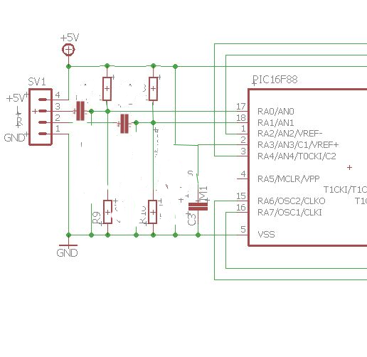

I AC couples the audio. (capacitor) Added two resistors of equal value to set the no signal point at 1/2 supply. Set VREFF+ to supply. This way I can measure both the + and - levels.
Software: Absolute value function causes a full wave rectification. Then I make "dsp" type filters with rise and fall times that are adjustable. (fall time =300mS)
I can not remember but I think the peak filter has a rise time of less than 1mS and a fall time of 2S.
The sampling rate needs to be very fast. I found that if you miss some of the audio the LEDs display is OK.
