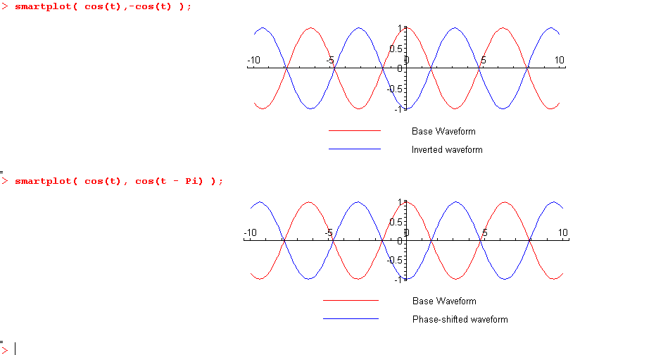

Walters I think you are really getting confused abt phase here
PHase is a shift in time.
The 180deg phase-shift you are talking abt is due to swapping pickup terminals over (+VE to -VE). Now yes this does result in a 180deg phase-shift for a sinewave (kind of) BUT it isnt really it is just an inversion
Why I here you say? Well there is no timeshift in swapping terminals over is there?
A 180deg phaseshift on a PURE SINEWAVE is indistiguashable from an inversion. However for an arbitary waveform an inversion most definitly is NOT a 180deg phase-shift.
Yes soundwave do repeat (and are complex in shape) so this inversion ~ phase-shift can be viewed as valid BUT it is not a true phase-shift since no time-delay has occured

Have a look at my picture, can you tell the difference, there is a difference but can you tell?
DO u have a pictures of the difference of a inversions VS 180 degrees?
If a Inversion is not Time degrees then what is a magnetic inversion?
Thanks alot for the pictures
From the pictures the magnetic inversion looks the same as the phase degrees whats the difference please?
It seems that the inversion is a "Polarity" not phase but polarity were the phase is a frequency based on phase degrees
