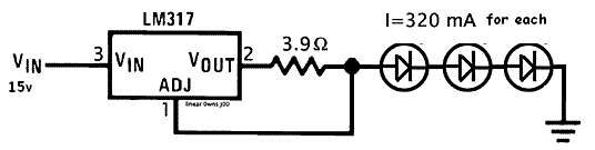

so lm317 seems best idea.i made a sample diagram to connect 3 Luxeons using LM317.pls have a look.
(considering the LED forward voltage is 3.8v and 3v for LM317)
thanks

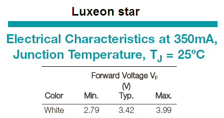

I don't know how you determined the forward voltage of your LEDs as 3.8V unless you measured them. I don't know which colour you have but the datasheet spec's a forward voltage range for white as from 2.79V to 3.99V at 350mA when cool. the voltage at 320mA and when warm will be a little less.
If your LEDs are actually 3.8V or less then your circuit looks fine but the input of the LM317 should have a 0.1uf ceramic disc capacitor to ground.

so i hope 15v at the input of LM317 along with a 3.9Ohms resistor will drive my 3 LEd's in series with out any damage.
is there any for formula to calculate the power dissipation of resistor(i found only 1/4watt resistor.so is this gona work? )
The current from the LM317 is 1.25V/3.9 ohms= 320.5mA so the 350ma rated LEDs will be fine if their heatsink is big enough.
The power in the 3.9 ohm resistor is 321mA x 321mA x 3.9 ohms= 401mW so a 1/4W resistor will fry and a 1/2W resistor will get pretty hot.
The LM317 will also get pretty hot and will need a heatsink.
Here is the 1W Luxeon datasheet:

Here is the hot set-up for driving your 1 watt LEDS. This can drive from 1 to 5 series connected 1 watt LEDs if you provide the stated source voltage.
Lefty
