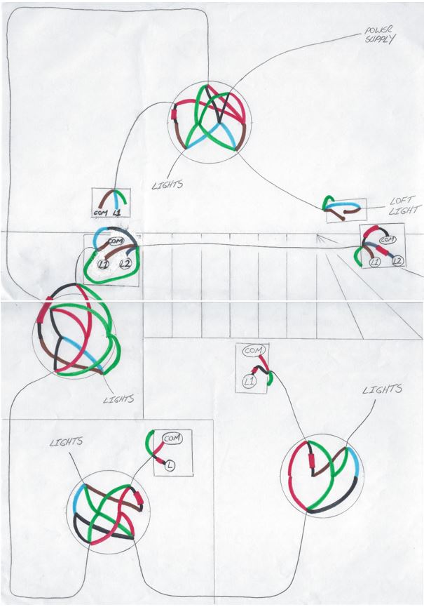

Luceco colour changing LED downlights have 3 colour settings, controlled by switching the light on and off quickly to change the light colour. They are designed to keep the set colour in each individual room. 13 Luceco colour changing LED downlights have been installed as per the diagram. The light colours are not holding their set colours after the colours in other rooms are changed. Can you spot any errors in the circuit?
