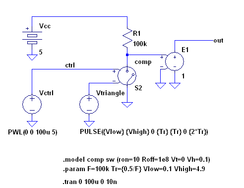

Using spice I need to control the duty cycle of a PWM source at a fixed frequency from 0 to 100% with a scaleable voltage source, can anyone help with the ideal components and layout required?
OK, If I understand you correctly, this should work. I put in a ramp for the control signal to test it. You can change the frequency of the triangle wave by changing parameter "F". The comparator is the SW element, along with the 100k resistor.
Below is the .ASC file. Copy and paste it into Notepad and save it to the SWCADIII directory (or wherever you put your sim files) as PWM.asc (or whatever.asc). You will have to open the program AFTER you save the file.

TEXT -56 528 Left 0 !.model comp sw (ron=10 Roff=1e8 Vt=0 Vh=0.1)
TEXT -56 560 Left 0 !.param F=100k Tr={0.5/F} Vlow=0.1 Vhigh=4.9
TEXT -58 604 Left 0 !.tran 0 100u 0 10n
Hope it works for you!

Exactly what I was looking for, thanks tonnes Ron.

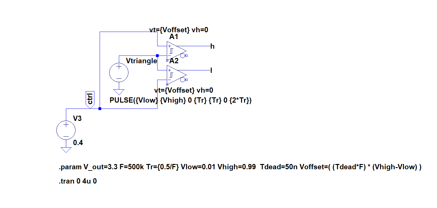

Nice work. I did some simplification, now uses only 3 components - added bonus: better rise times.
  • pwm_generator.asc
