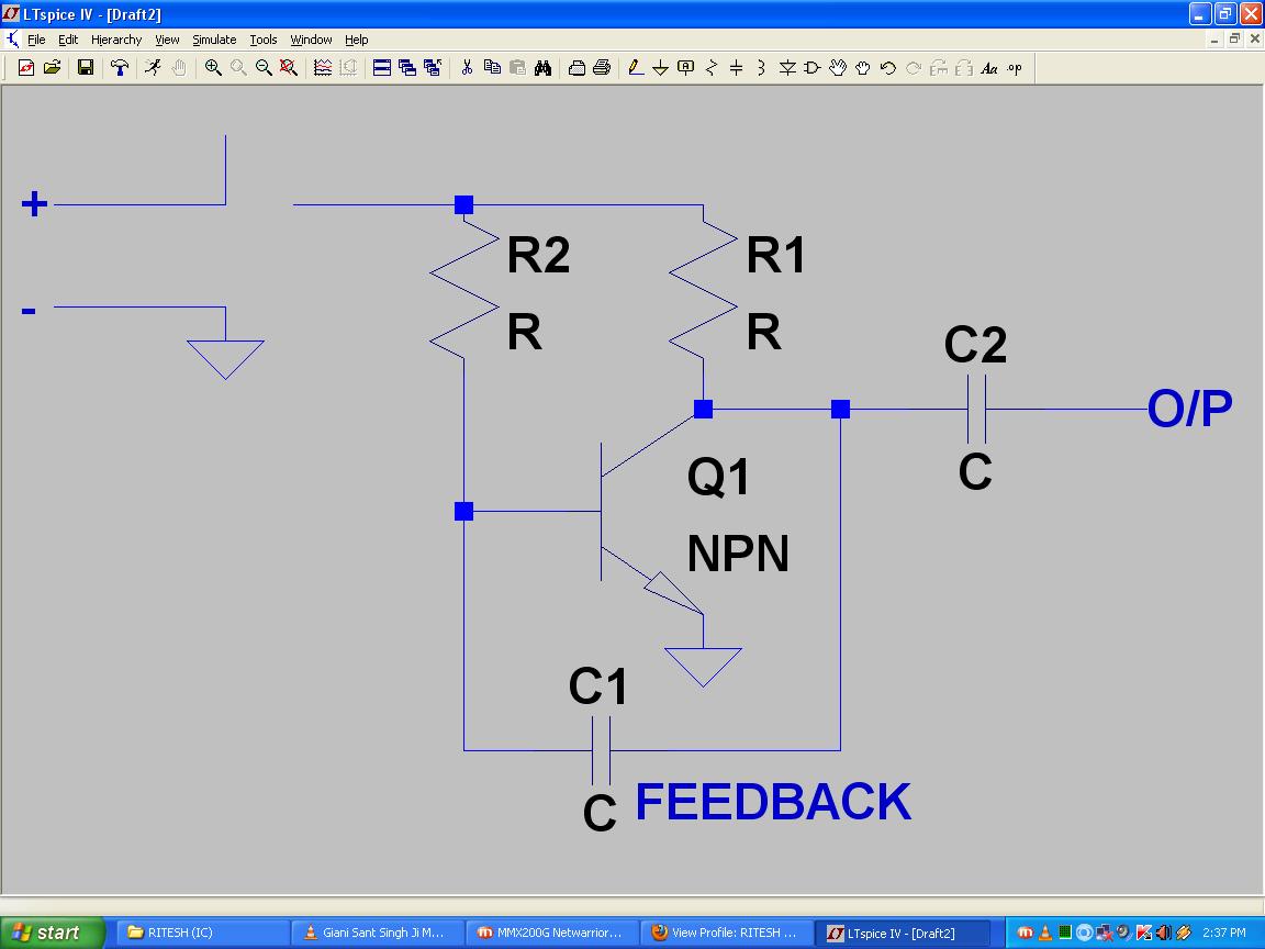

I find this circuit in my old electronics book, it is oscillator.

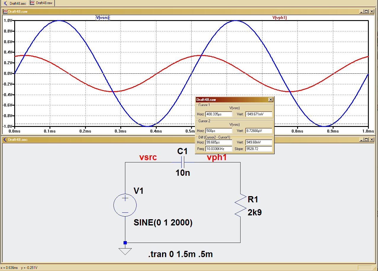

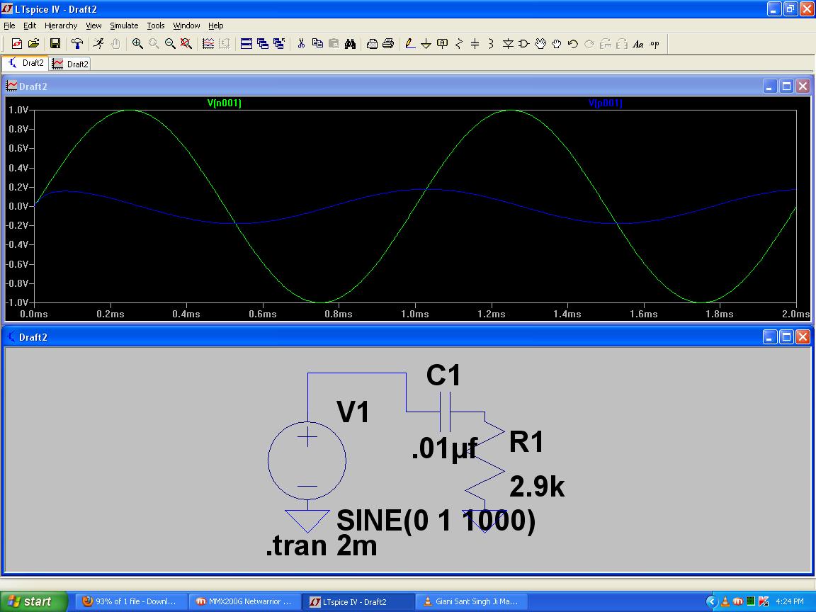

In this waveform how to find angle of shift??
Its a start, but its incomplete.!
Place name labels on the signal point on the circuit, so that plots can be identified.
So thats a plot of Vs in and Vout...
It is designed by sombody who knows nothing about electronics because it is not an oscillator. An oscillator has positive feedeback. This transistor does not have positive feedback, instead it has negative feedback at high frequencies.
Also the transistor is poorly biased by only one resistor from the positive supply so it is turned on all the time.
I guess the low level is the output because a highpass filter attenuates the signal. The frequency is too low at 1kHz so the attenuation is high and the phase-shift appears to be almost 90 degrees. The phase-shift will be 60 degrees and the attenuation will be less at a higher frequency.
How to find exact angle??
Use the two cursors on the plot is one way.
This shows a 2kHz sine wave, note its not exactly 60degs shifted, you figure out that part.
Use the phase shift formula I posted yesterday.!!!
The *.ASC file is attached.

180 degrees is half-way around.
90 degrees is a right angle.
60 degrees is 1/3rd of half way around.
Simply design a phase-shift oscillator the has three RC filters that have exactly the same R and C values. Then each RC filter produces a phase-shift of 60 degrees. It is easy if you use an amplifier with a high input impedance like a darlington transistor or two opamps.

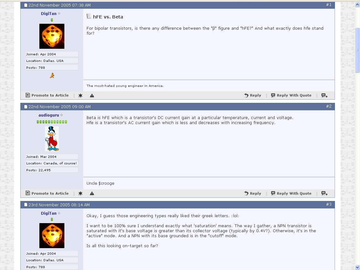

HI ,AG i have seen your many post but don't get, how to get beta for any transistor??
